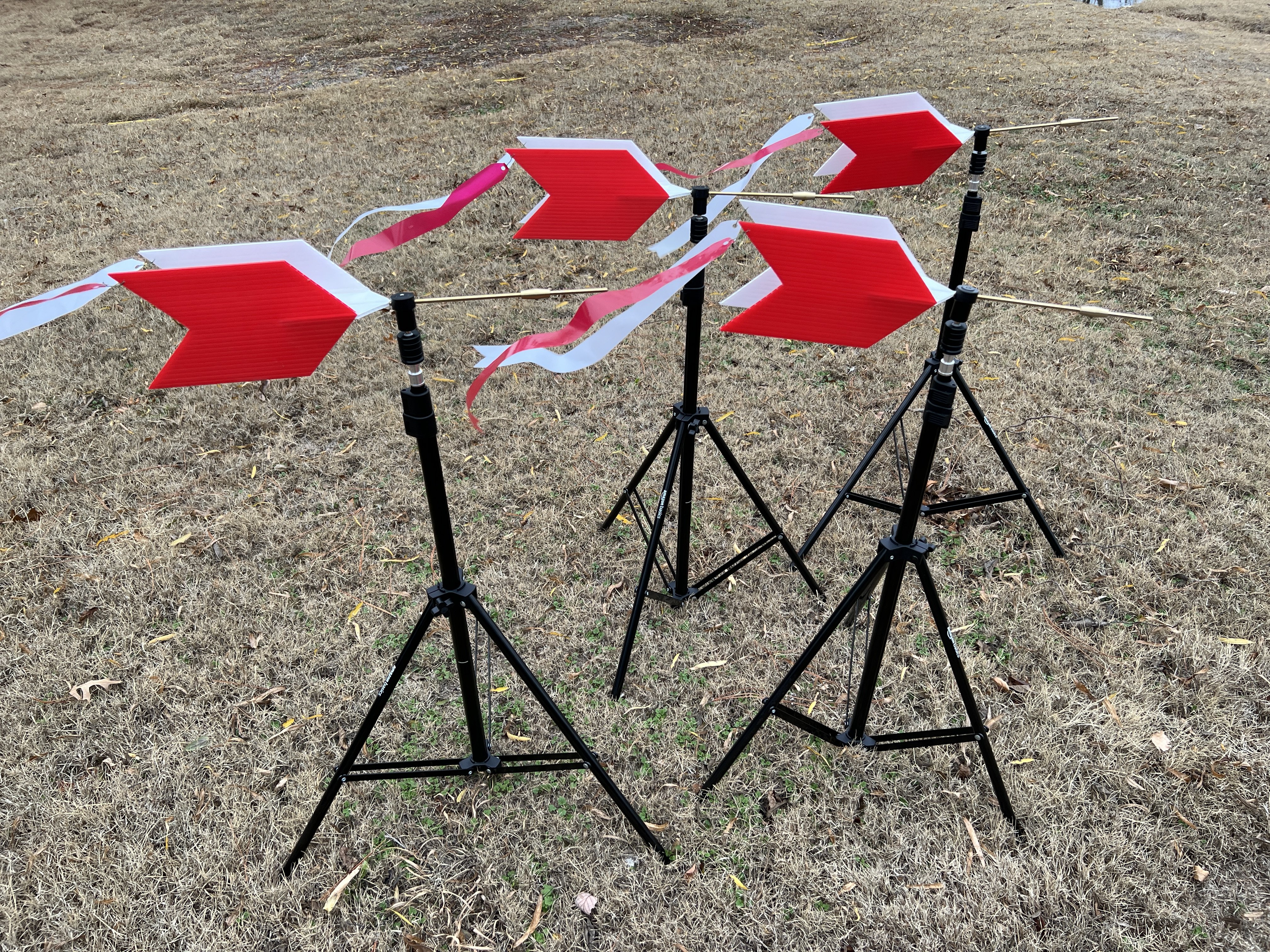

Well I am back with another question. I am loving the new wicks flags I got from Ray Hill. They are leaps and bounds better than what I was using or trying to create. But now I am looking a Front rests for bench. I see that several top shooters have either a big front rest mechanism or some have special bipod with a 2-3 foot stance and some with just plain bipod. What are the benefits or disadvantages? What do y’all recommend? Educate me please. I seen something online that SEB sells a Neo-x for $1,700 but one would not be ready for 7-12 months and that just seams crazy high for one. I appreciate the help ladies and gentlemen. Here is a pic of my new Ray Hill flags.

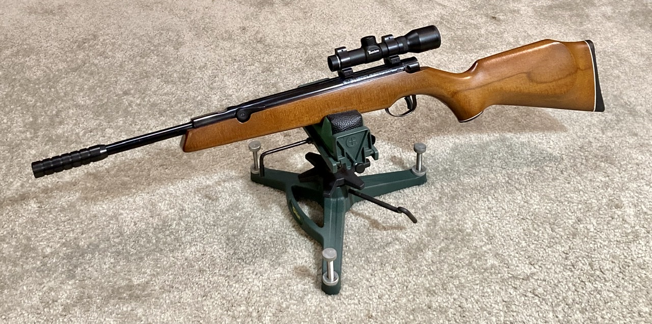

I am NOT a high-end target shooter of any kind - so may be missing the (metaphorical) target - but I love this fairly basic Caldwell "The Rock" for sighting in, etc.
It's heavy enough to be steady (mostly cast iron), small enough to be easily portable, and reasonably priced (around $100 new). There's a good amount of lockable vertical travel, the feet adjust to sit level on any surface, and the head can be easily tweaked to take about any kind of bag.
