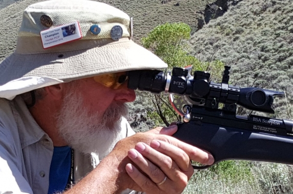

Used one now for a couple seasons in PFT
Will make note they really don't range find super well, but work out within PFT ranges of 10-35 yards. The Zero eye relief is whats key being rules allow eye cup contact to your face & there eye cup is an adjustable solid piece you can rest on your brow bone. Wink wink
