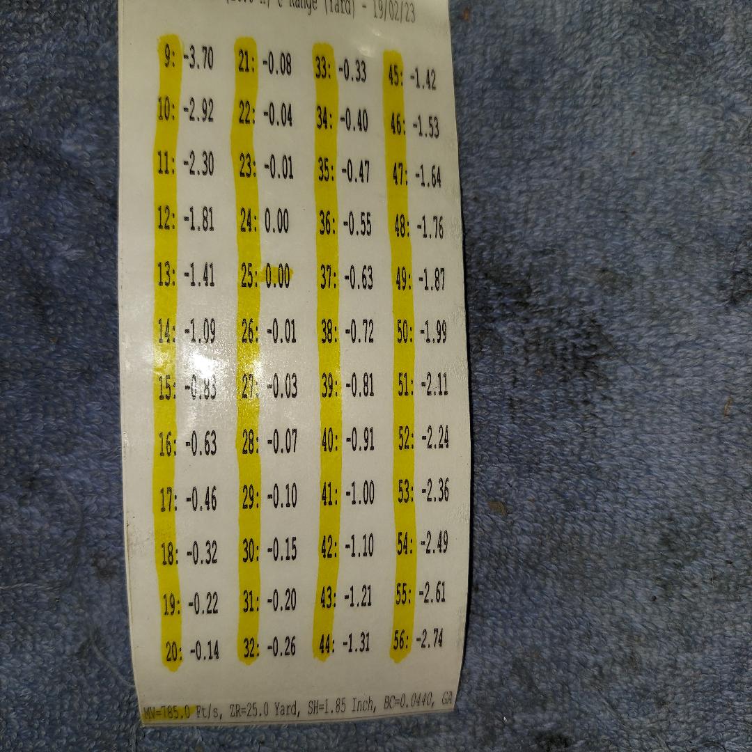

Shown is a D.O.P.E. card made up via Chairgun. It is IMPORTANT to use a very small PBR / ZERO range. * If you have your PBR at .3 so will be the entire data +/- be .15 at all distances & will give you possible splits ........ I use .100" ZR which is +/- .050" AND ONLY ONE Zero range, NOT two !!
Make note that the hold over data is to the 100th .. it can be rounded to the nearest 10th ( All one can hold anyways ) as in a .73 being .7 or a .78 being shot at .8 etc ...
Understand garbage Kinda close data in, results in garbage kinda close at target results .. You Can Do better ;)

It's been a while since I shot hold over, but Motorhead's level of precision is difficult for me to attain with my current "hunter" scopes. What I used to do for anything further than 25 yards is calculate to the nearest half of a mil, and mark an H or L to tell me to hold high or low. So -1.3 mil would be -1 H. -1.4 mil would be 1.5 L. Anything 25 yards or closer, I would try for .25 mil data, since that is the limit of 1/2 kill zones and it's easier to get that level of precision under 25 yards.

Do take notice that inside my zero distance ( 25y ) the holdover to @ 20y only changes a little, but 19y to 10y you better be paying attention and holding correctly to avoid 12 & 6 o'clock splits.
Also take note from @35y on out EACH YARD further picks up about a 1/10 mil in required hold over. Here again rounding out to the nearest 1/2 mil hold point is not going to cut it or support much confidence when targets are not falling ;)

Motorhead how do transfer your written dope to your visual reticle field? Isn’t there a smiggin of guess work? I start with StrelokPro then verify each shot at every yard from 10 to 55 yards - zero range not so much.
The printed out D.O.P.E. values are held "In the Moment" and use no superimposed hold / reticle picture.
Range it, think about if parallax snapped in or not ?, Size up the wind situation .... Resolve a POA and just shoot it.
STEADY is key and the biggest struggle ANY FT shooter has too get a handle on pending class & aids afforded :cautious:
