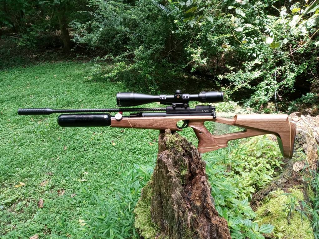

Excellent suggestions, but another consideration might be a modified Crosman 1720? Pretty easy to get them to 12 fpe, and not impossible to get the power close to 18 fpe.
Her's a pic of a bottled 1720 I'm planning on competing with this coming season, could give you some ideas, if you like to tinker and mod.

Now you got me thinking.. did not even consider a 1720. I have a spare 1701 and all the parts too for a bottle build. This might just end up being a highly supervised 5th grade science/engineering homeschool project. 🤔
Do this! Sounds like an excellent time with family start to finish and SO many lessons taught/learned and the personal satisfaction not to mention should be an excellent rig to use.

If you do go down that path and want to achieve more than 12 fpe,, I would highly suggest you acquire a Benjamin Maximus internal valve spring and use it to replace the stock 1720 valve spring. It will allow a lower reg point and make it much easier to up the power.
ALSO - the 1720 has a LW barrel, but if you desire more barrel length, 22XX and Discovery barrels are drop in compatible.

Trajectory is confirmed. So the Boss (wife) approved the project, provided I supply all the lesson plans, homework and guidelines for the final project report. I happen to have 3 stocks to choose from that fit a 1701. Magnum Air bottle adapter, a 13cui 3k alum bottle w inline reg, Hill parts and springs and a barrel adapter for an ldc. Going to disassemble completely and start the project from there, documenting and measuring parts, volumes, weight, etc. Study plans on materials used, thread types and pitch, physics, and of course safety. Only thing needed is a longer barrel, not a big deal. Only preliminary work is a short course on airgun history, which happens to tie into Lewis and Clark, a current topic in his History class. I expect this to be a semester project, about 6-8 weeks for completion. The final test will be his first FT match sometime this year. I have no say on the decoration or looks, however and will not grade based on looks. Knowing my kid, there could be some Minecraft stickers on it or a Green Lantern decal on the stock.
