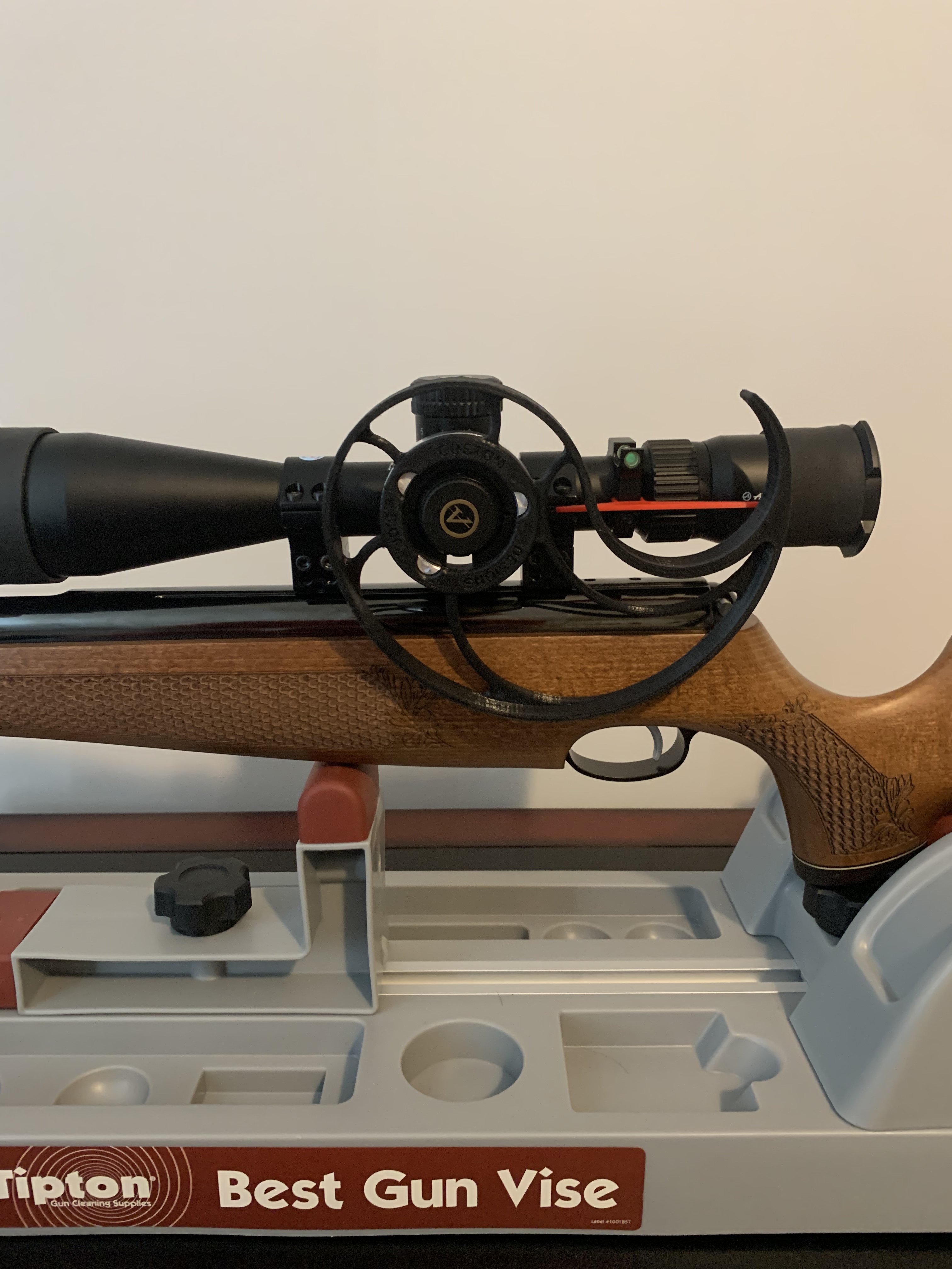

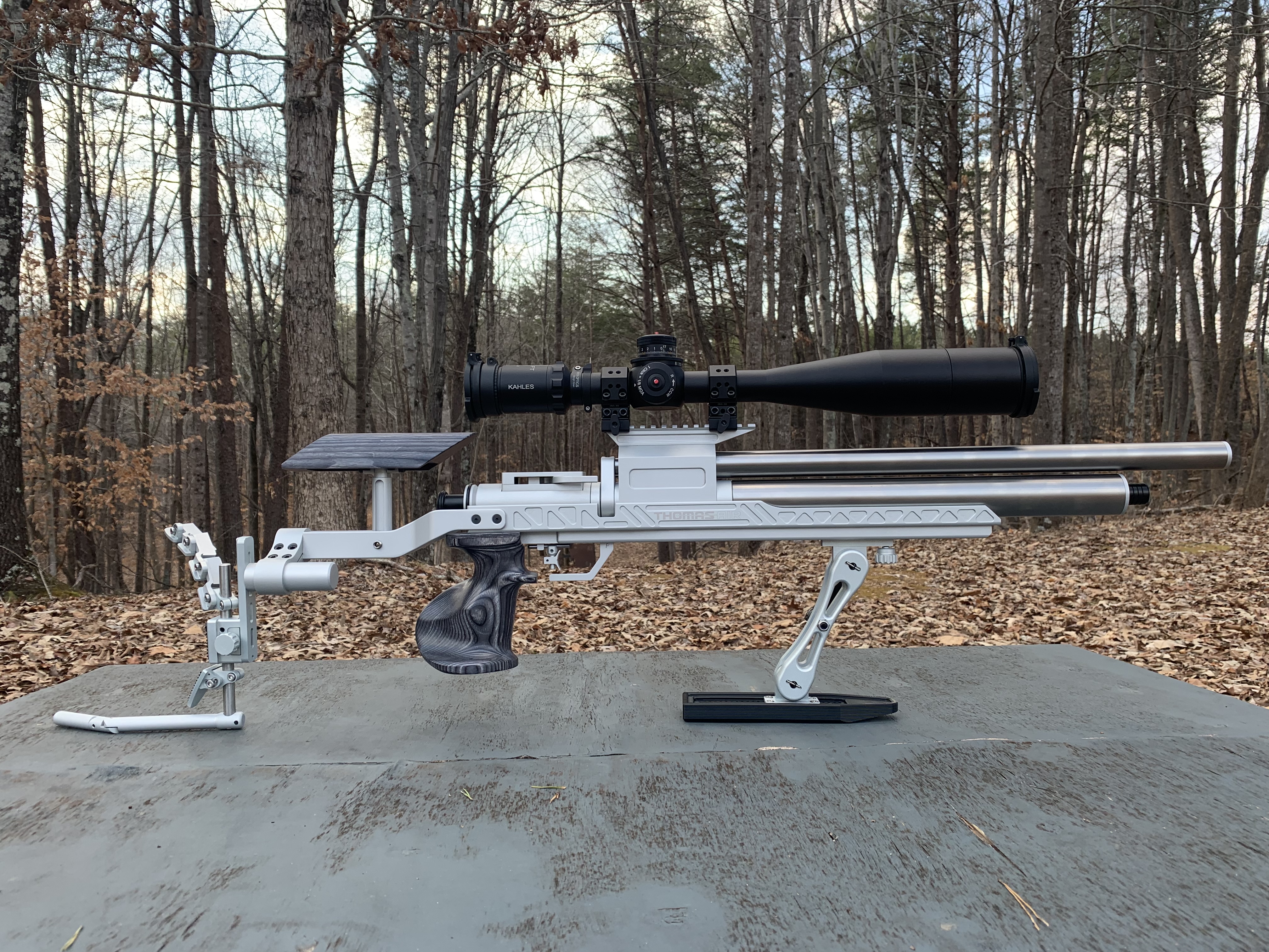

One rifle is my Thomas with a Kahles (easily one of my favorite scopes of all I have used). My eyes love that scope.
My TX200 has an Athlon Helos BTR Gen2 4-20. I really like this scope. I was a little hesitant at first, but it has proved to be really good.
I need some new pics, but here they are. The Thomas has different rings since then.
