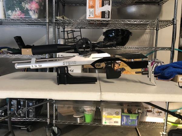

Oh, truth is I will never even try and compete.. just want to have fun with some others. Not to mention this is not in my hands yet so I will test it myself. I am confusing two guns though... this one the comment was stacked at 25 and not tested at 50. Either way, it will be fun. Came really really close to buying a Steyr, which is the one with the 50 yard 1/4 inch comment.. might still buy it just to hang it on a wall.. gorgeous.
1537555995_6972608305ba53e1b51bc12.70790804_55909894502__7C8905CE-3210-46B3-8FC3-E8265D4615D0.jpeg
This one...
