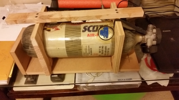

Here is an easy but strong carrier made in the shop. It has a handle for carrying and will either stand up our lay down, My fill shop likes it because the can stand it on the base and it is out of the way. I used scrap to make it. One long piece runs the length. one square piece for the end (foot), two pieces of plywood with holes cut on band saw or sabersaw, and one long narrow top piece as a handle and to secure the mounts. I then put a piece of velcro to keep the tank from sliding out of the carrier. Works fine and adds about 1 lb. All parts are glued and screwed.
