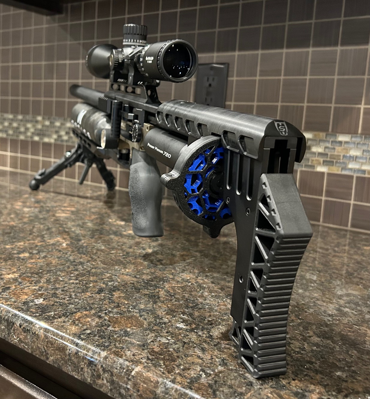

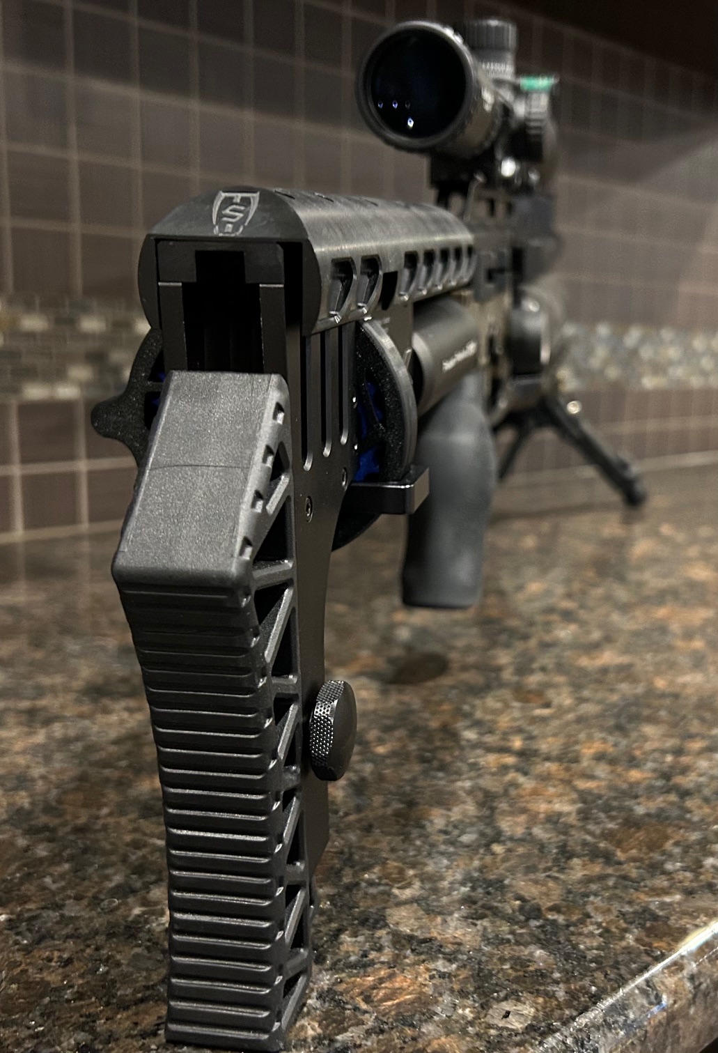

I was finally able to convert my FX Impact to a true left hand gun! The magazine now inserts from the left side thereby solving cheek weld issues with the high capacity magazine.
Bullet central sells the magazine bracket for the conversion. You will also need a special left hand magazine, which Bullet Central also makes and sells, however they never made one in 0.25 caliber. After waiting a year, another AGN member suggested that I reach out to Orion the Iguna Hunter. I asked Orion if he could make one and to my delight he did!!! It’s basically the same Impact magazine he sells on his website but mirrrored for left hand insert. Mag wheel rotation is also reversed of course.
I have to give Orion a special shout-out here. Not only did he make a special part for me, he also didn't charge any extra. He is really a stand up guy and a true asset to our airgun community.

I do prefer the cocking handle on the left side. It allows me cycle a round without moving my non-shooting hand, which is helping anchor the rear.

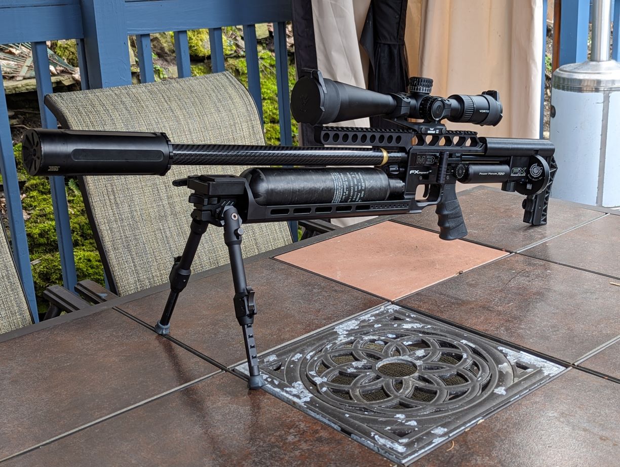

On my old Impact X, and before slugs and high capacity mags, I used low profile mags from CARM, which were awesome.
CARM Low Pro Mag

I'm glad it worked, and from the first attempt, because I did one before but was from an old version of the magazine, I had to redo this from the latest version that have a few improvements.
