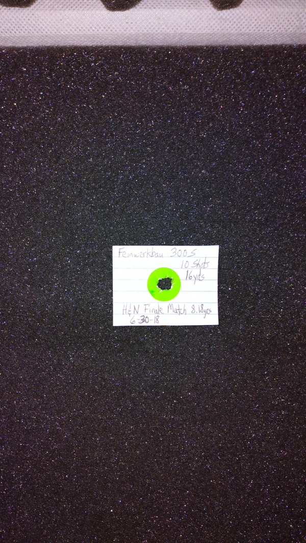

Try some H&N Fnale Match 8.18grs pellets. I mainly shoot at 16yds in the yard at house. But I have found these to seat tighter in the chamber than any other pellet. Nothing beats them for consistency at least at 16yds.

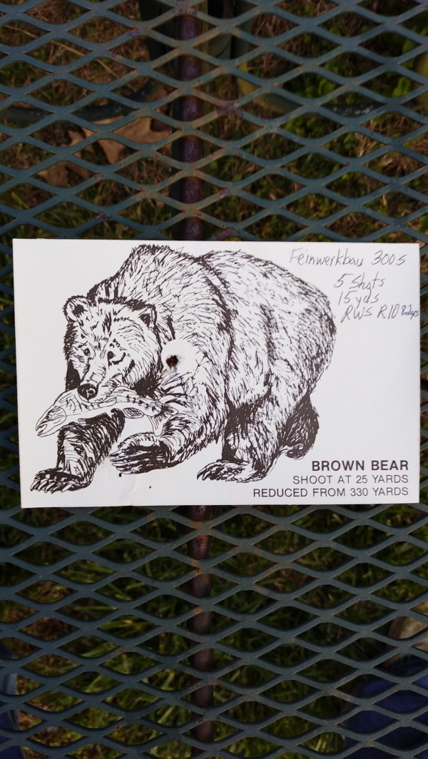

I use RWS R10 and (try not to laugh)cheap Beeman chinese made black coated Hollowpoints for closer distances if I need absolute 0.0" one hole groups.

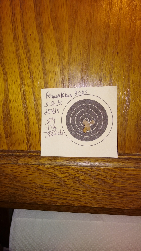

I can't speak for a 600 but my 300's like JSB Exact RS 7.33 best followed closely by AA 7.87's. It shoots JSB Match Diablo S100 8.26 and H&N Finale Match 7.87's well too. These groups show what these rifles can do if the monkey behind them does his part.
The "Queen", FWB 300S , five shots @ 25 yards, AA 7.87, factory diopter sights.
"Ugly Betty", 300S, five shots @ 25 yards, JSB 7.33, factory diopter sights. The white bull is .090".

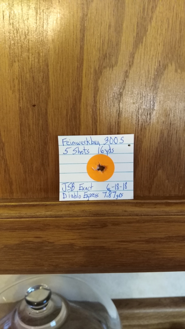

Roger, I measured this group outside to outside at .174 with my caliper and a bright flashlight. It is a pure 1 holer. And it was tape measured from tip of barrel to target at 16yds. I can't see 9 yards making the accuracy diminish a whole lot if you got no wind to shoot in.
Those pellets I will bet will perform at 25yds and farther.
