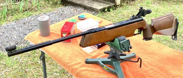

FWB FWB 300 .....anyone else have one?
I have a 300s Mini. Not going to post a pic of my ugly child. No defects or rust-just not pretty like these. But it does shoot. Reminds me of the old song "Never Make a Pretty Woman Your Wife". Advice I ignored 56 years ago :love: I just got back into air rifles and chrony mine yesterday which was placed about 5 yards from the muzzle. The states on the 300s are:
JSB Exact Diabolo, 8.44gr, ave velocity 576 fps, 6.22 fpe, ES 10, SD 2
For comparison my Beeman/WH30 tuned by Paul Watts shooting the same pellets are: ave velocity 580 fps, 6.31 fpe, ES 10, SD 2
The ugly old girl is doing pretty well for her age (y)
In all honesty i don't know what stats are consider "good" for the 300s. I assume the standard size 300s and mini produce the same stats. I assume because the Paul Watts tuned R7 and the 300s are producing practically the same performace the FWB is doing well. I would be interested in stats others have with the 300/s.

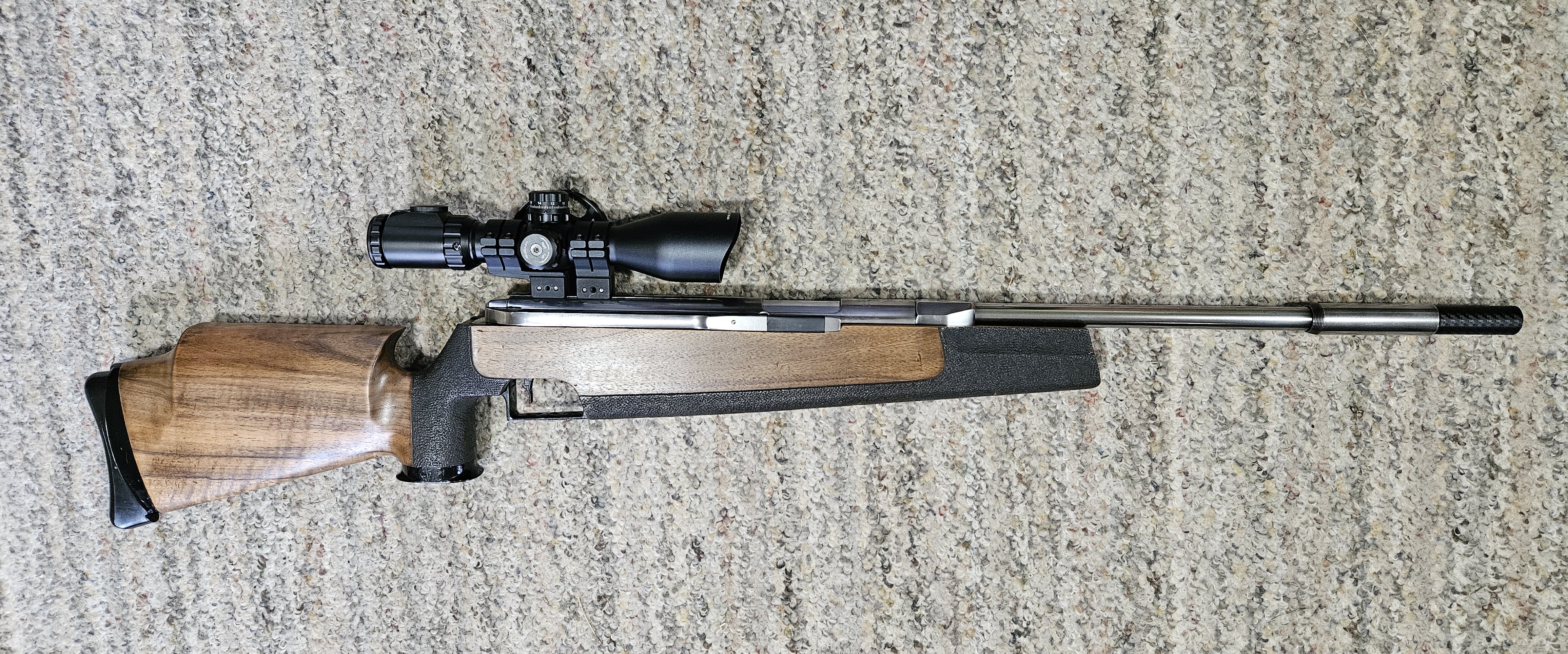

Started as a 300SL club rifle that was purchased for 125ish USD.
Total rebuild using a Macarri Arctic spring in addition to all new FWB internal bits, loves 10.3 JSBs, and is a chipmunk murder machine.

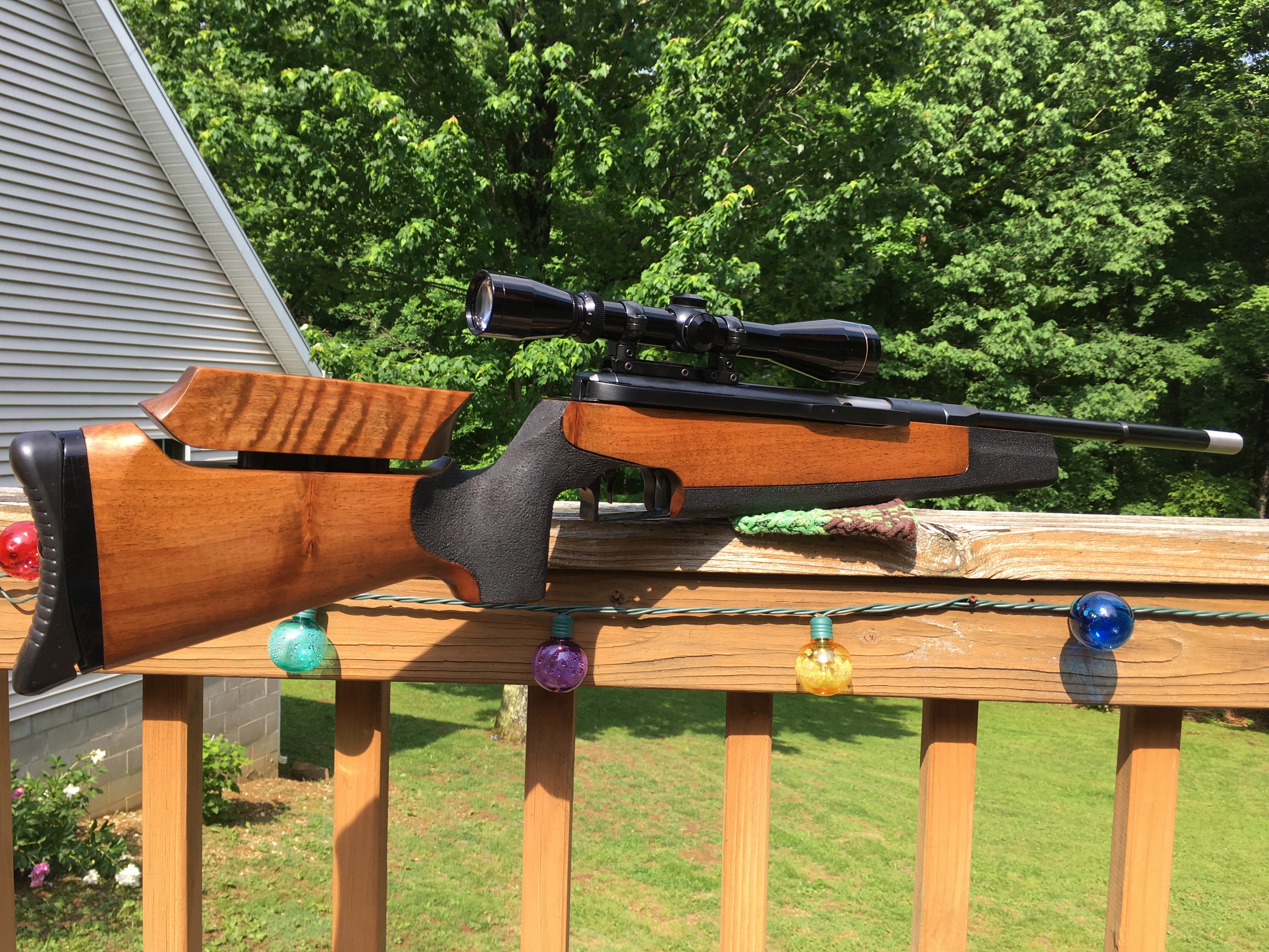

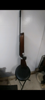

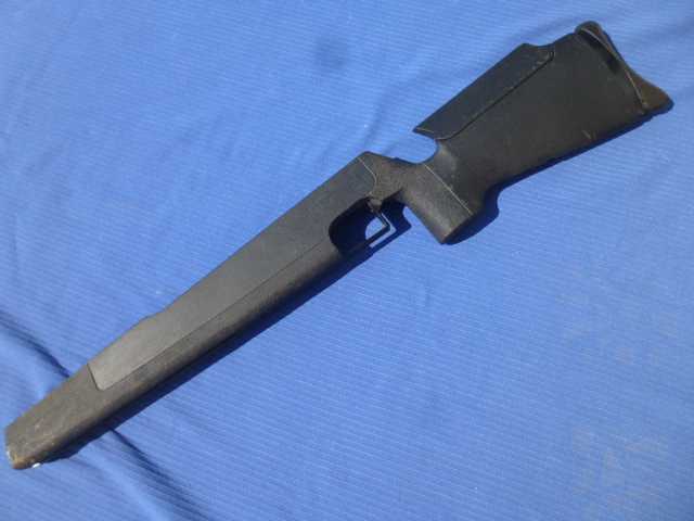

Here's one of my favorite chipmunk snipers. The stock was painted flat black when I got it.
Nice! I like the old club guns.
View attachment 457023View attachment 457022
I wish that I could have scored a universal stock from the big Pilkingtons club rifle sell off, where mine came from, but they were all bog standard Match L models as far as I can remember.
I am debating swapping the standard twin springs back into it, as the Macarri spring does put more stress on the recoil sledge than it was designed for, and parts are not getting any easier to find.
I also looked back through some old paper work, and Pilkingtons sold those FWB 300s off for $120 apiece in 2014...... I wish I had bought a dozen.

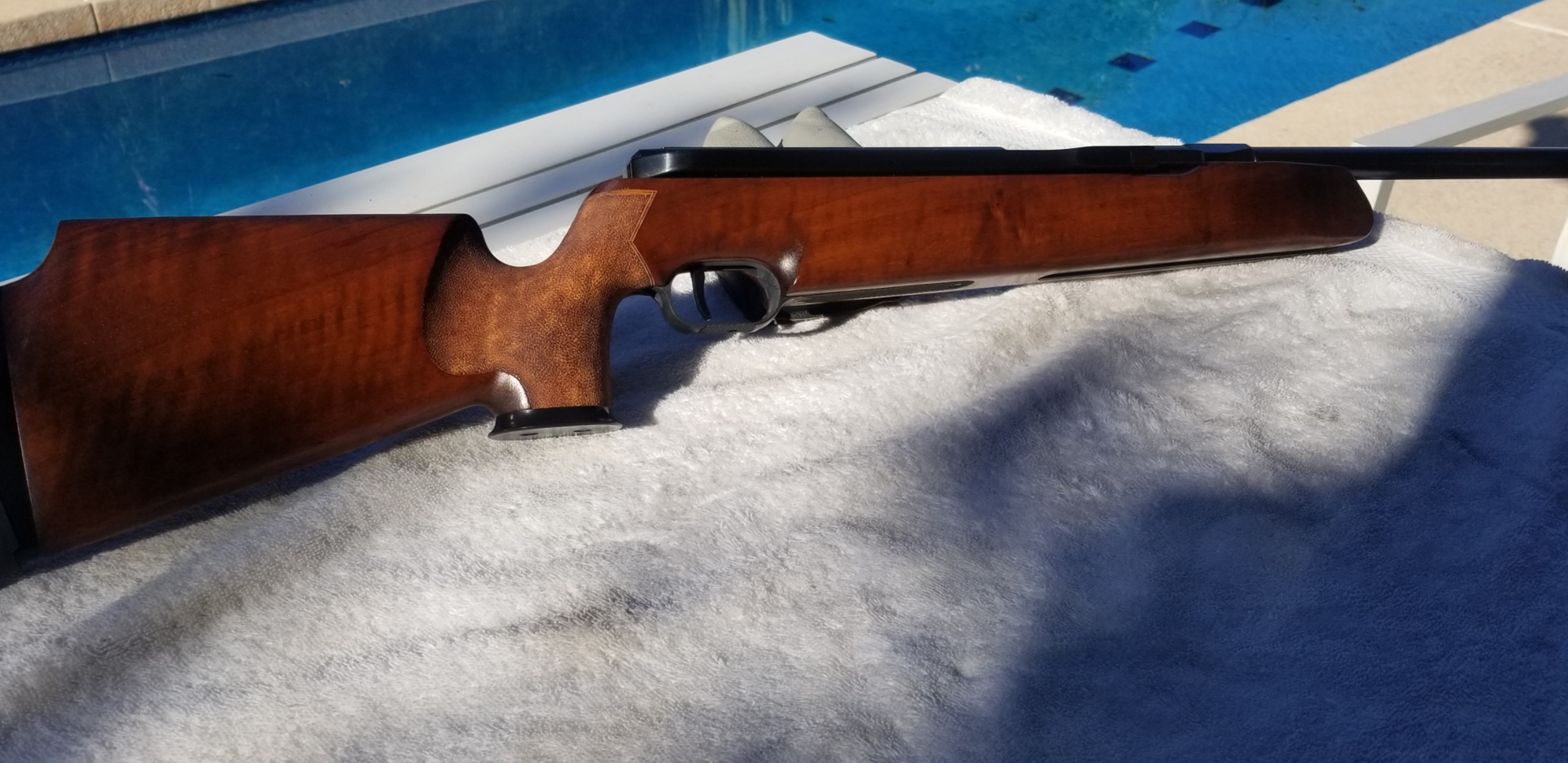

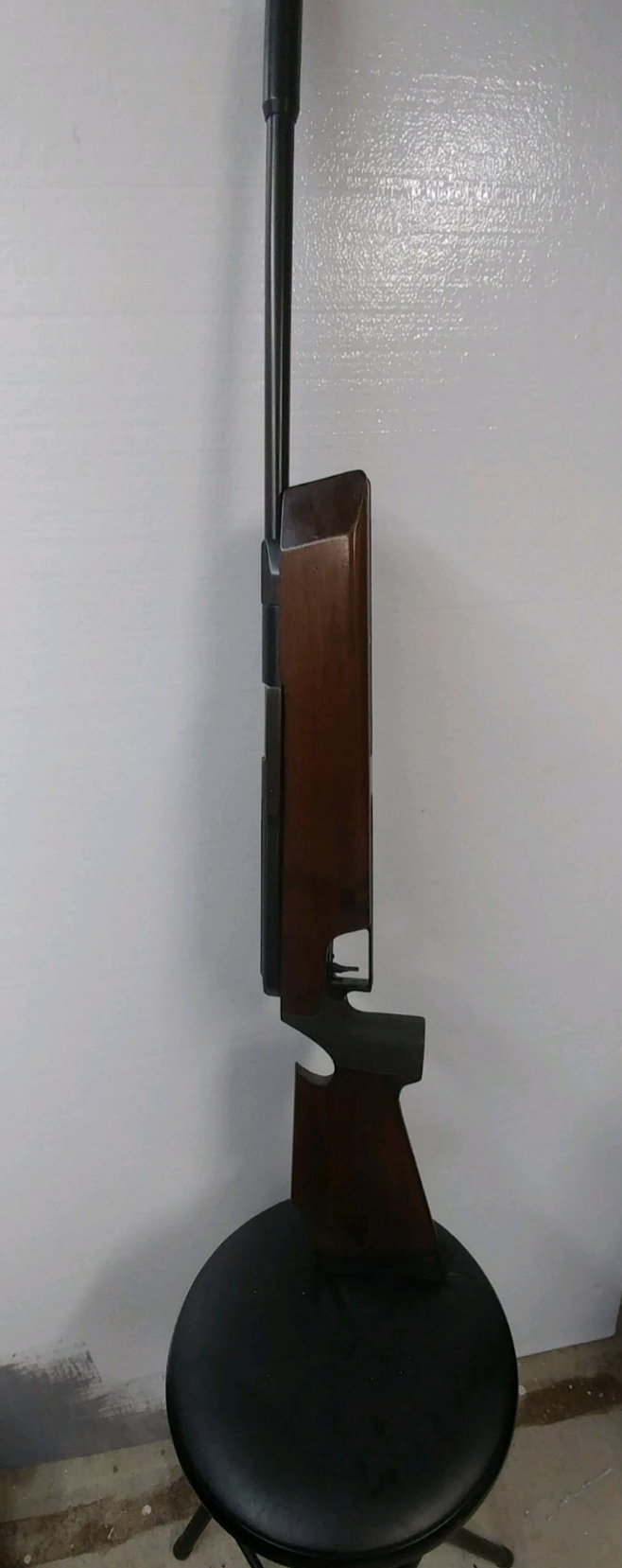

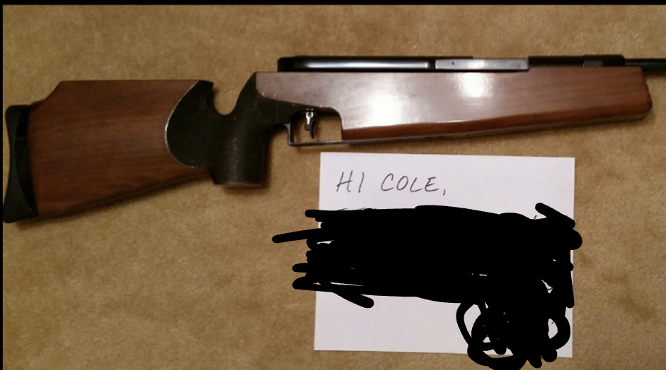

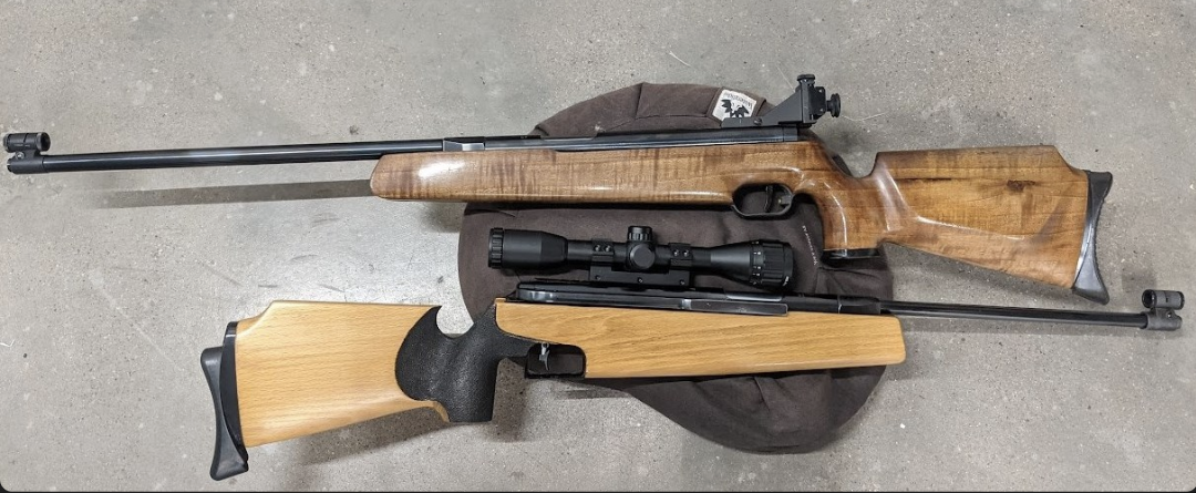

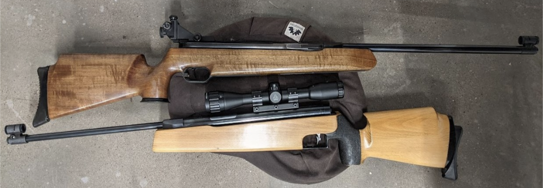

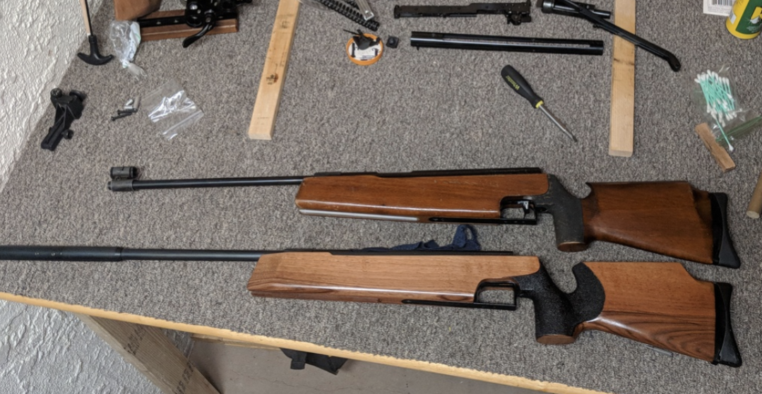

Top is a 300, bottom is a 300s Mini
The 300 is in the exact state I bought it. It appears that somebody refinished the stock at some point. There is evidence of the normal stippling in the grip area but it was mostly sanded out. Seems to be a walnut stock.
The 300s Mini stock was redone by me. It was a rough looking dude when I got it, wasn't hard to envision it getting drug down a road to create the wear patterns on the stock. Between sanding and steaming I got most of em out. Had to restipple the grip area, and then dyed it black. Chose to stick with blond after a couple subpar results from staining other beech stocks. At least I'm pretty sure this one is beech.
Fun little guns. Something about their design and operation makes me feel like I missed out on a simpler time, a time when craftsman took pride in their handiwork.
Well....sort of. More to come later.
Did you use oxalic acid to bleach the Mini stock?...beautiful. Is that maple, does not look like beech?? Reason I ask is because I wonder if a beech stock would bleach out as nicely as your's...

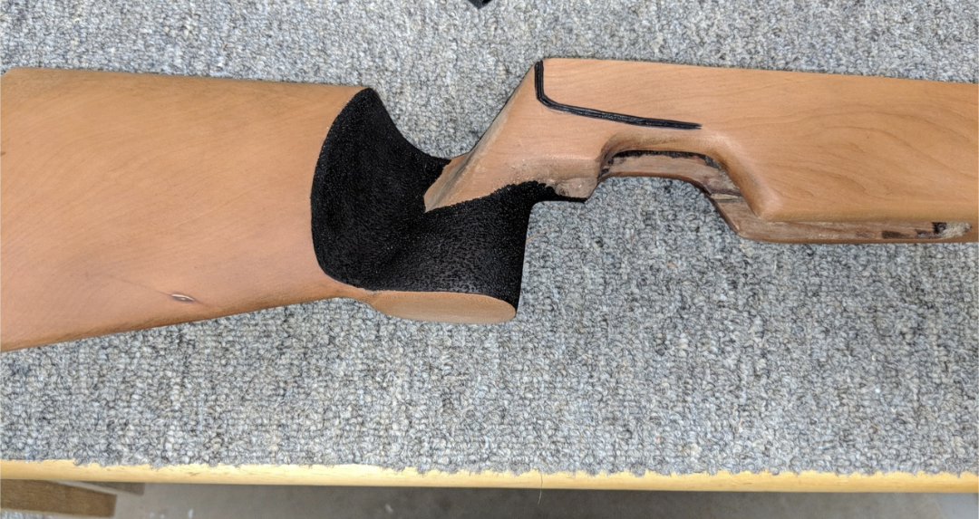

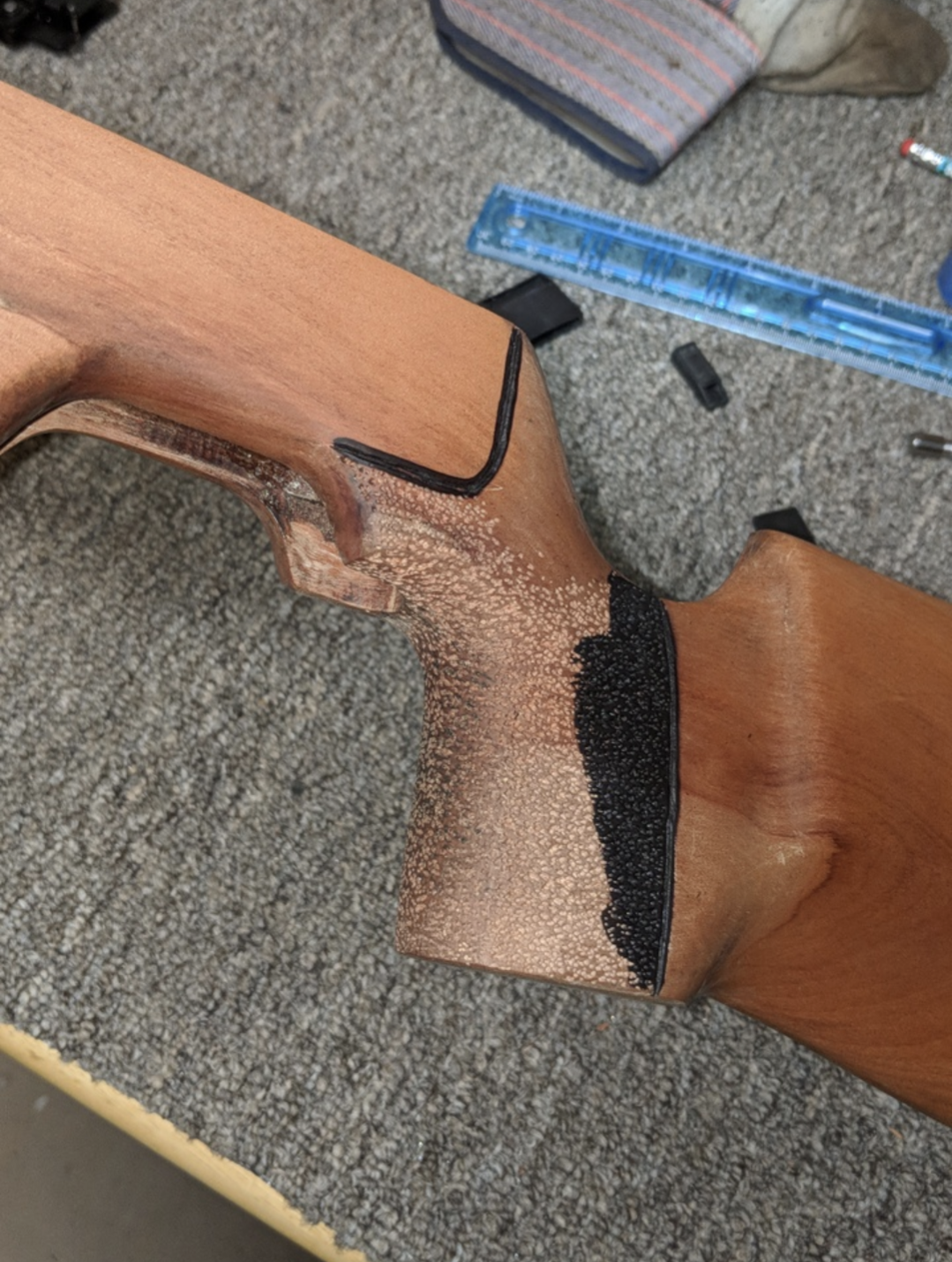

No acid or bleach. That blonde wood color is what was under the factory stain (which is more paint than stain, as is often the case with beech stocks).
Steps were: stripping down to bare wood by sanding off the factory finish, cut new lines for the stippling panels, restippled (after much trial and error on scrap pieces of lumber) dyed the stippling panels black (with permanent marker of all things), then finished with a bunch of coats of boiled linseed oil, and then a couple coats of Formby's furniture polish (advertised as tung oil but isn't much tung oil in it).
The mini stock, as received, doesn't look nearly as beat up in the photos as I remember it, lol.

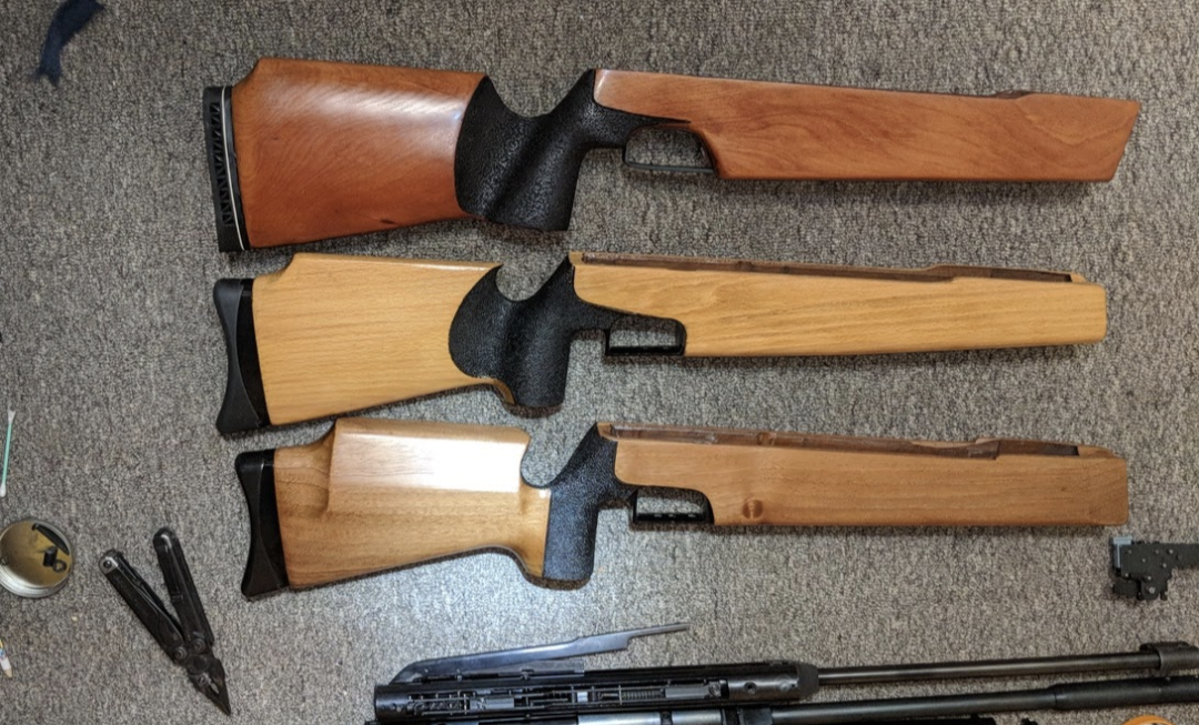

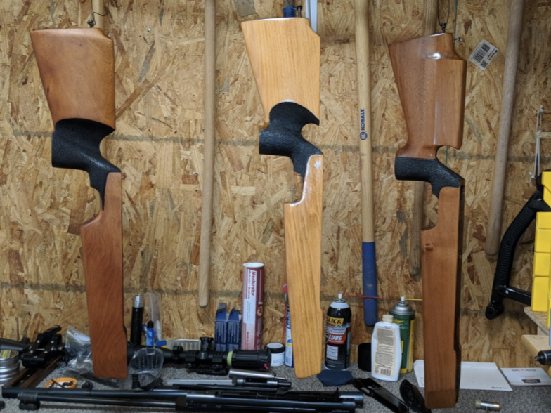

Screenshot_20240420-090911.pngScreenshot_20240420-090831.pngScreenshot_20240420-091035.pngScreenshot_20240420-091141.pngScreenshot_20240420-091210.png

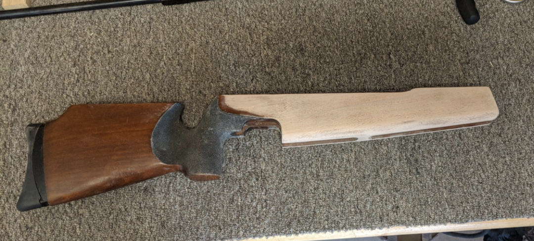

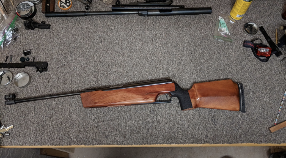

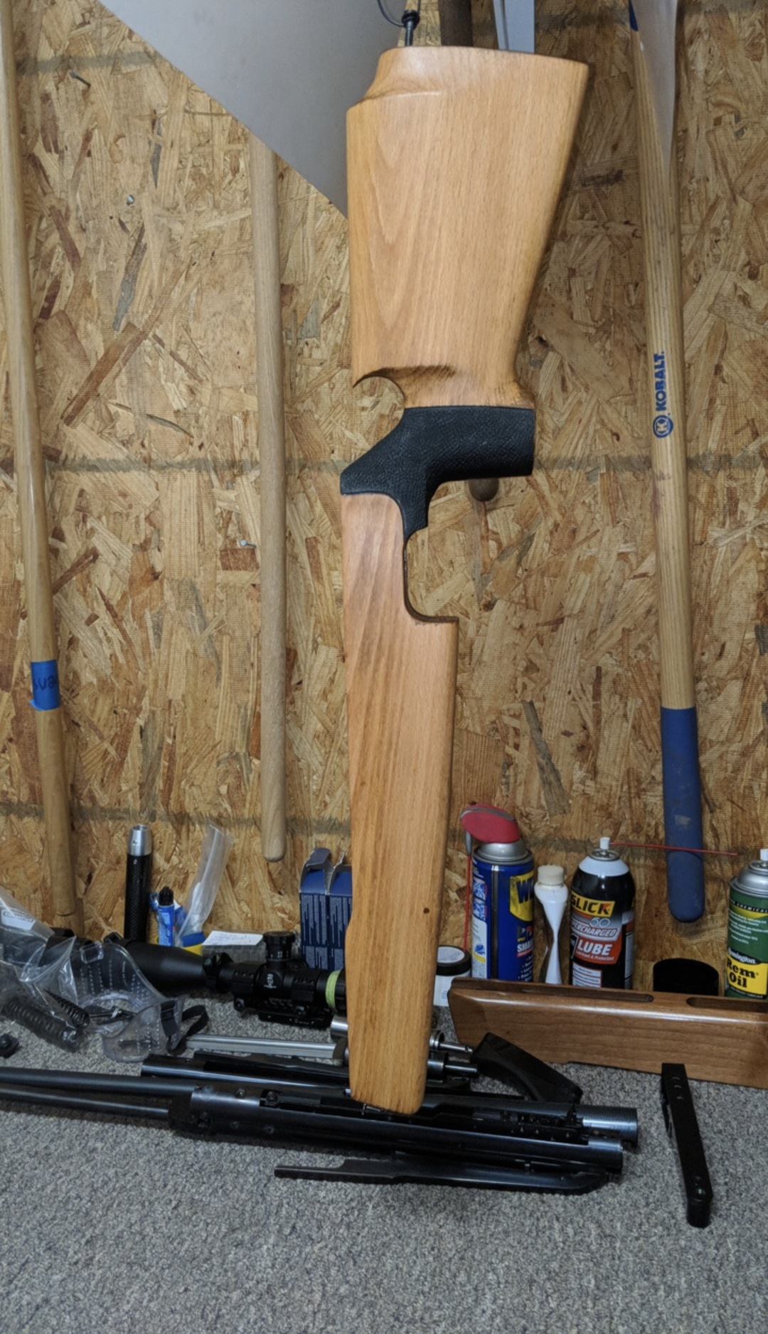

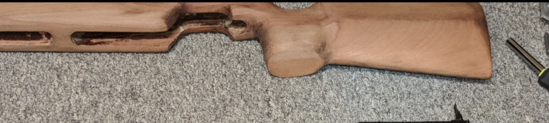

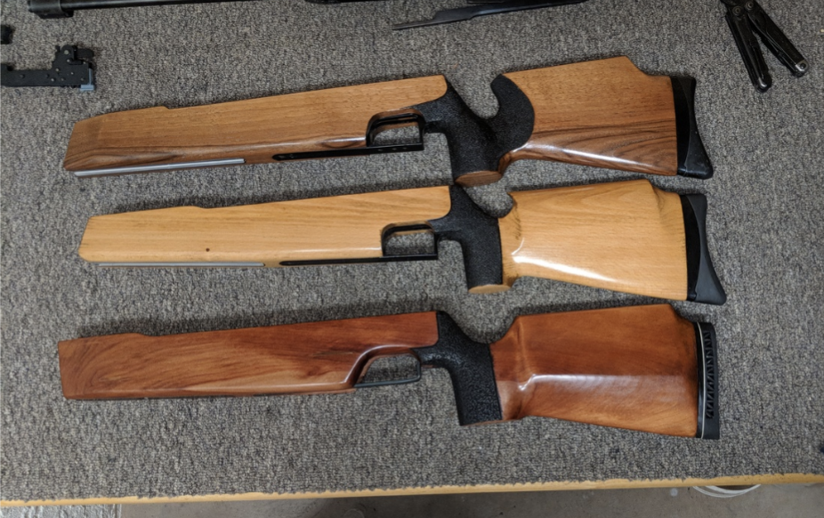

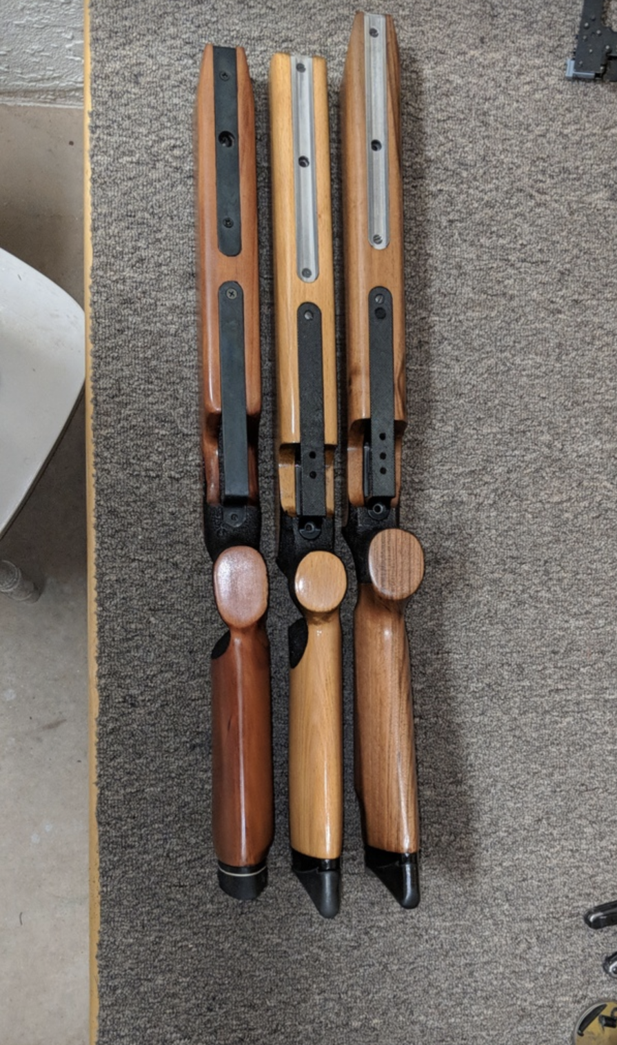

Here are some photos of three different stocks I was concurrently refinishing. The most red one is a stock from a Chinese clone of the FWB300s. That stock was a challenge. I had to plug holes to make it fit an actual FWB300 (not the clone it was meant for) and had to fit a buttpad and make hardware for it. Big project. The lefty is a walnut FWB300s stock, and of course the Mini stock is in there too.
Screenshot_20240420-091242.pngScreenshot_20240420-091259.pngScreenshot_20240420-091314.pngScreenshot_20240420-091325.png

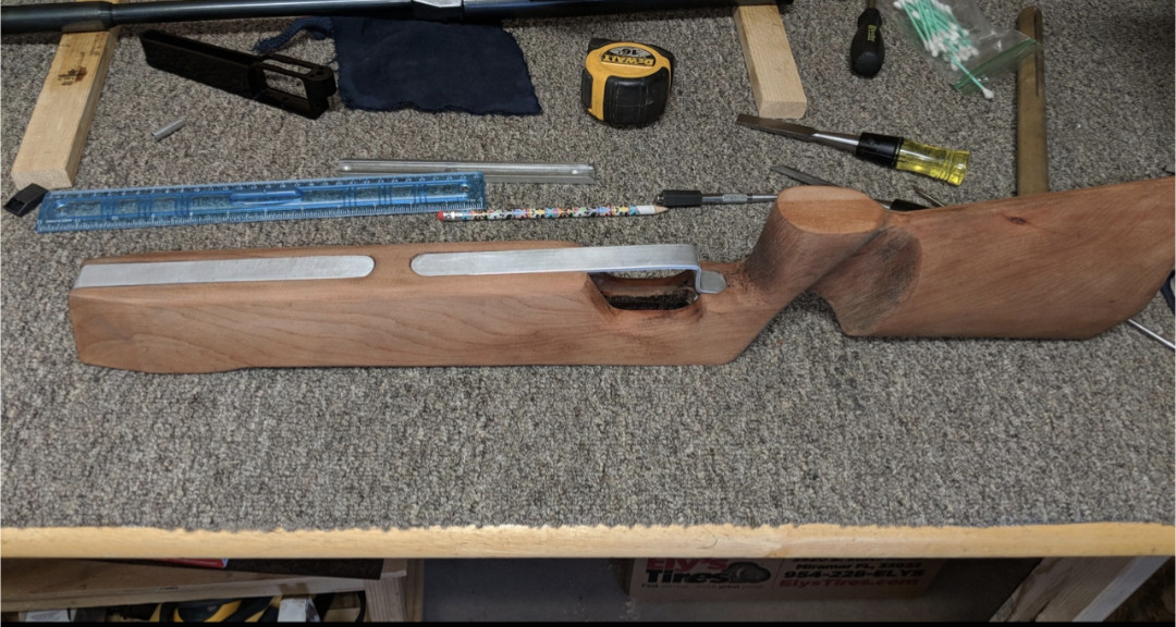

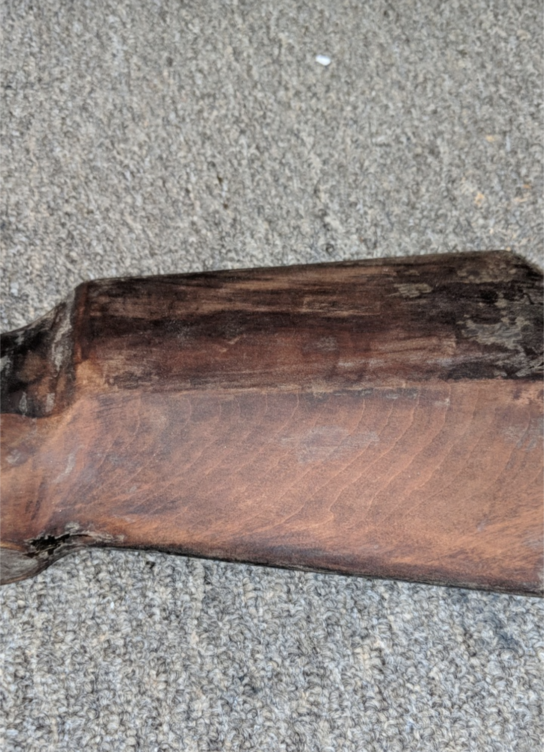

This is what the walnut lefty looked like before I stripped it. Why in the world gun makers slather that crappy brown color on a walnut stock....I just can't fathom it.
And some of the Chinese clone stock (the red one above) in process...
