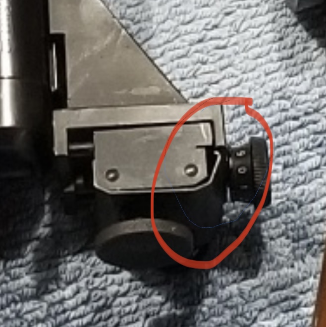

Easy fix, that plate bent right back. Not the problem, basically just a dust shield with a window and hash marks for windage. But, removing it let me see I wasn’t getting full travel for windage or elevation. It just felt like it LOL. Way mo bettah now. The clamp rails had also been buggered a little on left side and the sheared piece was beneath the clamp rail. So left side was sitting a few tenths of a mm higher than right. Fixed that too. Raining, rain tomorrow, not sure when I’ll get to test.
