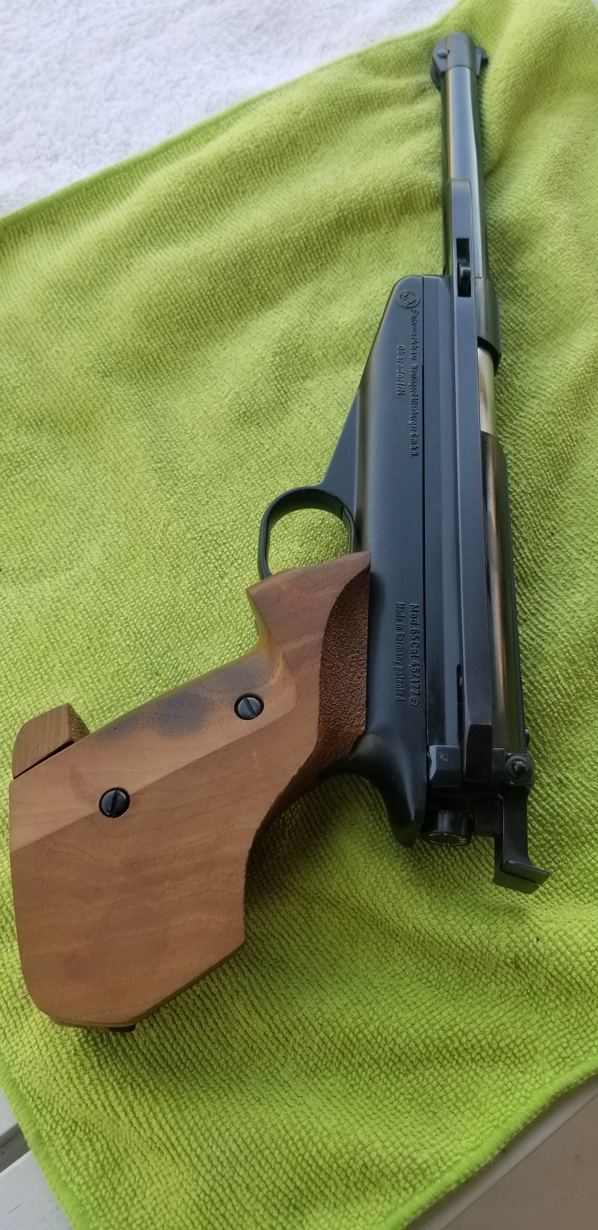

Can anybody tell me what variant this fwb 65 is ?
Thx
The trigger guard shape is that of a model 65. and it is plainly marked a model 65. The grips look like those on a model 80. That's about all I can say. No idea if the model 65 was really available with those grips as a factory option.

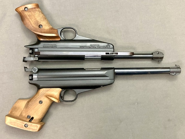

Changes to the 65 over time were minimal. Per the VAG link above, I sorta divide the 65 into three generations, mostly distinguished by the frame casting and sights.
+ "Gen 1:" Rounded front sight housing with fixed integral blade, recessed lettering, short tang, and a short rear sight with interchangeable blades for different notch widths.
+ "Gen 2:" Rounded front sight with interchangeable blade inserts, embossed lettering, short tang, and a longer rear sight with cam-adjusted notch width.
+ "Gen 3:" Angular front sight housing, embossed lettering, long tang, and a wider cammed rear sight. Both sights were shared with the model 80.
The 65's standard grips were actually sport type ones in checkered plastic. Wood sport grips (early checkered, later stippled) and match grips (in two subtly different styles, made in different sizes, and left and right-handed) were all optional upgrades. The nice tapered blued barrel sleeve was also an optional fitting.

The OP's gun is a textbook "Gen 2," with standard barrel, barrel sleeve, and match grips.

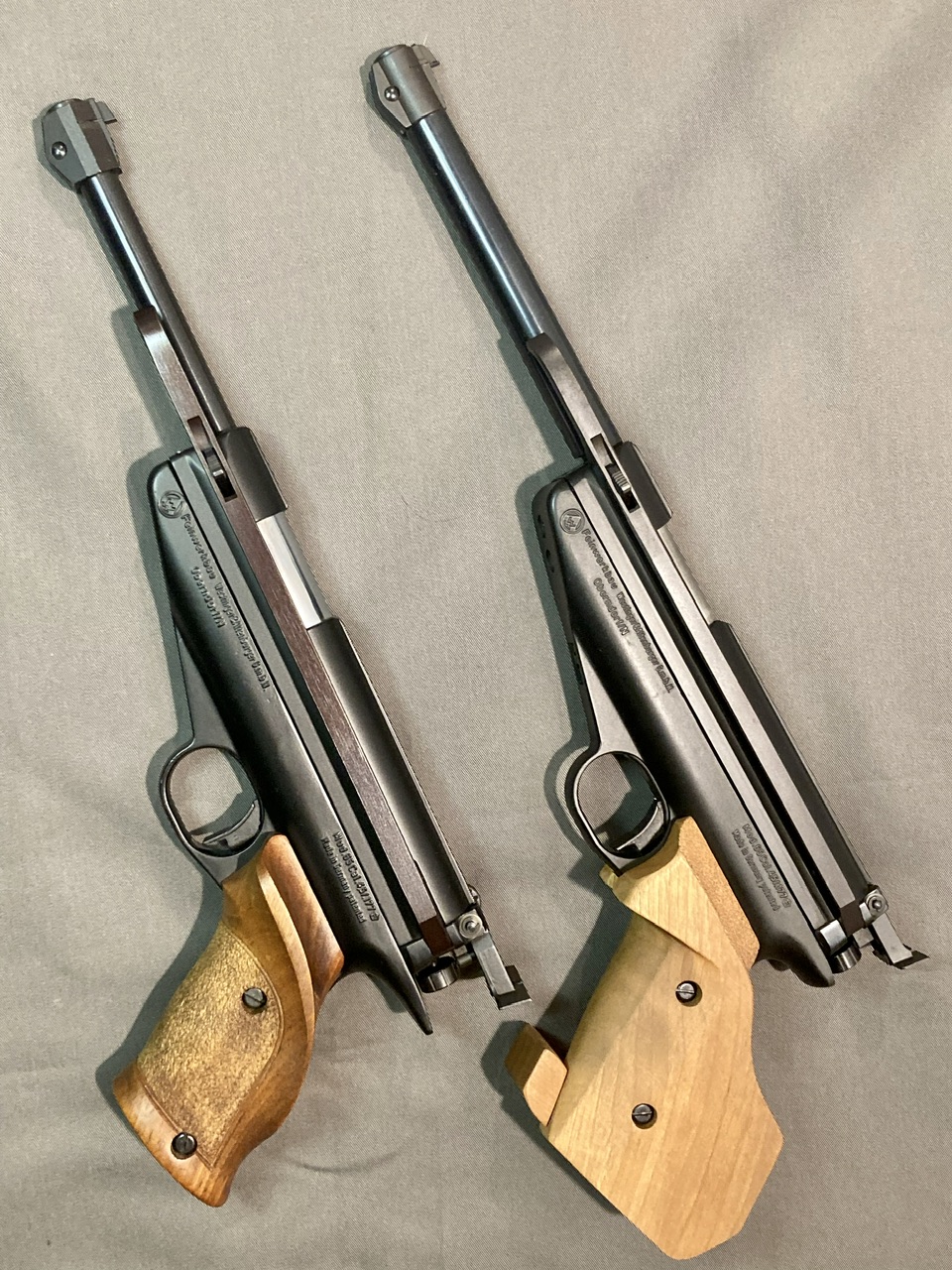

To supplement the VAG pics, here are my two: right, "Gen 2" standard 65 with barrel sleeve and match grips; left, "Gen 3" with short barrel and sport grips. Note the differing sights and tang length in particular.
Reactions: marflow 777

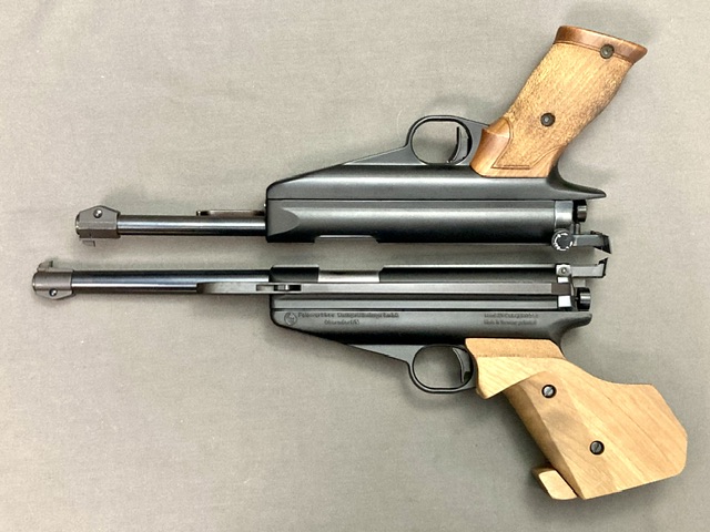

I prefer to ignore Beeman's "Mk 1" and "Mk 2" names. FWB themselves always called the standard gun simply "FWB 65," and the shorty "FWB 65 Junior." The two barrel lengths and optional barrel sleeve (made for both barrel lengths) were around for the 65's whole life. Neither is an indicator of when the gun was made.
As noted above, to me there are three main generations of the 65, distinguished mostly by details of the main frame casting, and sights (no doubt you are correct about other, smaller differences in minor components, though - of which I am not an expert).
"Gen 1" = Quite rare, especially in the US. I've never seen one outside of Danny Garvin's VAG site pics which you linked.
"Gen 2" = The most common type by far. The OP's pistol is a "Gen 2."
"Gen 3" = Last version with longest tang, which borrowed sights from the model 80.

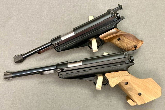

Here are more pics of mine which may help:
"Gen 2" with long barrel, barrel sleeve, and match grips. Serial 65360, made about 1974.
"Gen 3" with short barrel and sport grips. Serial 130449, made about 1985.

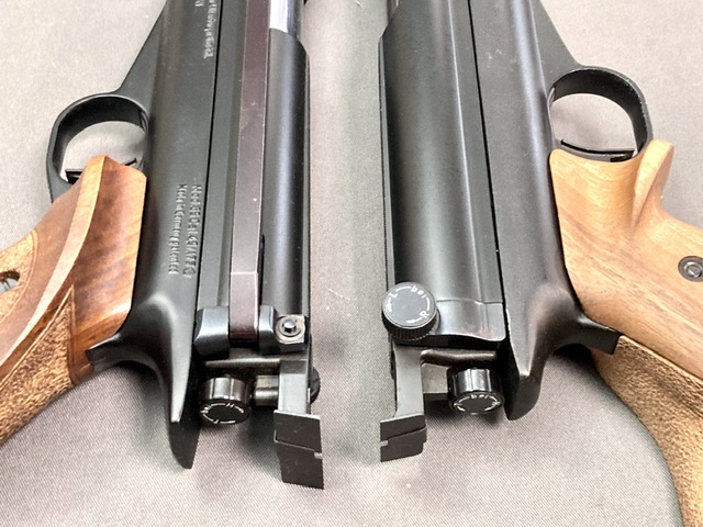

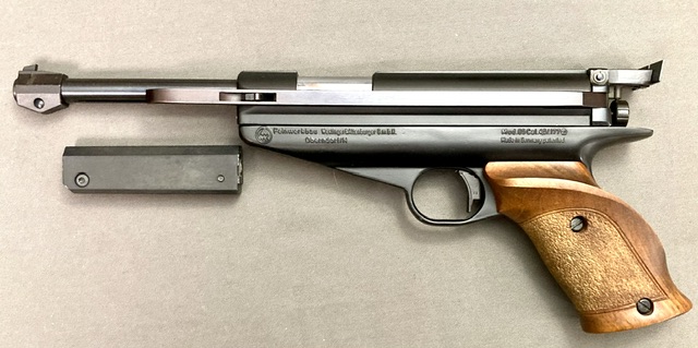

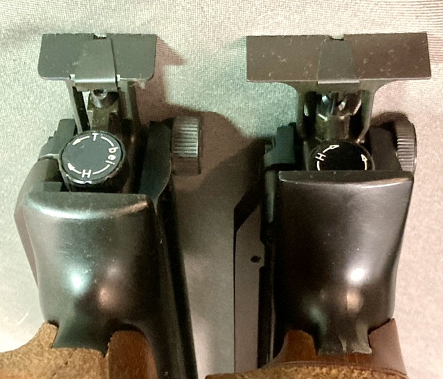

Couple more pics...the clamp-on cast weight for the short barrel, and a better comparison of "Gen 2" and "Gen 3" sights. The latter is 38 mm wide and a better cant reference for match shooting, but tends to catch on your clothes! I prefer the earlier 25 mm wide one for sporting use.
