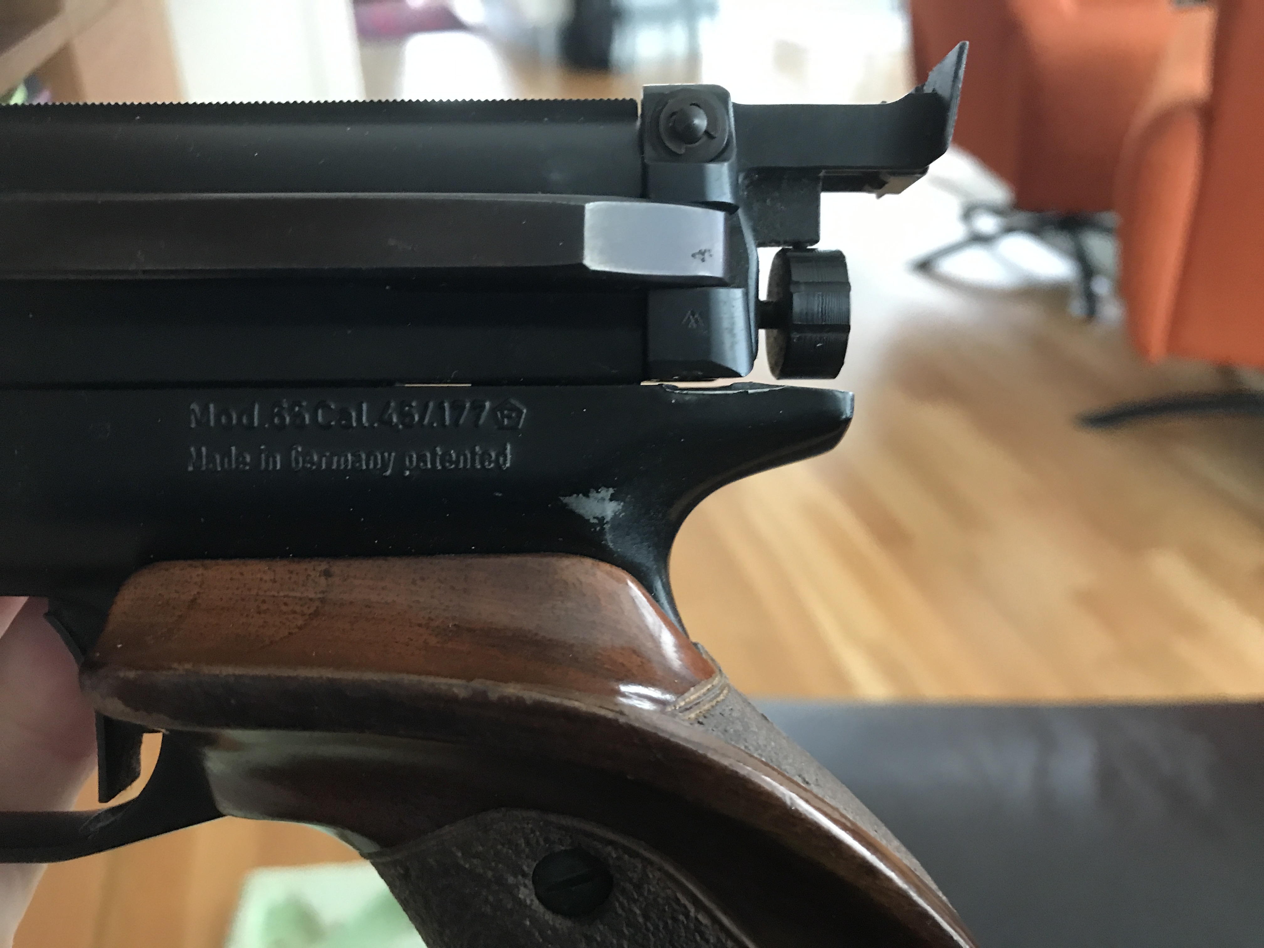

Looking at the close up photo of left hand grip which shows cocking lever pivot, It does appear that the screw which is accessible from the bottom, after removing the grip has backed out. I do not yet have a 65, but have an 80 and that screw should be tightned so it is up in a recess and is hidden from side view. In you picture it is definetly contacting the frame. Remove the grips and tightned it,
Reactions: Bandito
Jkingrph - yes access, that was the key word I overlooked….
Thanks for your observation!
All right now.
All right now.
That looks better, more like mine, except for the gouge. I would watch that and if it starts backing out again, clean the threads and use some med strength loctite one it

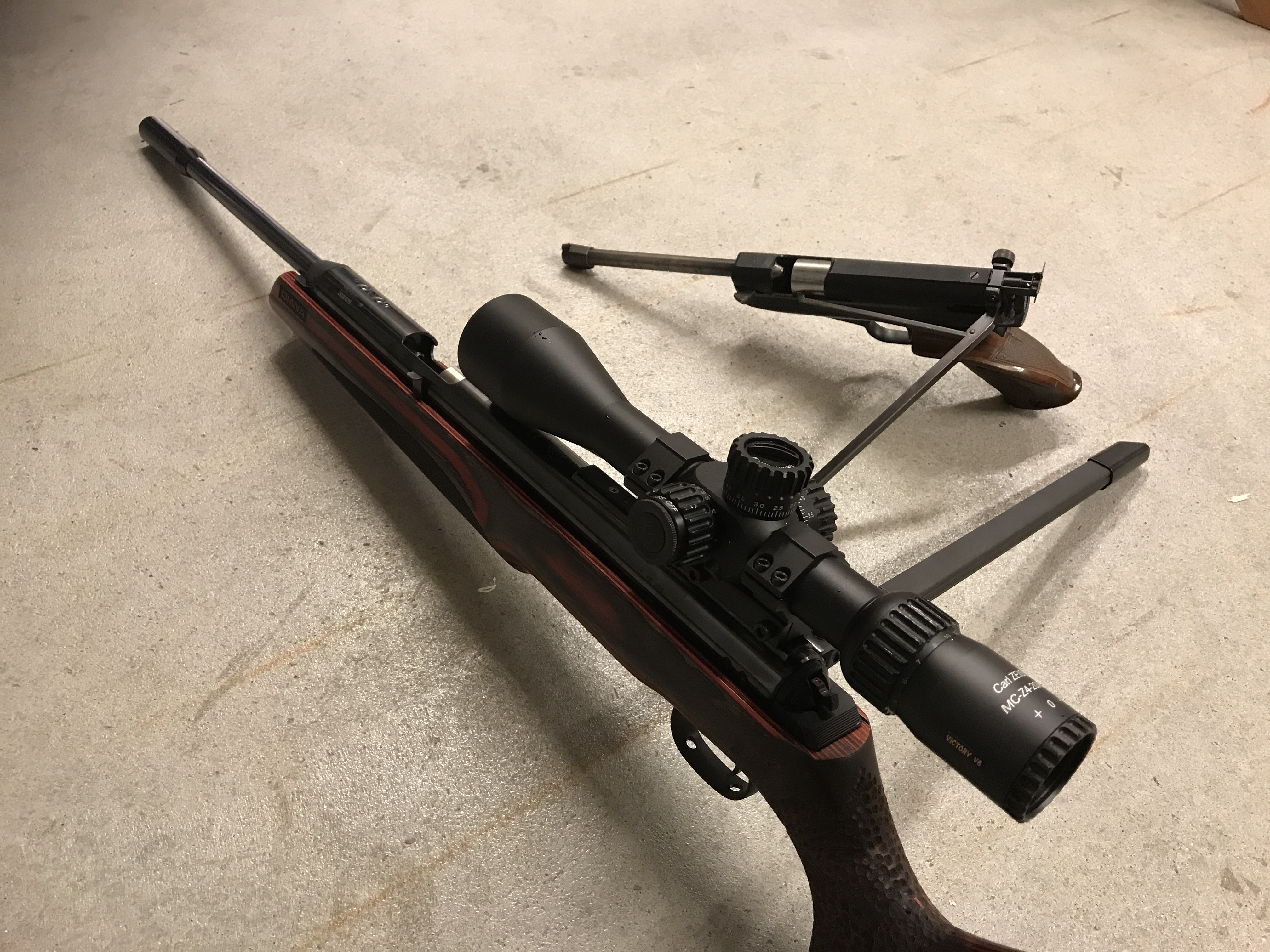

Got my hands on this vintage side lever Feinwerkbau pistol in exchange for a Daystate Air Ranger 50. A lovely recoil less pistol with an outstanding trigger. Not to wonder that this pistol was top ranked as a competition pistol in its time. (Not this version with the ordinary grip).
Very accurate pistol, but I will try to mount a small picatinny rail for a red dot sight for my own amusement. This will not ruin the original rail, since there is drilled a hole in it already for a screw.

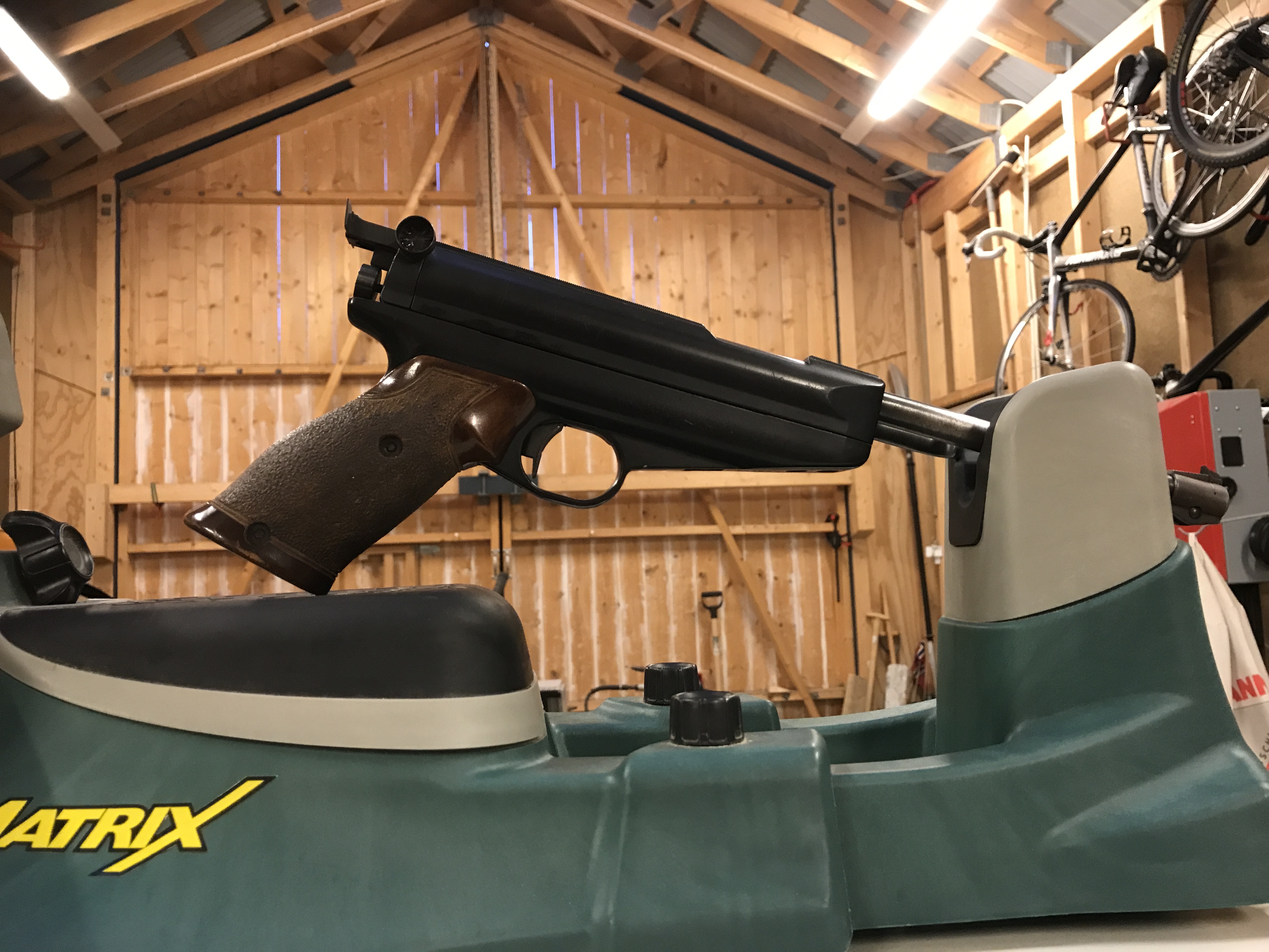

Yes, that was just what I experienced, so that was no solution. Tried to mount a red dot on the barrel, but the attachment didnt last, so for now that project is on ice so to say...
Reactions: Bandito
Reactions: Bandito
That might be ok if you wanta smaller red dot type sight. It will take two of those to mount a scope to the barrel. It's going to have to be far enough forward to clear the cocking lever, so I think it will eliminate the possibility of a scope, besides a scope would probably then block your loading port. It may put too much weight forward, although I have mine now equipped with a barrel weight which I like. A scope way forward like that will make it extremely barrel heavy.
