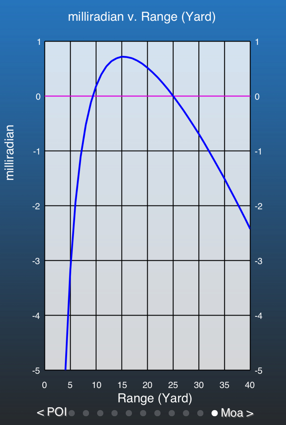

any thoughts on why the two intersecting points had the same zero @ 10-25 yards??
A quick ChairGun says yes, your near and far zeros will be 10m and 25y.
I’ll bet it’s a sweet shooter.
It's not flat. It's the 2 intersecting points ie, line of sight. My 300s that is a bit faster than yours with the scope mounted pretty high intersects within .25 inches at 12 and17 yards. Perfect for where most of my backyard pesting takes place. Sometimes a guy gets lucky.
Yes yes yes …. Know this
Didn’t realize the ballistic / trajectory path as I generally only shoot 700 FPS and above
