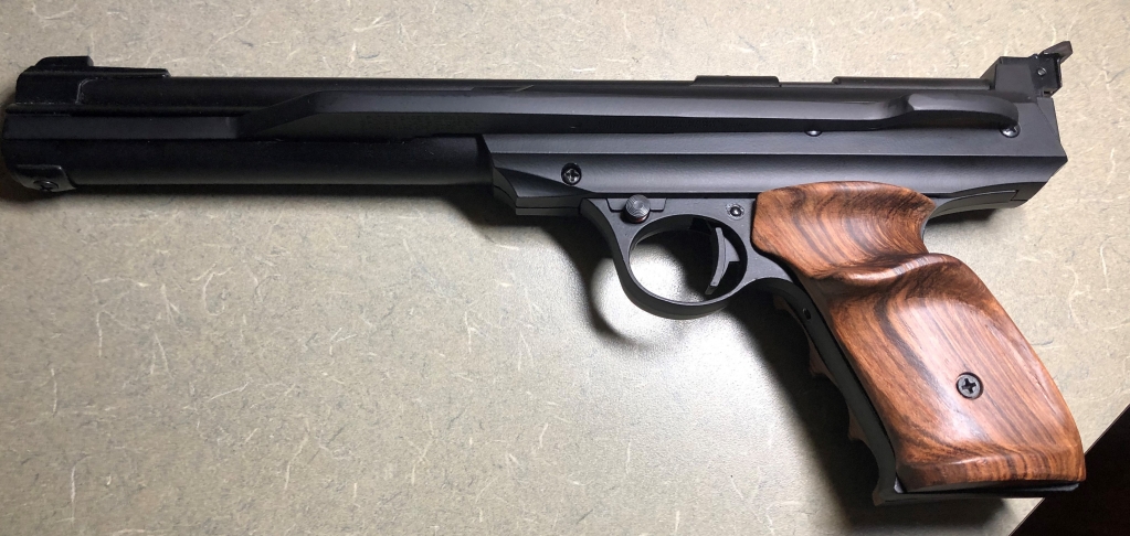

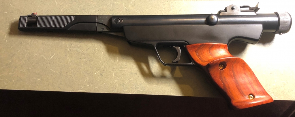

I recently got my Beeman 850 ( same as the Diana 6M) pistol back from David Slade. Work was done , and now the pistol is up and running. I have an air gun friend who builds great grips. I will contact him if the demand is out there , but must give him a heads up. Here is a picture of the pistol mentioned , with his grips. Also my daisy 747 with his grips. They fit like a glove. He makes a match grip that has a extention that braces against the wrist.
Beautiful work. David Slade might be the agent for your friends grips as I'm guessing he is one of if not the go to for such guns as yours and mine. How fast are your pistols? I think I remember the Daisy match guns being around 320fps or so and no idea on the 6M.
