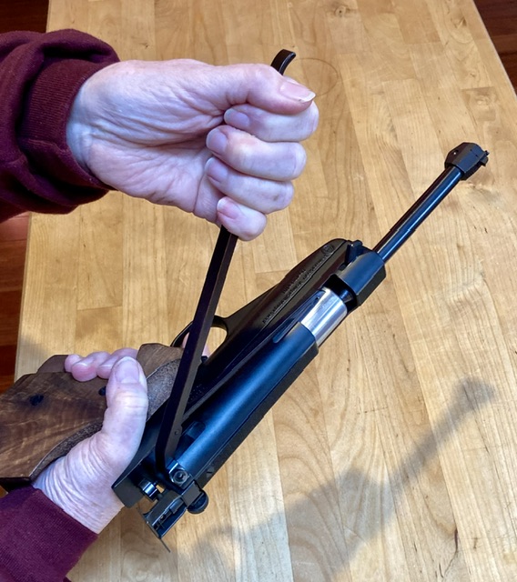

The only negative thing I can say is that the sidelever cocking can be hard on wrist and elbow. The traditional way to do it is to hold the gun vertically and pull the lever sideways with an overhand grip...

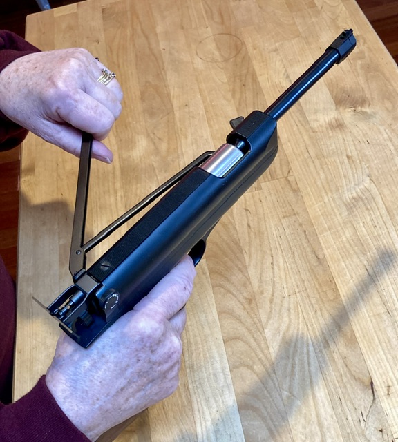

...but I find it much easier on old joints to hold it horizontally (i.e., palm up) and pull the lever up with an underhand grip (with thanks to my bride for posing 🙂).
And the match grips are a bit easier to cock than sport grips, too. The contact at the heel of your hand gives some extra leverage.

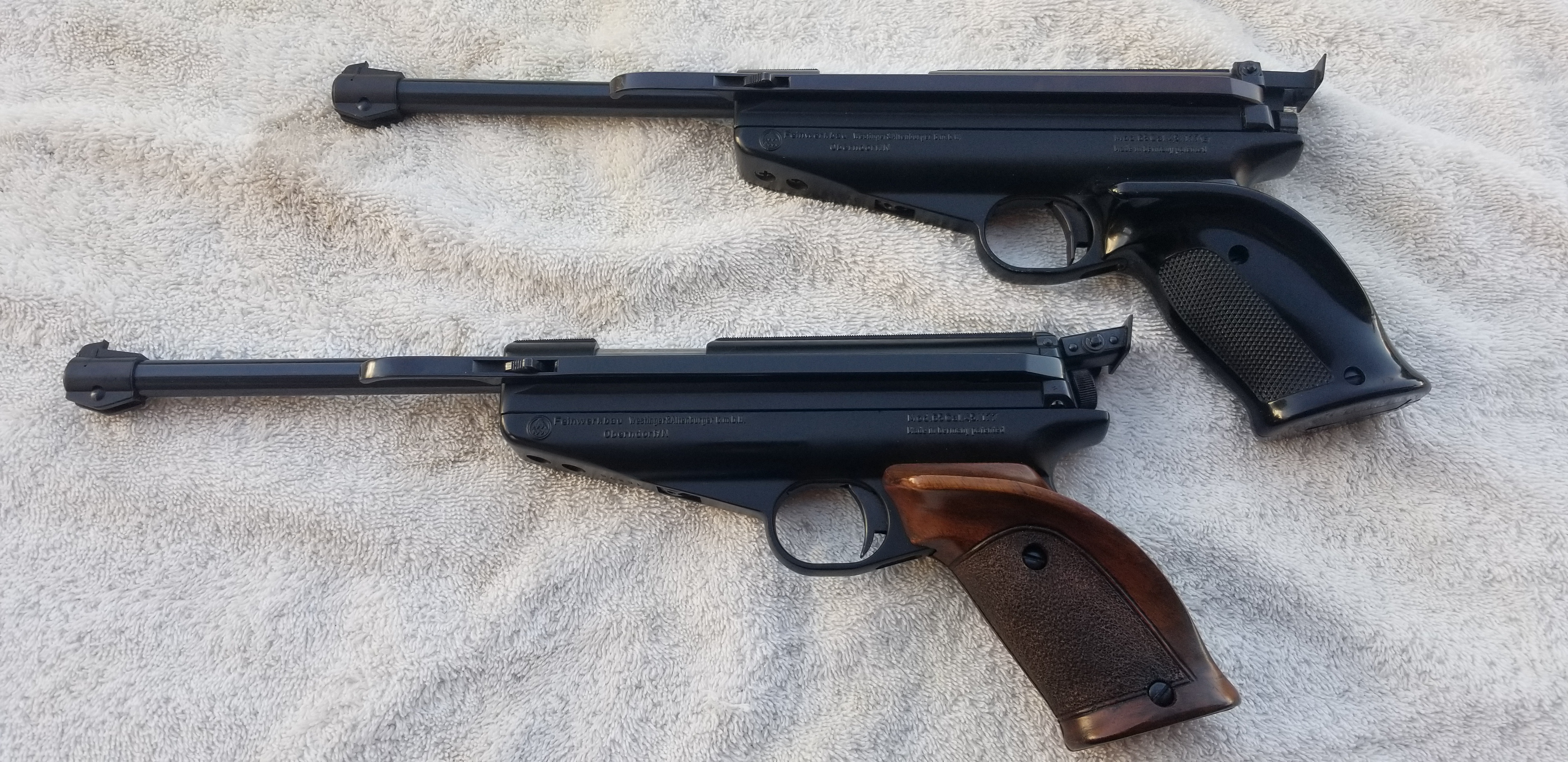

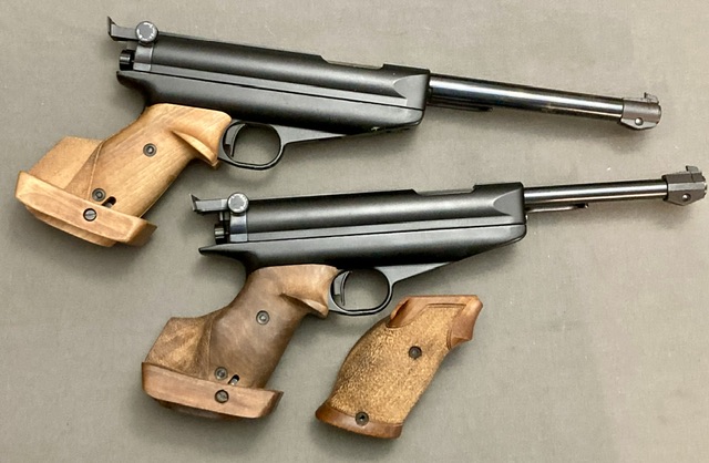

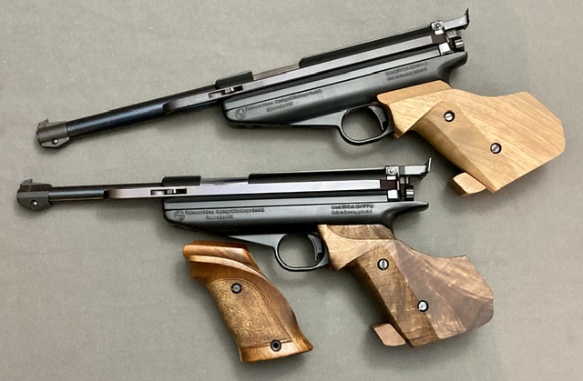

The upper gun is an early version standard 65 with short tang, long barrel, and sleeve weight. Lower one is a later example with long tang and shorter Junior barrel (grips are currently swapped - the set with curved thumb rest came on the earlier gun). The later grips have a flat thumb rest, and usually a minimum of finish. Also a set of stippled sport grips for comparison.

Very cool pair of 65's! The gun was sold as a sport pistol in Europe with the plastic grip panels as standard. I don't think Beeman ever offered them here, preferring to make the pricier wood a "mandatory option," lol. The plastic ones are high quality and very comfy, though.
The 65's action has no plastic beyond the seals, but the two main frame and receiver components are high-quality alloy castings. The only sizable exterior blued steel parts are the barrel, cocking lever, and rear sight housing.
