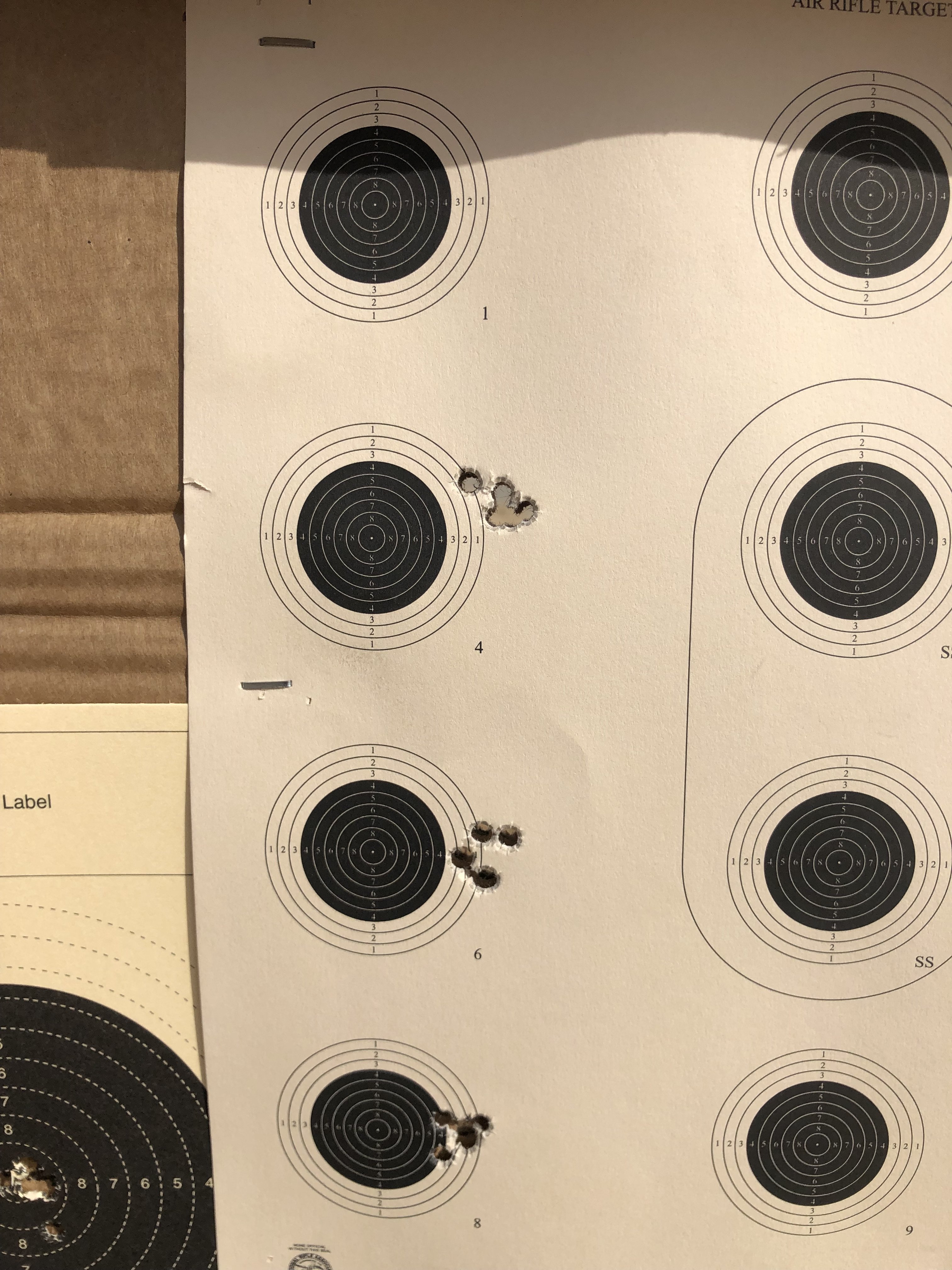

TINY groupings at 35 yards!
Tried 40 grain H&N as well, seems to be grouping a little bigger but too early to tell, might just be a matter of tweaking the current settings a bit.
Still have to fine tune with chronograph and long range testing, but it's looking very, very promising. (now power wheel on 23 & quick tune on 3.5, I'm guessing 900 - 950 FPS with the 37's)

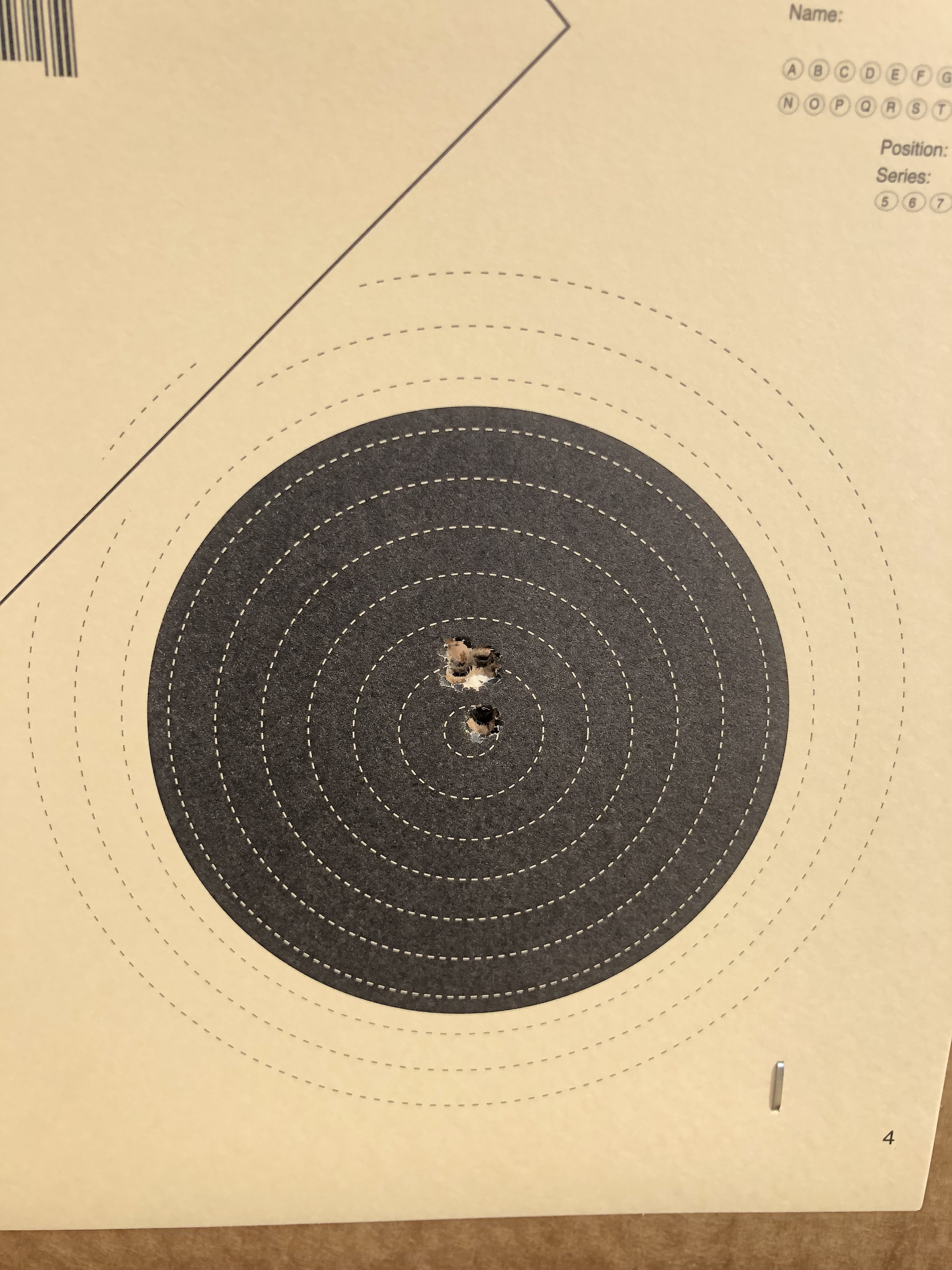

Ok, tried at 50 yards. Calm, hardly any wind.
No chrony, but tuned below the knee. 140 bar, large wheel 23, quick tune on 3.5.
Couple of observations;
'Cold bore' / first shot is a good bit lower, gun needs 1 or ideally 2 shots to become consistent. My guess is combo of valve stiction as well as reg creep (about 5 bar according to reg pressure factory gauge).
That disqualifies it for a hunting gun in this current setting (for me). My goal is now to get that cold 'bore shot' closer to the group.

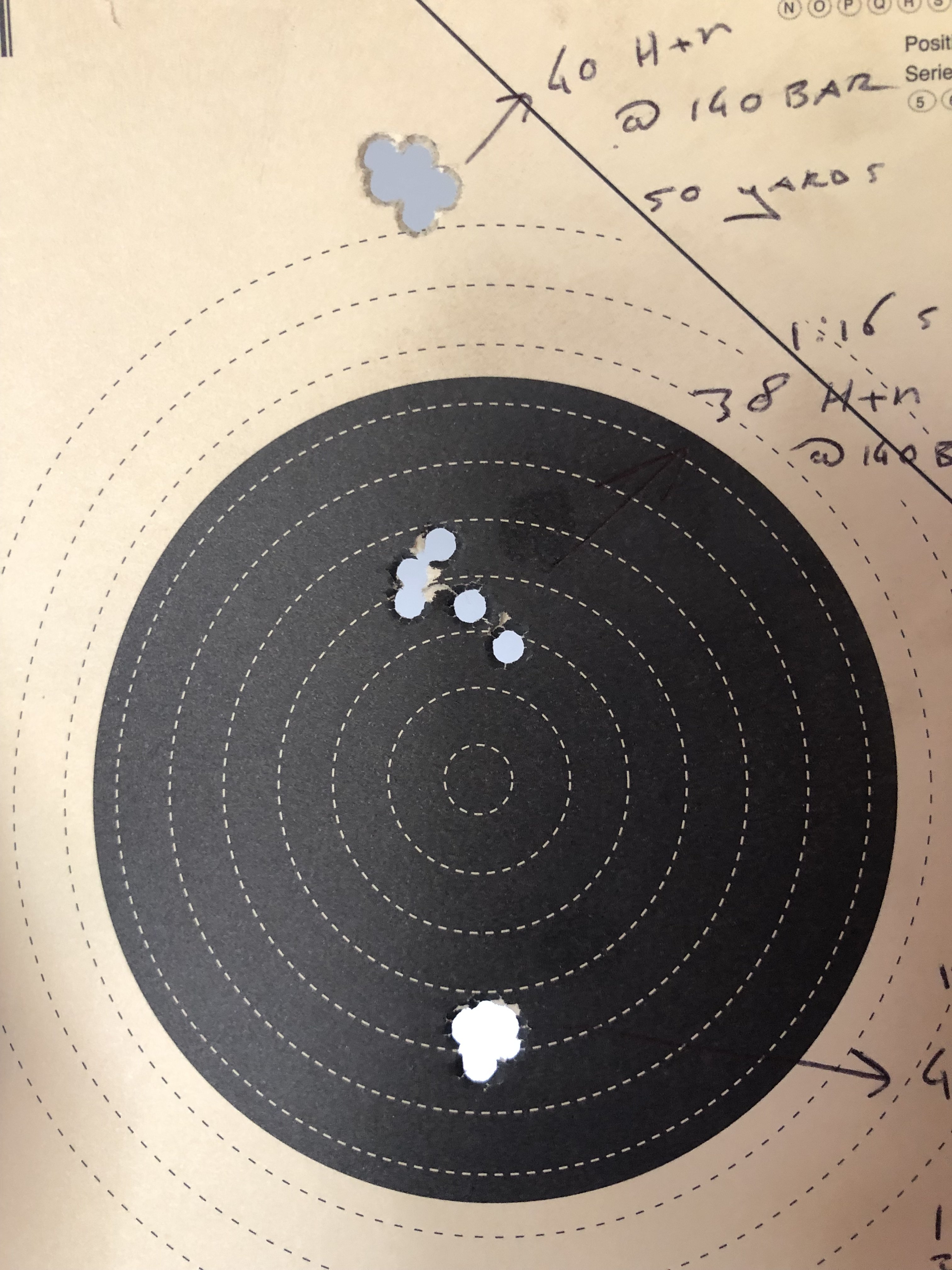

Started with 37 zan,
first shot low, then 5 in bottom group. Quick tune wheel 2 clicks up, adjusted scop for bullseye, then I shot the top group. That looked promising;
38 grain H&N at same setting did OK , not spectacular, but not horrible;
Then onwards to H&N 40 grain.
Bottom and top group = 40 grain H&N, middle group 38 grain H&N;
Thought I was there, but the darn 'cold bore 'shot (giving the gun 10 minutes or so before shooting the next group) showed up again, even after just 10 minutes. Less then 5 bar creep according to pressure gauge.)
This is what's repeatedly happened, 1 low, other 4 touching;
