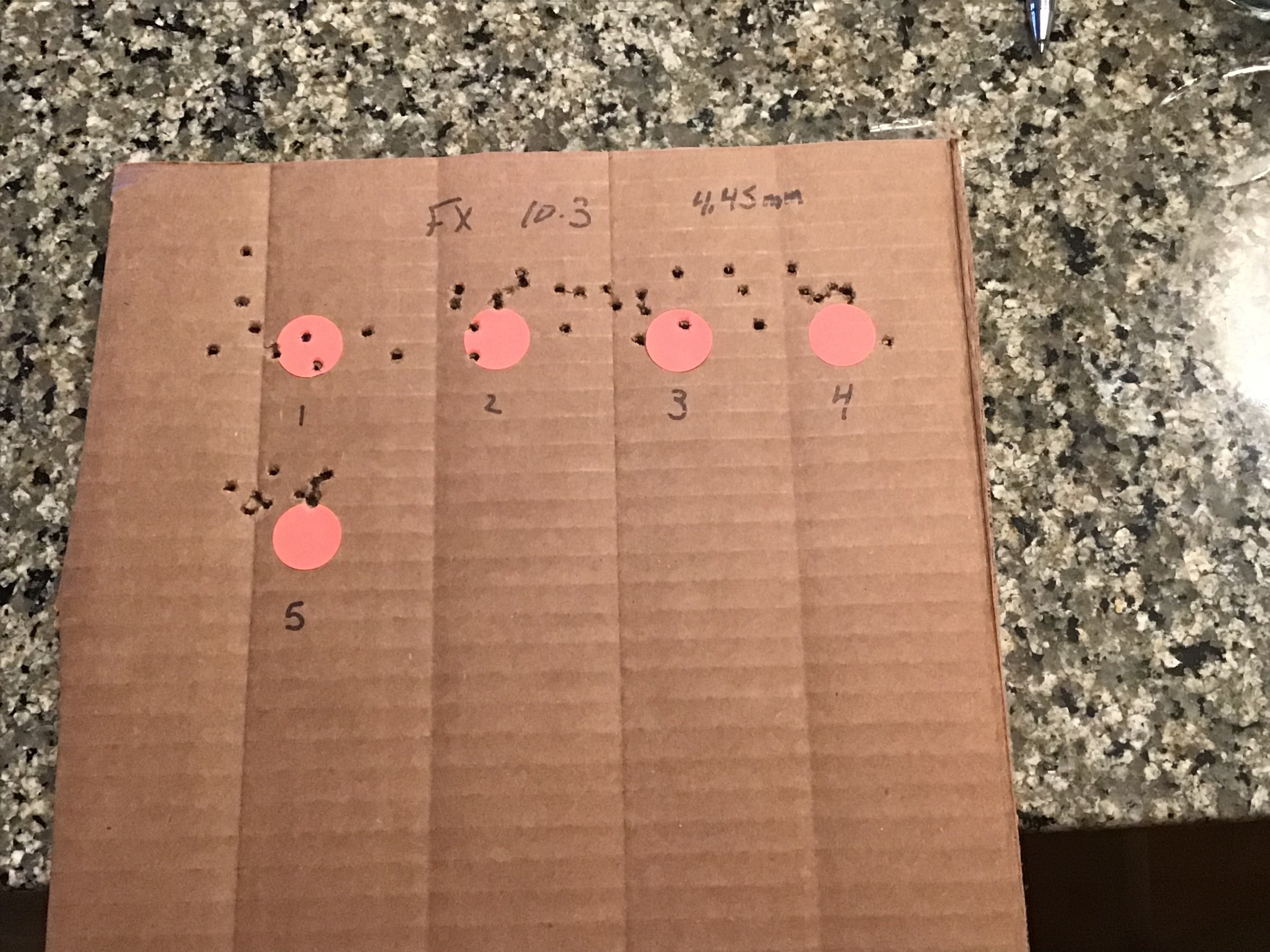

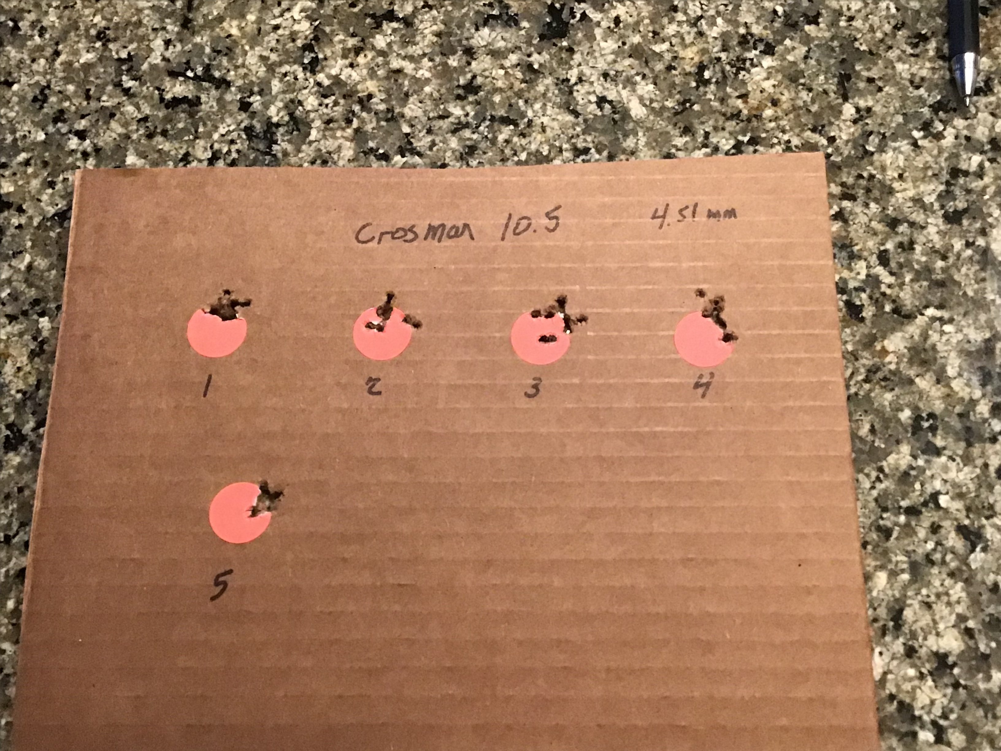

This is what I was getting at 25 meters, first picture FX pellets, second pic Crosman boxed Premiers. I was doing ten shot groups from 2800 psi down to when velocity dropped by about 5% or so to see how many shots I could get and if accuracy changed as the tank pressure and velocity decreased, but even at the lower pressure and velocity of group 5, it was still pretty bad for that range. As much as Crosmans are considered average quality pellets by many, they shoot just as good as the FX 13.4 grain pellets I have been testing as well. Some of the Crosman groups might have been affected by the wind, it wasn’t windy per say, but it was a bit variable as the sun came in and out of the clouds. Just for reference, the dots are 3/4” diameter.
