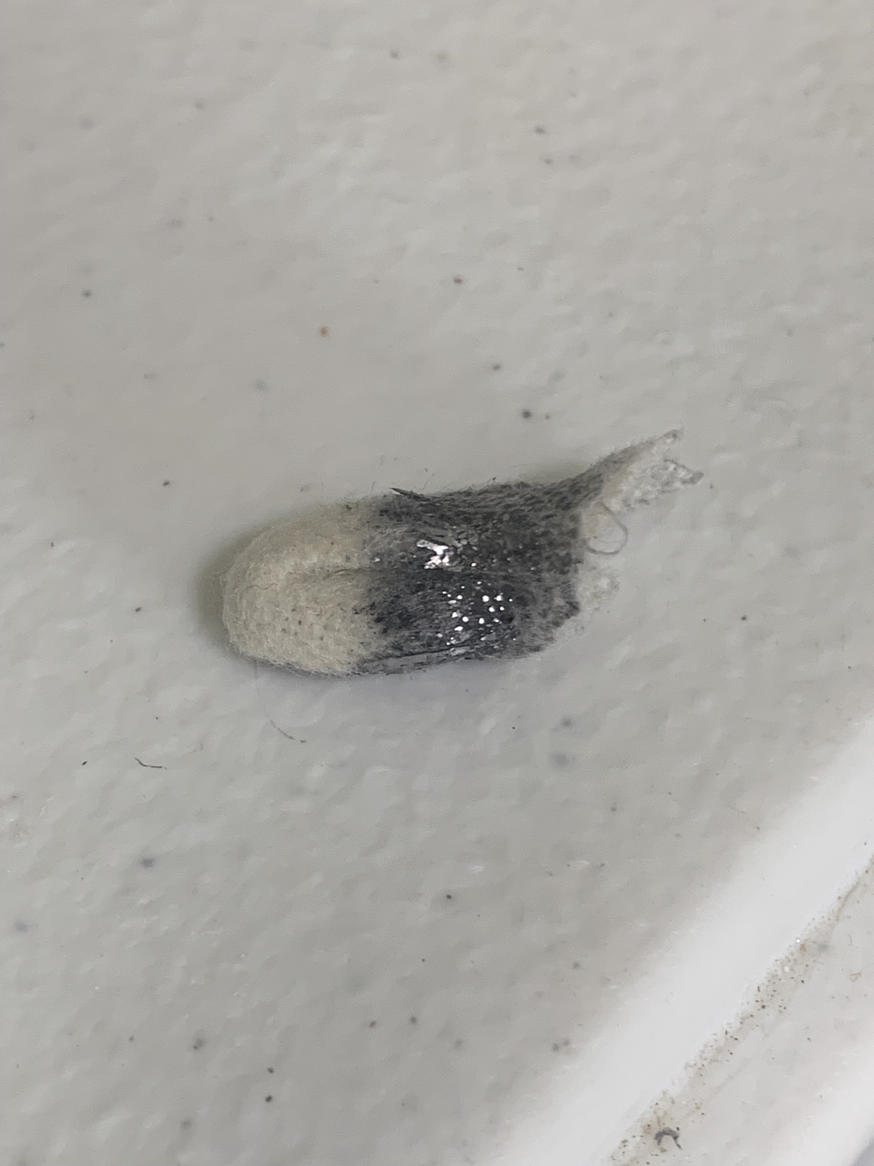

All Javelin ammo has been terrible. Might as well throw the slug down range by hand. Best groups have been with the H&N 40 gr, .250 (2-3 MOA groups at 50 yards). However I’m getting 1-2 really bad fliers for every 5 shots. I suspect the fliers are caused by heavy lead fouling. Below is a picture of the first patch after 100 shots using the H&Ns. I get similar lead fouling with all Javelin and H&N ammo tested to date. The NSA’s don’t foul as much.
It looks to me like the slugs are being shredded in the liner. Anyone else experience this?

I have already polished the liner with JB bore paste and flitz but it didn’t seem to make much difference, if any. After pulling two dozen patches thru my liner (soaked in Ballistol) I can still see some lead particles “stuck” on the inner surface but they will not come out. Would it be ok to use a brass bore brush to work them loose?
I’ll probably contact FX USA again and see what they have to say. Ugh.
