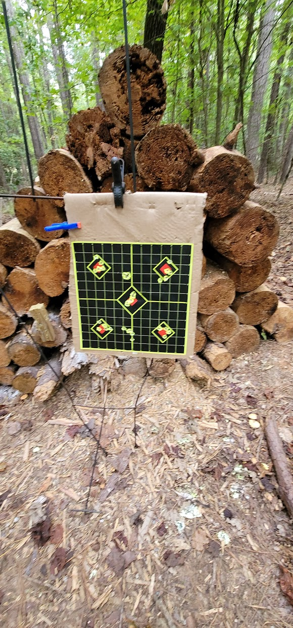

I started out with a brand new never shot 700mm 1:16. Gave it a bit of prep and shot approximately 150 rounds of mostly ATP Smooths, shaking down a new to me gun that is made up of shipments from at least 3 members here and another member over at GTA.

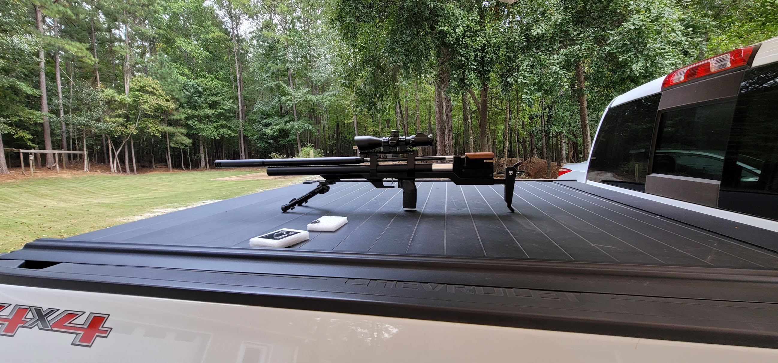

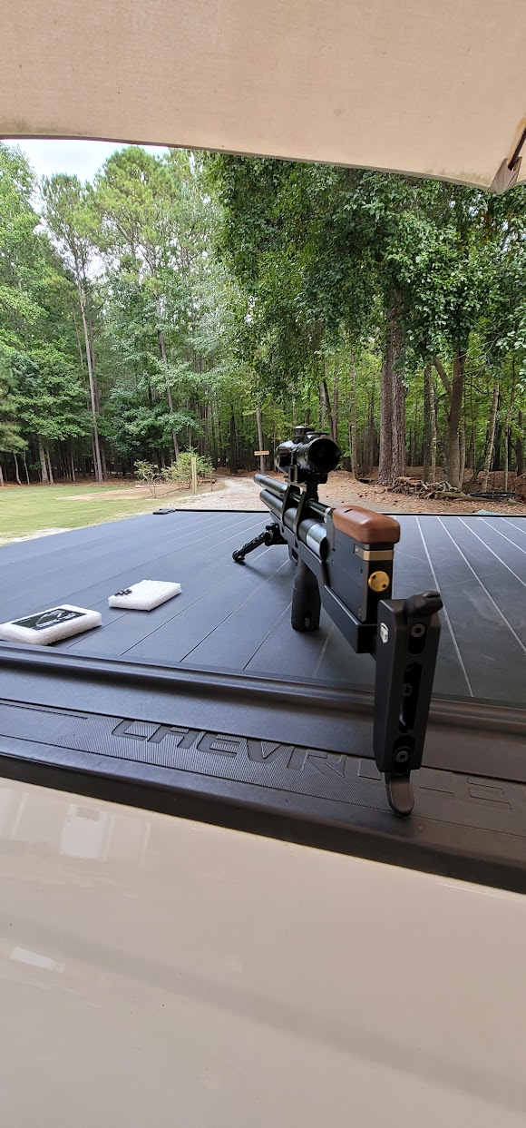

After work today I wanted to see what a complete shot string looked like on a full fill, starting with the first shot after filling. OG Veteran long ATP Smooth 49.5 @850fps, my 100 yard range. Leaning against the side of my truck, bipod rested on the bedcover.

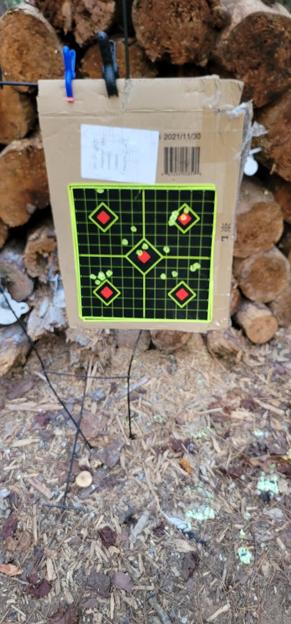

5 shot groups working from top left (1) to top right (2) to lower left (3) to lower right (4) to center (5) to lower center (6) then when she was in that goldilocks zone of just before and after coming off reg, top center (7) 35 shots total. I put shot 36 over the chronograph expecting low 800's, it was 845fps.
Group 7 was the best 100 yard group I've shot in recent history, possibly ever.
I am not the best shot nor are these perfect groups, but I guess I got a decent liner.

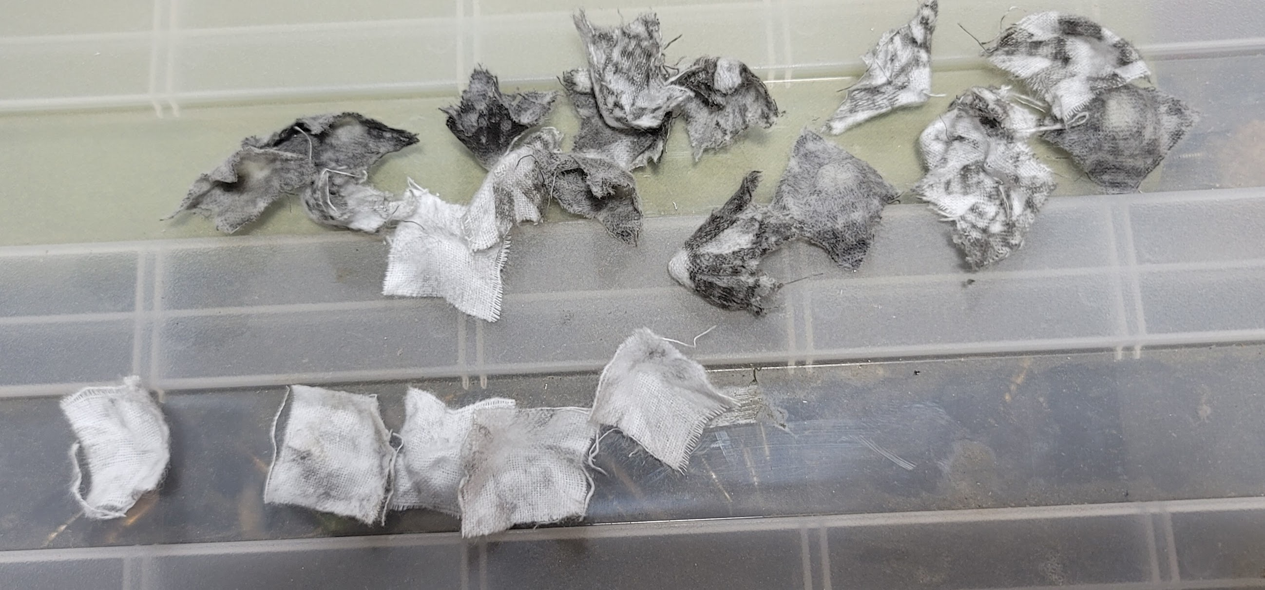

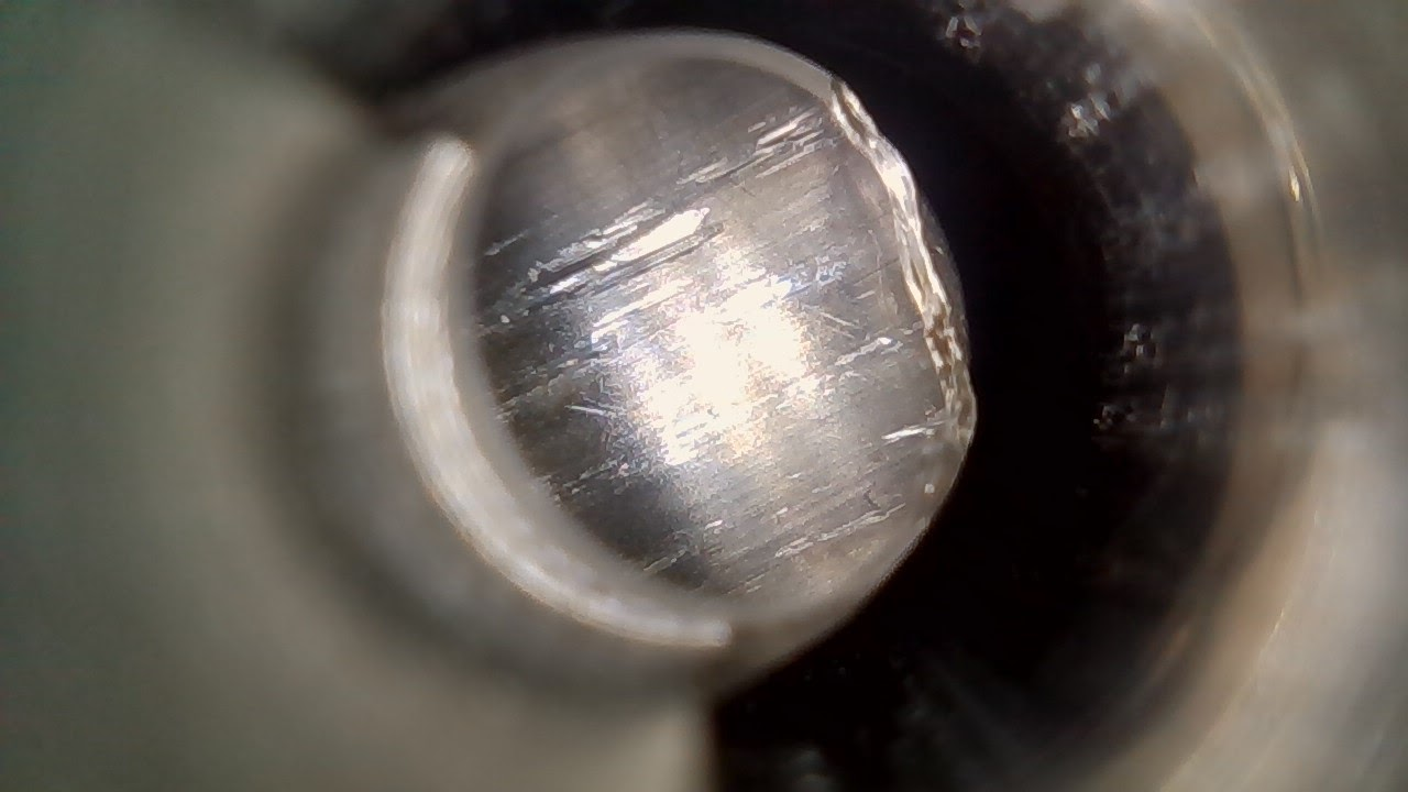

Somewhere around the 200 shot mark accuracy went to heck, and it did so very abruptly.
Borescope inspection showed a lot of lead buildup.
Using Ballistol as cleaner, it was rather difficult to clean up. I have since ordered some shooters choice.....
