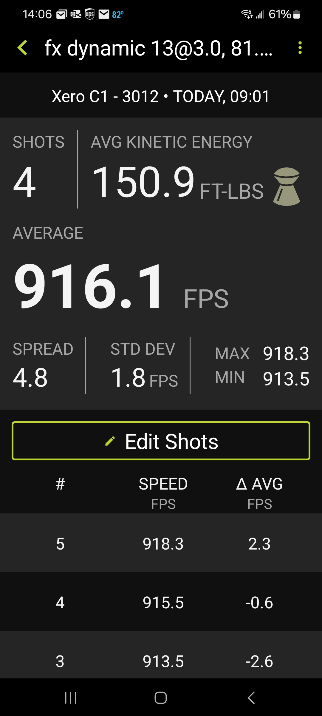

thanks, I agree that 50 yards is far better. I'll try that later this week. What I did so far ( after YouTube views ) is this: I turned the large wheel ( macro) to 13, the micro to 3.0 , left the regulator at 125. I obtained: 914.7 fps, ES 9.0 and SD of 3.1. That's with the same JSB 81.02 gr pellet. The search goes on. They offered to tune the gun for me for a fee, but I decided I'm save the cash, buy more ammo and learn how to do this myself. I'll change from pellets to slugs anyway so sooner or later I'll need to know how. This airgun world is very different. I come from the cenetrfire long range world and load my own. So tuning a load to a gun is well understood, with the airgun it seems we tune the gun to the load. Interesting.
