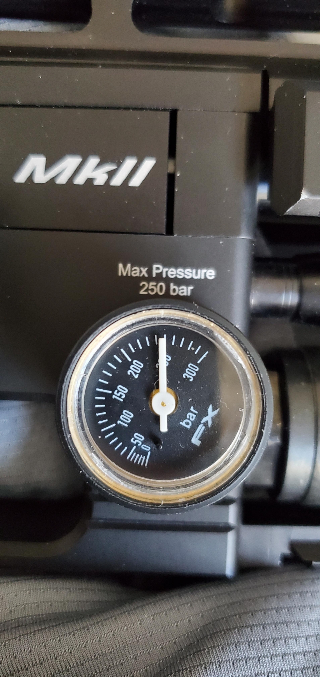

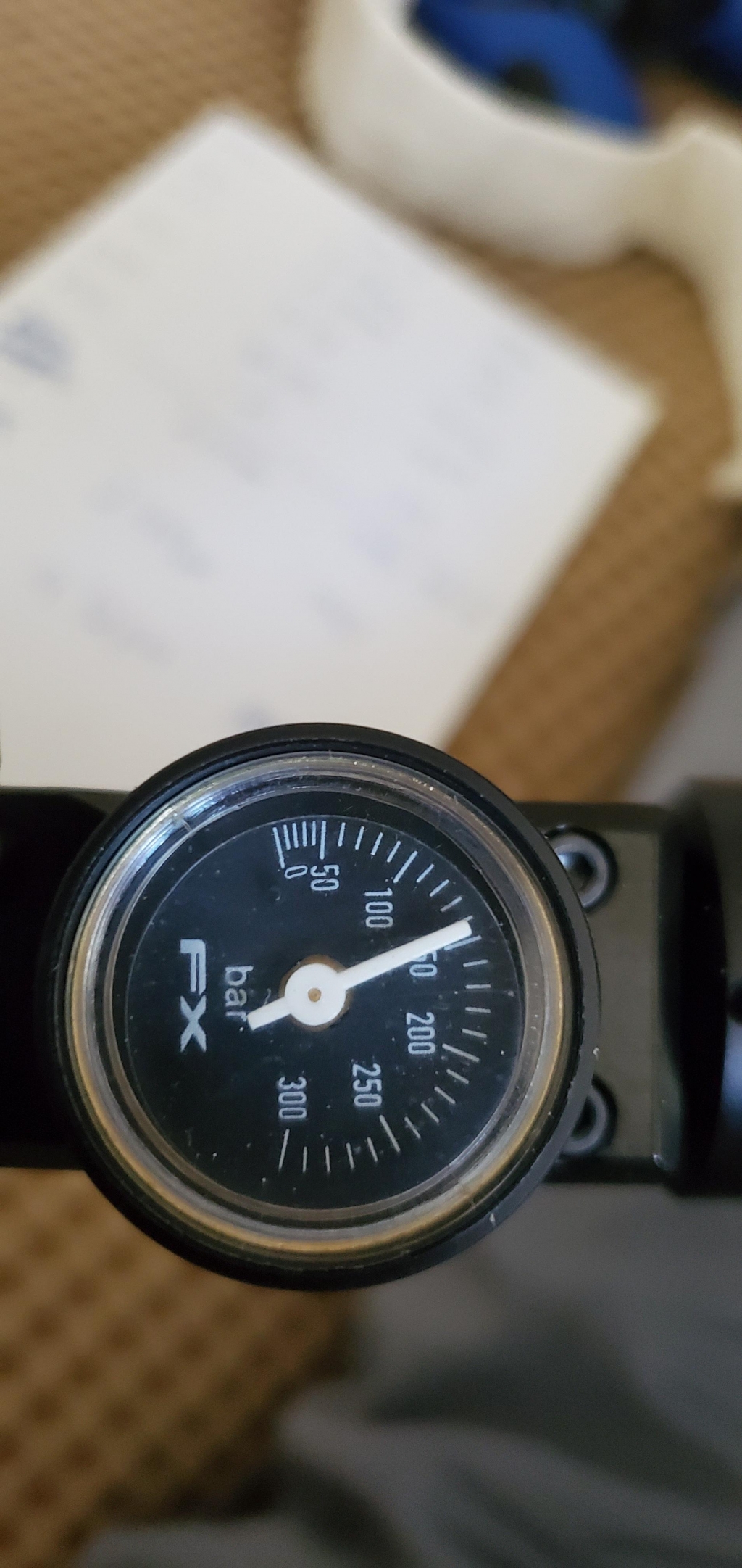

It has been stuck @250 Bar all night Sat.13 till now Sun. 14th
So I will monitor it and let you all know but so far its holding perfect.
