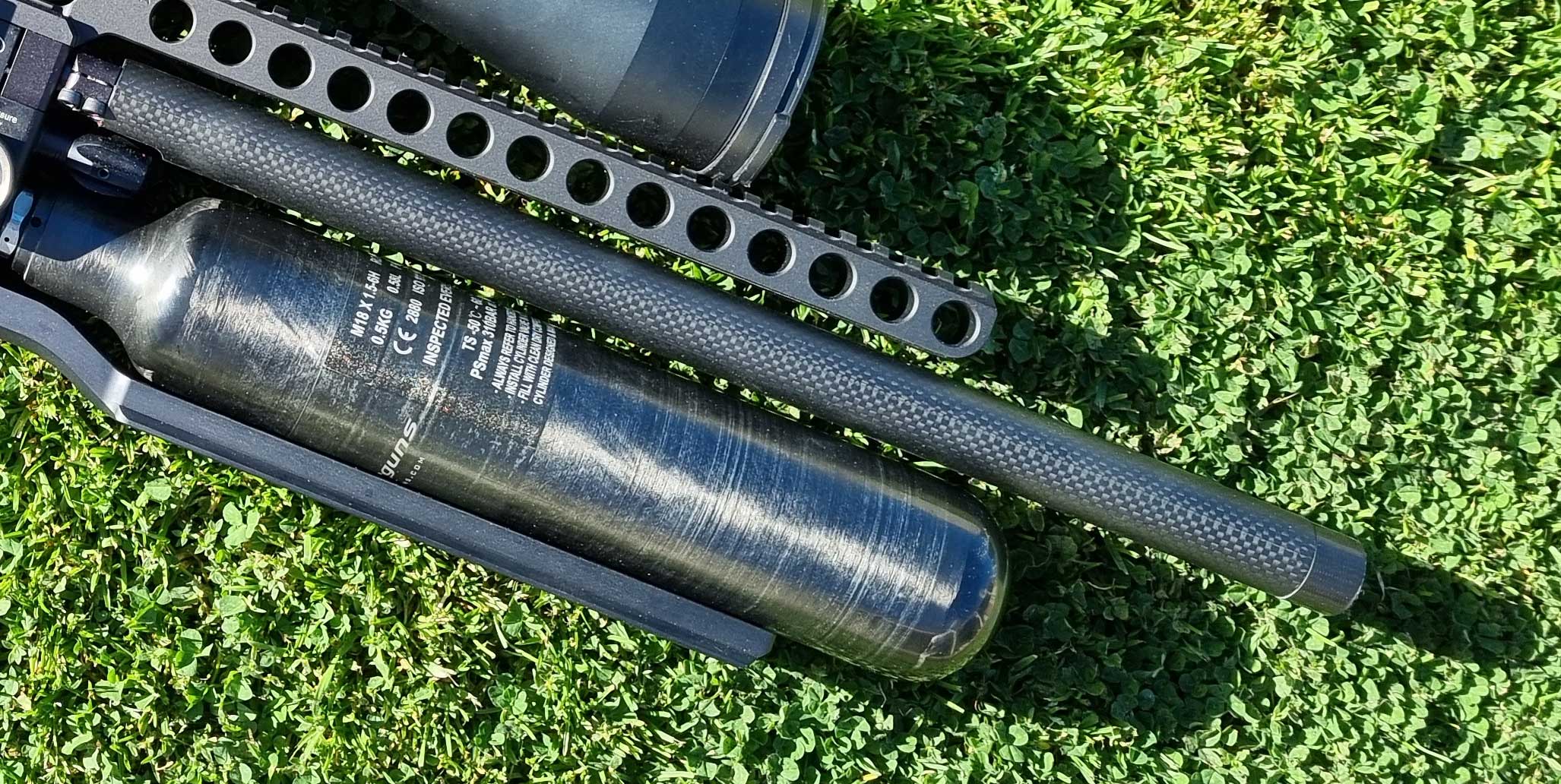

What kind of epoxy did you use?I initially fitted the tensioner kit with just the inner carbon sleeve and tensioning up the barrel nut as per the norm. The results were terrible. It did help a little with accuracy but POI changes were worse than the STD setup...and that's saying something.
I ended up bonding the FX liner and inner carbon tube permanently to the steel barrel tube. I then got a piece of 25mm OD heavy wall carbon tube, machined some spacers . This assembly was placed over the 20mm carbon tube that comes with the FX Tensioning kit.
Again this was bonded permanently in place . the whole barrel assembly is now effectively one piece.
When i install it i just slide the assembly into the frame until it bottoms on the barrel clamp forward of the reciever....NO tension .

I will say again ...its been a massive improvement over the stock setup !!

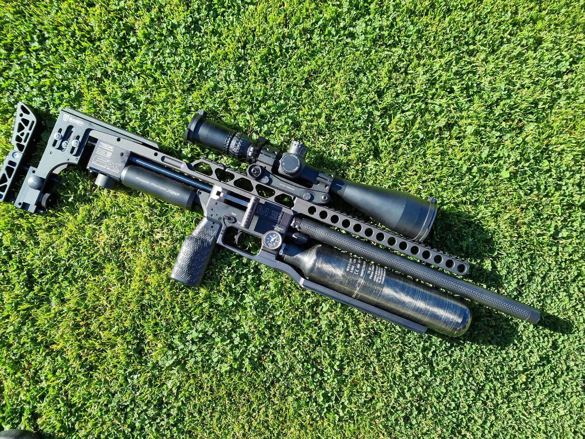

I put my barrel shroud back over the barrel tension tubeHi everybody.
Recently i installed a installed a 700mm fx tension kit onto my .25 M3, not so much to see if i can increase accuracy as its already quite good but moreover to see if i can eliminate POI shift ( jury is still out on that one !).
Obviously removing the fx factory shroud and replacing it with the carbon fibre shroud and jam nut has ment that there is quite a increase in muzzle report as my current tune is pushing 41g slugs at 960fps ( some 80 odd ftlbs) and my 0DB sound mod is not coping very well. Has anyone else experienced this ? Im thinking of putting a carbon fibre tube cut to the appropriate and sliding that over the barrel tension tube to see if that soaks up any of the sound, next will be seeing about a different sound moderator, maybe a donny fl Ronin or something else.
