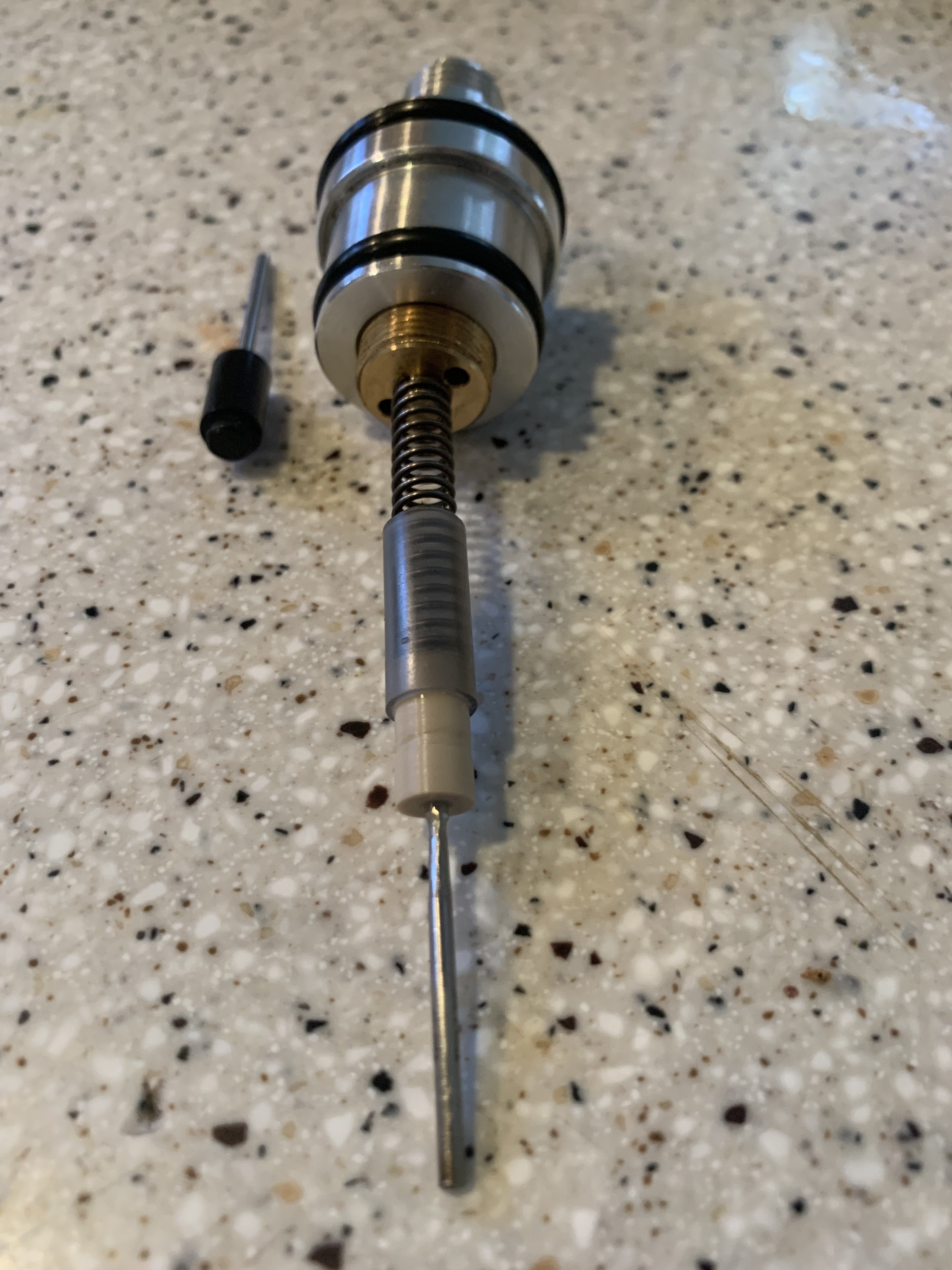

Does anyone know the size and thread type of the adjustment screw in the AMP regulator? I’d like to polish the mating portion of the screw to reduce any creep. I’m trying to make a jig that the adjustment screw would go into ( kinda like a bolt and screw) that would allow me to polish the head better.
Anyone know the screw size and thread type.?

Simply using a leather strop with some green diamond embedded works wonders on the brass and the Deron, then finish on a plain strop

Yup! Haven’t polished the delrin yet!

I bought a leather “wheel” for my grinder like the one “Shooting with Phil” suggests. The issue is holding the adjustment screw while using the leather wheel. It gets hot quickly and is so small it is hard to handle in my stubby fingers!
My “jig” will be a bolt attached to a connector with the same threads as the adjustment screw, which will go into the other end of the connector. Biggest issue is finding a 5mm, 0.5 thread bolt and connector. Lots of places have 5mm, 0.8 thread.

That's why you do it by hand. It's the Delrin that wears a hole, depression BUT...honeslty I'm not sure it matters, just seals better. The brass won't wear, the Ti IMHO is a gimmick and a certified beech to machine.

Sorry, I’m confused. I was aware the delrin deforms some but are you saying the brass adjustment screw is not the problem and causes the creep? Cuz I’ve been polishing the screw not the delrin. I’ll polish the delrin as soon as I hear back from you.

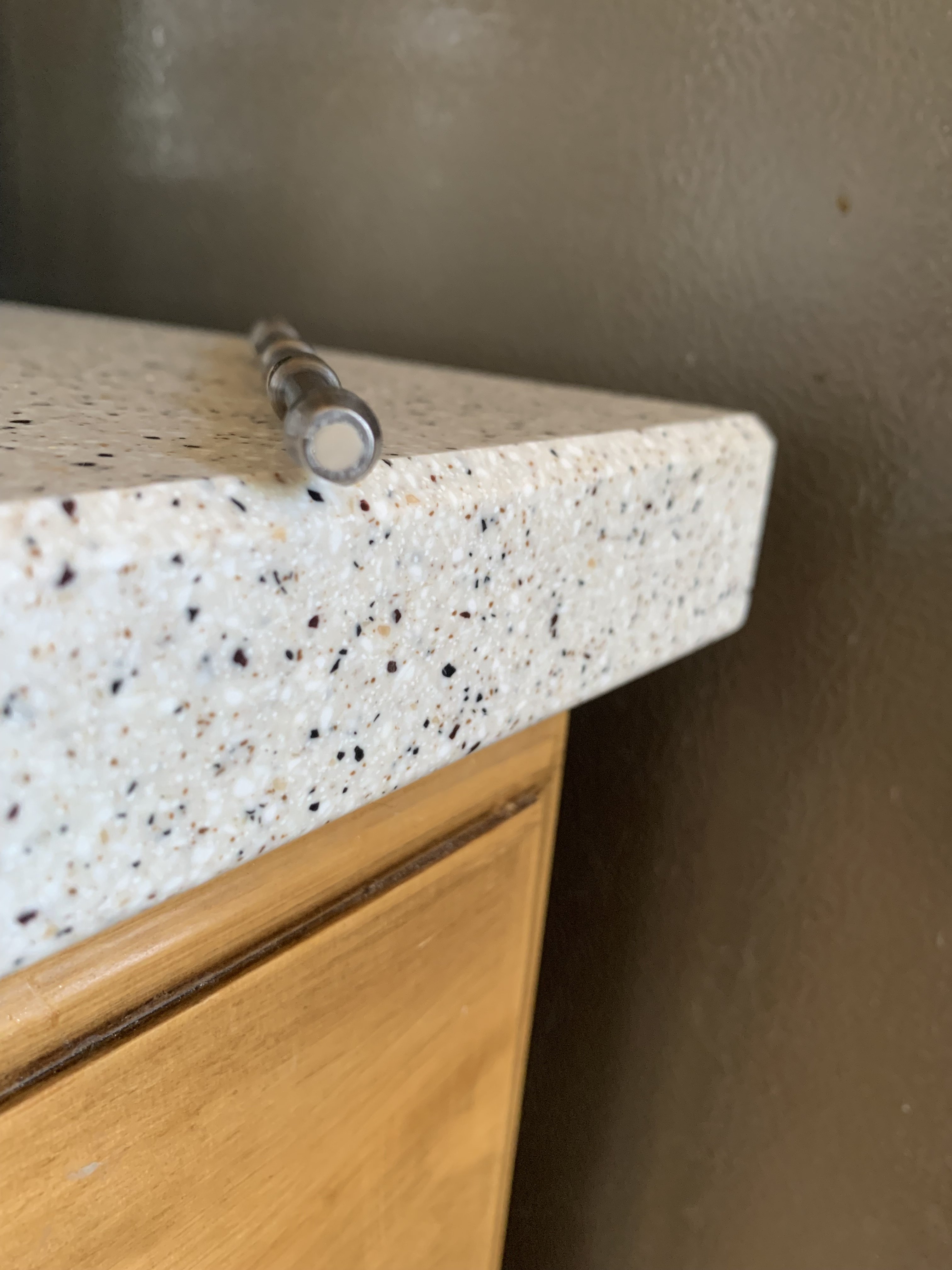

You have to do both, both need a slight dome. I helped a guy with his M3, the delrin was concave, luckily I had some spares laying around, hey it's FX you need spare parts. I sharpen things, kitchen knives, scissors, Katanas....I thought I try the little reg part on my 12" strop, worked like a champ, the untreated side put a heck of a finish on it. In a previous life I made things smooth/flat/shiny or round and shiny. A simple figure eight, rotate it every so often. Today's pro tip, put the adjuster in upside down in the top of the body that holds it, makes it easier to hold. The brass pistons with the delrin are cool BUT I got a few where the delrin was out a bit too far, about 1mm or so too much needs to be .5mm or slightly less above the brass, I'd say .2mm or .010".

Get yourself a loupe and check both. The delrin will be it 90% of the time, but the brass can also have defects from the factory etc.
Got one……30/60, just never looked at the Delrin on the piston before. Dumb me!!!
The brass looks great. Especially made sure the very tip, where the hole is, was a “flat” surface without scratches. I don’t get much creep, 3-4 bar but that sure makes first shot’s noisy and fast!
