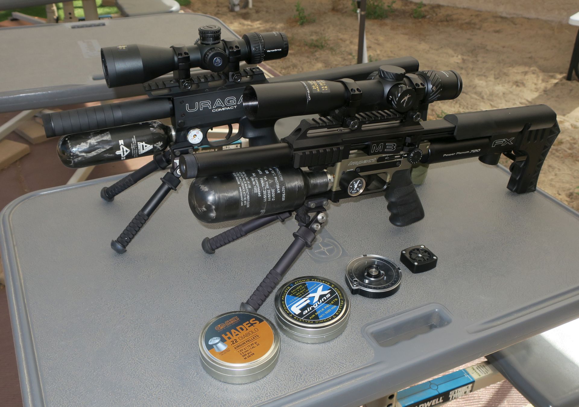

For those who are interested, I tested the Hades and Atomic pellets in .22 cal this morning in my top 2 compact hunter guns tuned for Hades/15.89's. Impact M3 compact (tuned 855 fps) and Uragan compact (809 fps, haven't tuned it from its 'as received' state, used from AoA). Guns started out filled to my normal working pressure fill: 230 bar for M3 and 250 bar for Uragan. 3 consecutive 5-shot groups from each gun at 25 yards. Fed from magazine for both guns. Front bipod and rear small bag - I don't normally use these guns on a bag in the field, but I felt that rear bag might be steadier for pellet accuracy testing. Winds - very light breeze, negligible.

Set up and target in pics below. Both Hades and Atomic in my eyes are good to go.
