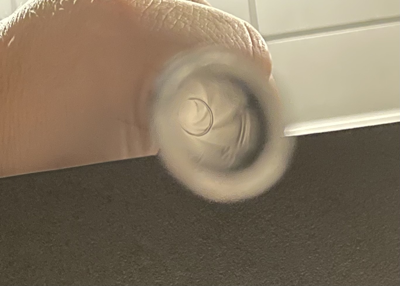

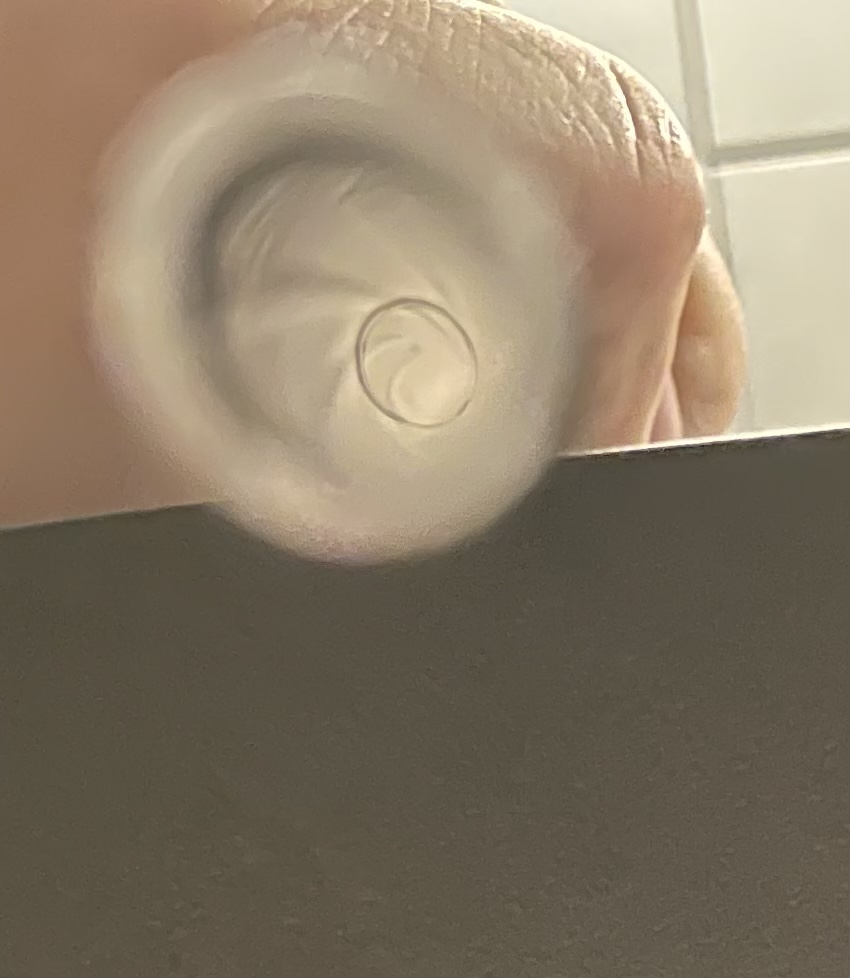

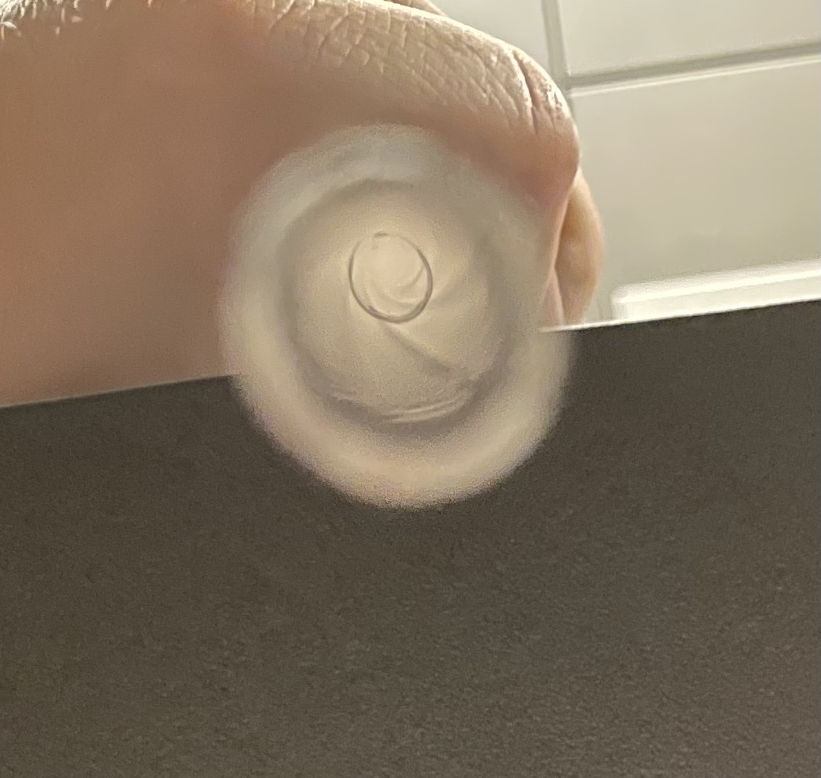

hello, I have a fx maverick .25. I was cleaning my barrel and noticed that in the final third of the barrel there are two lines inside the barrel, looking like a splice. this is normal?

Hello Sir,
Thank you for reaching out to us.
This does look like something that would need to be inspected.
We do recommend that you reach out to your nearest dealer.
Unfortunately, we do not have the ability to have your rifle or liner to come in as we do not ship outside of the USA.
