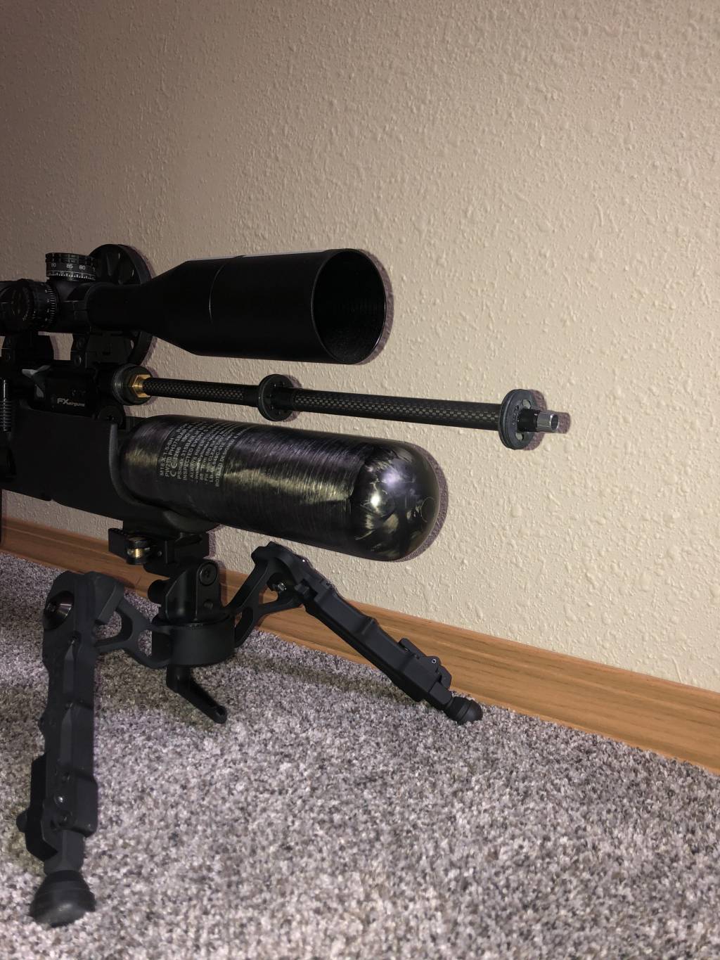

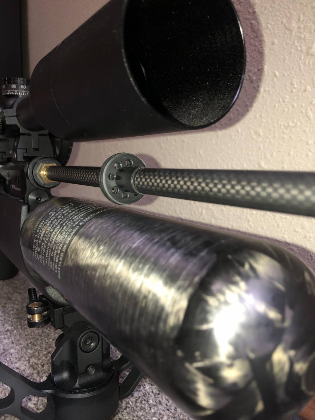

I just glued my carbon sleeve from 910 Airguns. My sleeve slid on without much resistance. I don’t think it would have done much without glueing it.
We all know these FX liner tolerances are all over the place.😁. I think it would need to be a pretty tight fit to not need glue/epoxy of some sort. It also my depend on weather or not it’s being tensioned. I wonder how much it effects the harmonics glue vs no glue.

I put in my liner from Ernest it fits the outer tube real snug and has a ton of room around the liner which it would be hard to glue it to the liner and get it straight I think it is made to keep you from compressing the liner with the front screw that locks liner in place left mine unglued and also tensioned the system with a space against the frame and shroud and hand tightened it pretty dang tight for my 22 made the spacer so it will fit and tension my 25 cal barrel kit as well waiting on my carbon fiber sleeve from 910 for the 25 cal yet
