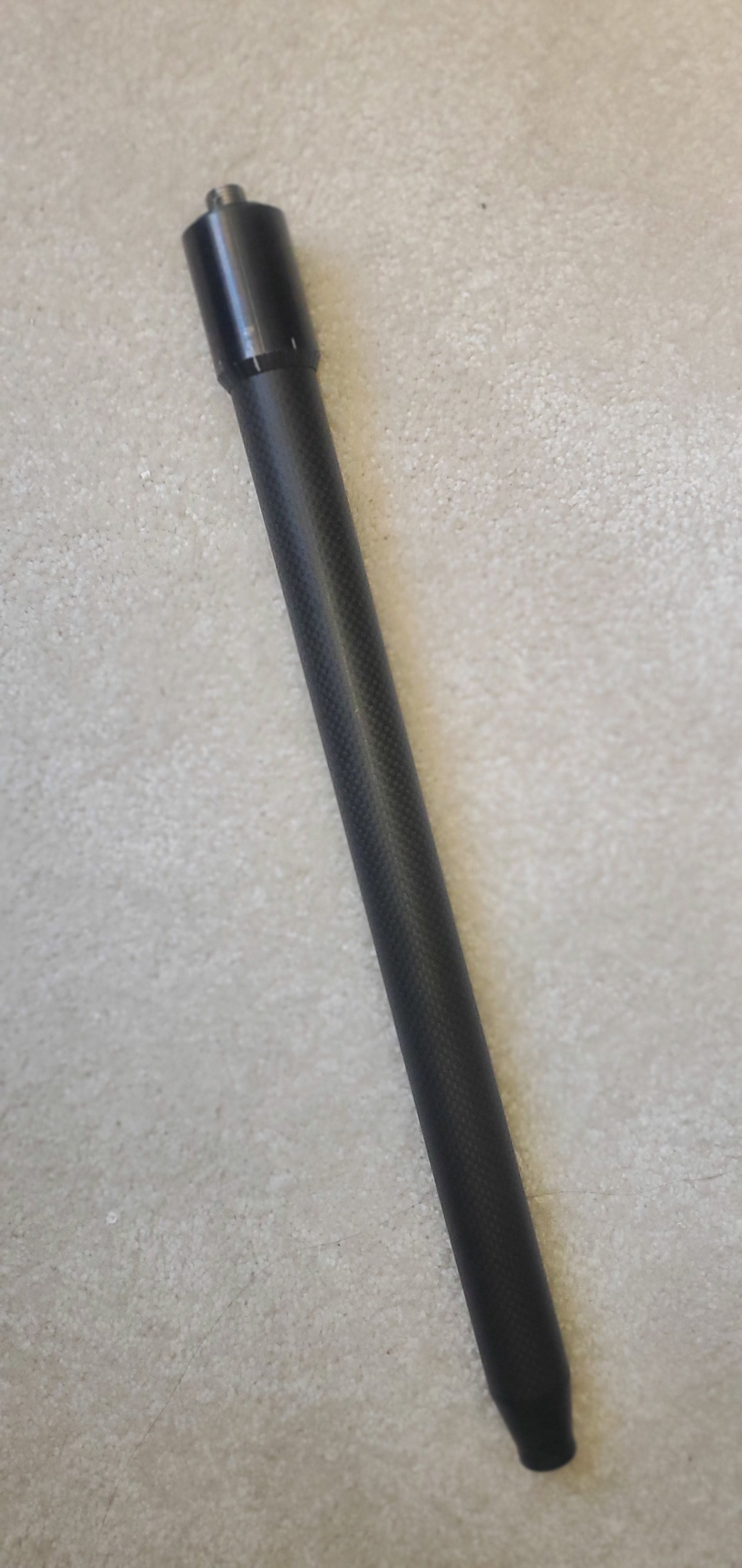

What everyone has mentioned is true. it replaces the shroud.

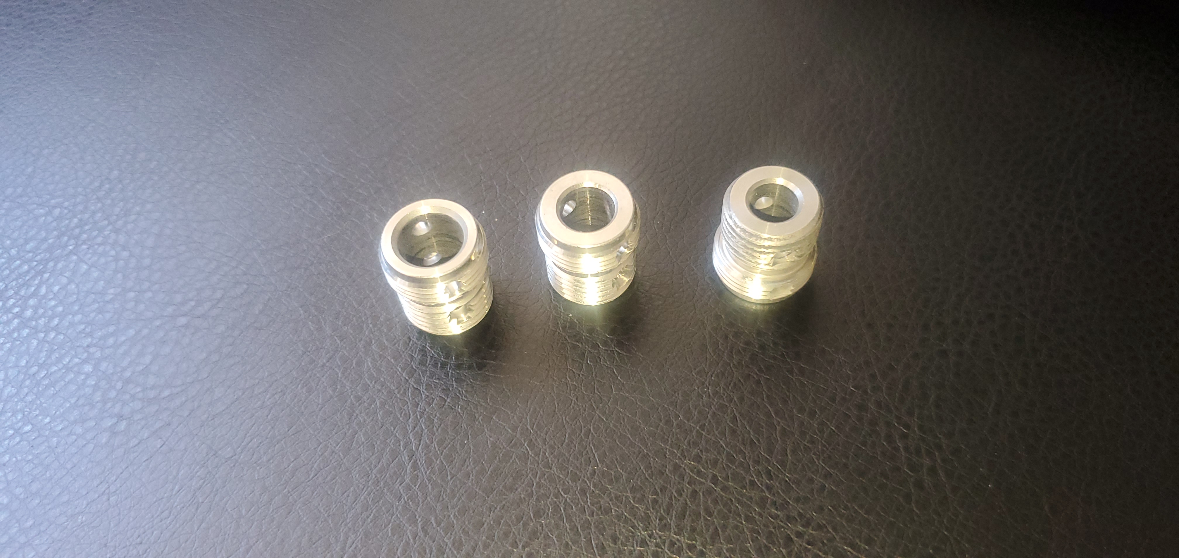

It comes with inserts for 3 sizes up to .30 when I got mine. .22 and .177 share the same.
Slip and twist on just like the original shroud.
But with the shroud you cannot simply remove the tuner as it is part of the shroud.

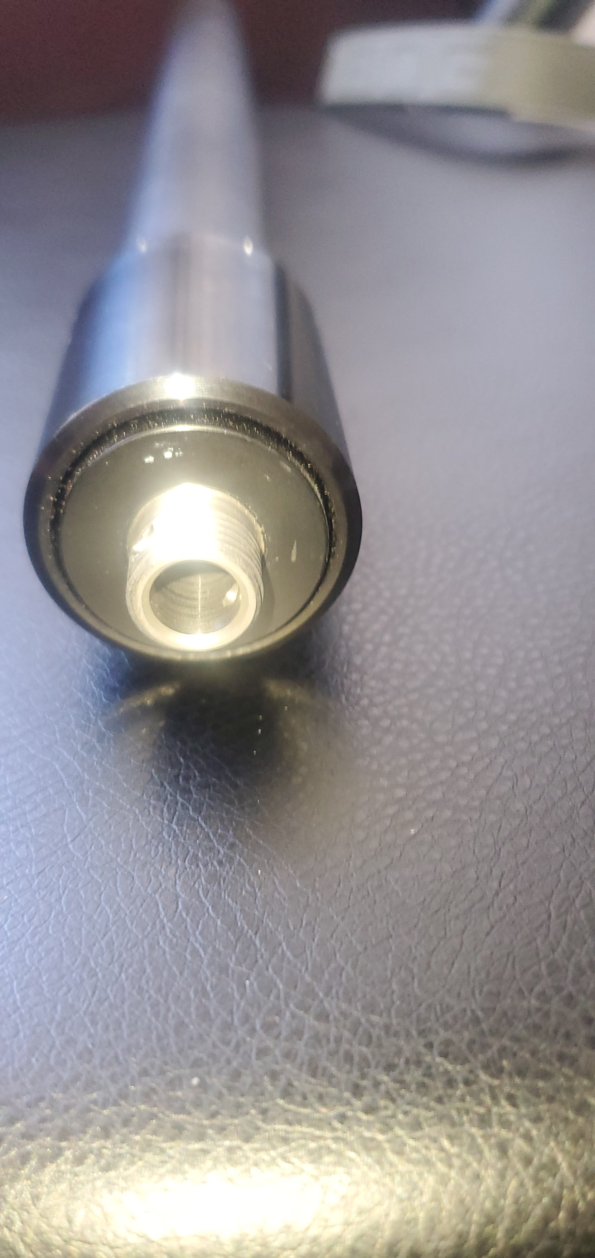

Allen

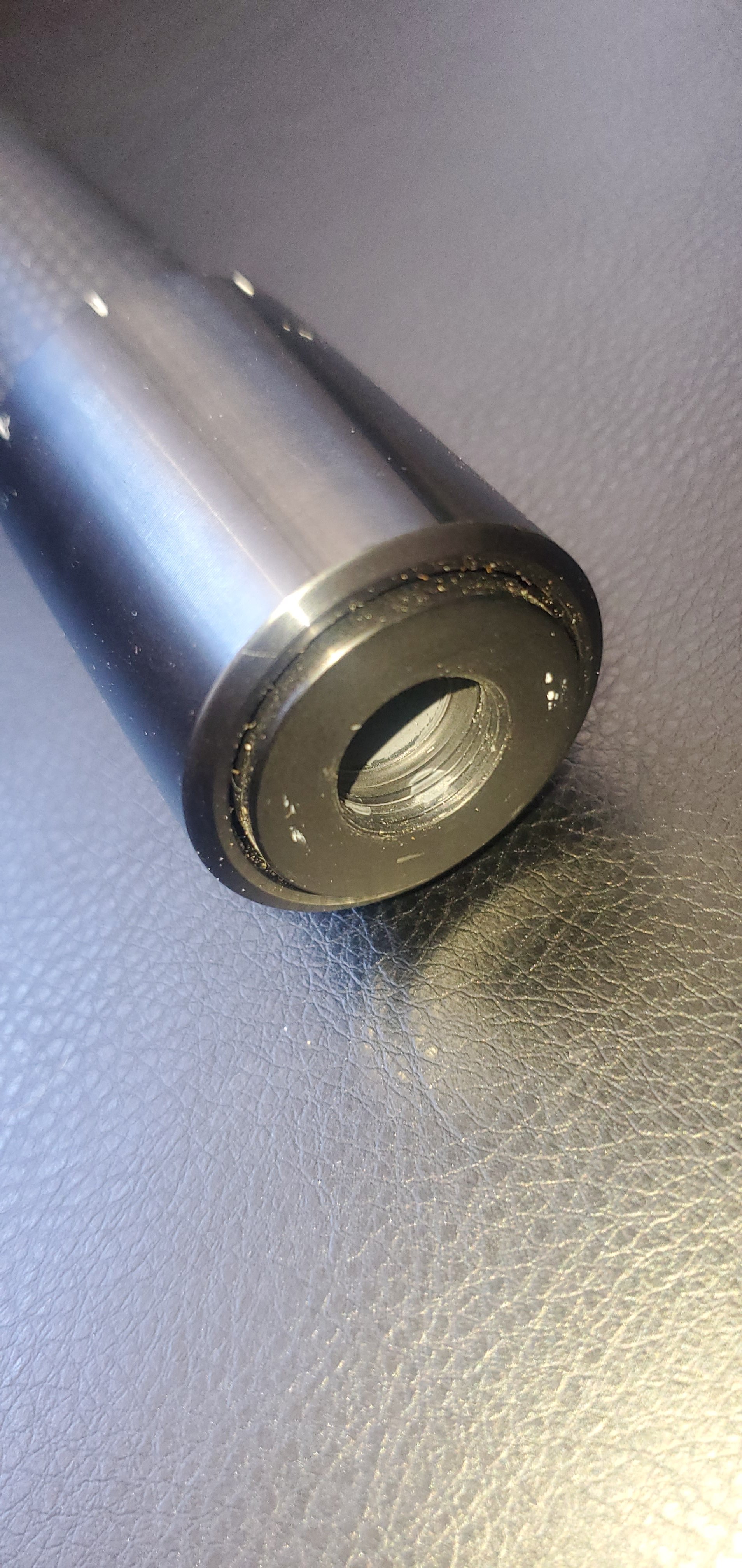

Yes you can remove, I learn it through an accident.
When I received my tuner shroud, the end metal "ring" was stuck, I could not turn it in-or-out.
I called my Dealer and he told me he's was turning but needed to grab it harder....OK, I caled my son for this "two men job" and ended up with a complete metal piece in my hands...
At the factory they were probably gluing in the piece and lean it vertically against the wall and the fresh soft and running glue got in between threads.
I dumped the metal "assembly in acetone for half an hour when it got loose, I grease the thread and the most inner bushing glue bact to shroud with an archery hot melt.
So, it is possible to remove, but please note it was designed for that shroud OD anyway.
