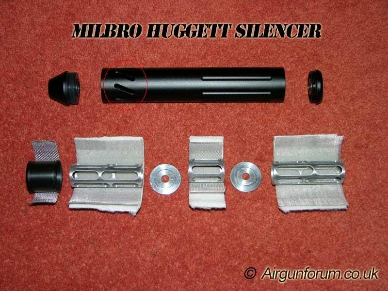

Yes, does look like some Huggett moderators use an internal metal frame, which supports the screen which holds back the sound deadening batting material.
Note: Not my photo - cant take credit for it.
http://i268.photobucket.com/albums/jj18/McHorse/MilbroHuggett-2-1.jpg
The lead dust accumulation seems to be an even playing field for all, but I do get your comment about ease of cleaning. Now my brain is really going into overdrive over the design possibilities.
