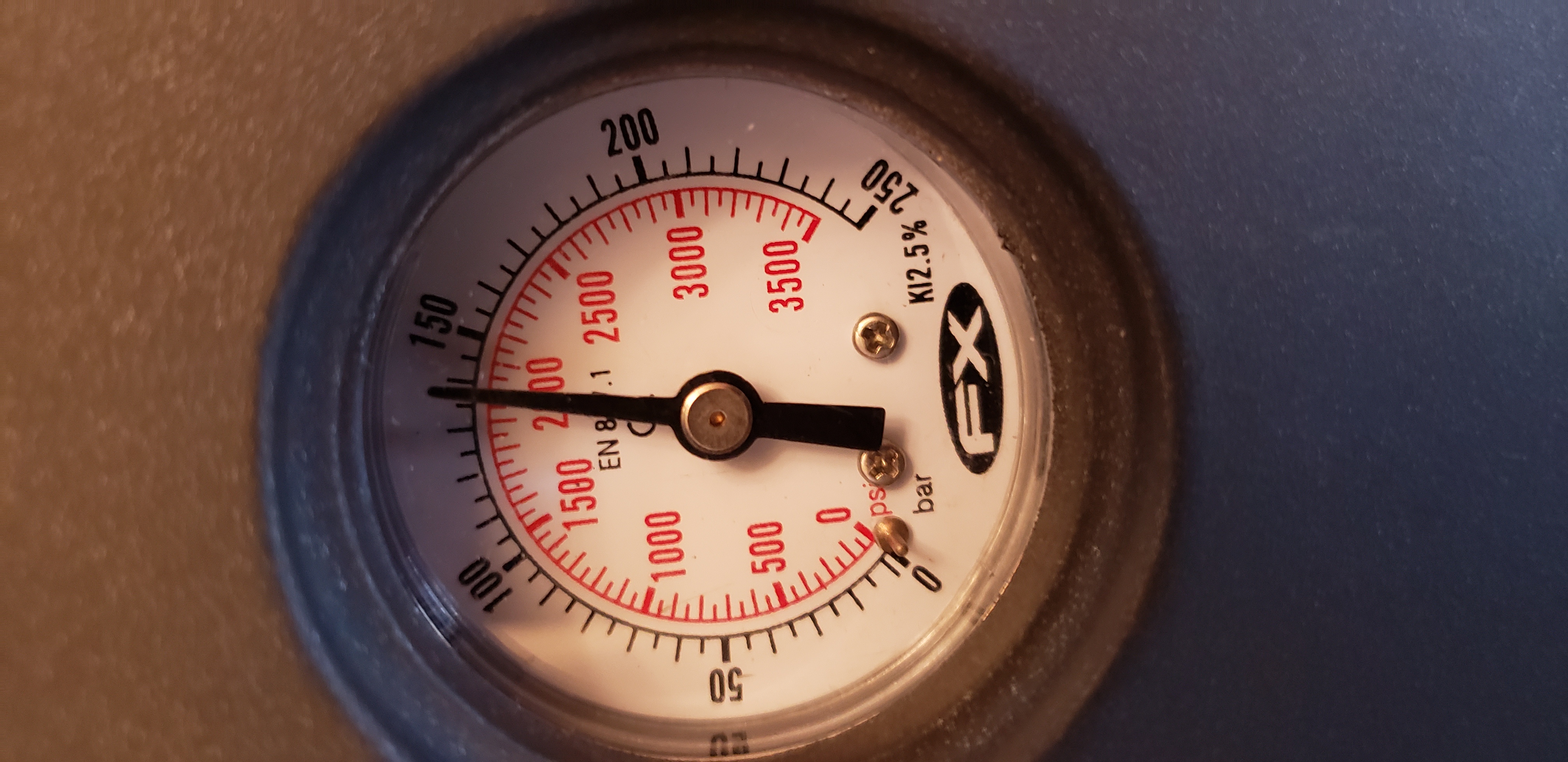

What is the factory regulator setting in bobcat MK2 .25 cal
Reactions: Maarodigro
But mine was 210 bar from factory
But i don't understand that why the fps has no veriation even when the filling guage goes to 160 and 150 bar.
If your supply drop to 160b and 150b, and your reg psg reads 210 after you have shot several shots, I would assume your reg gauge is bad. The reg pressure can't be higher than the supply (tank, tube) pressure especially after you take several shots as I described above.
You can fill your supply tube to 200b and shoot it down until you see a drop off in velocity, assuming you have a chrony to monitor the pellet velocity. Where supply pressure drops in velocity will be a close approximation of what the reg psg (bar) is set. Hope this helps.

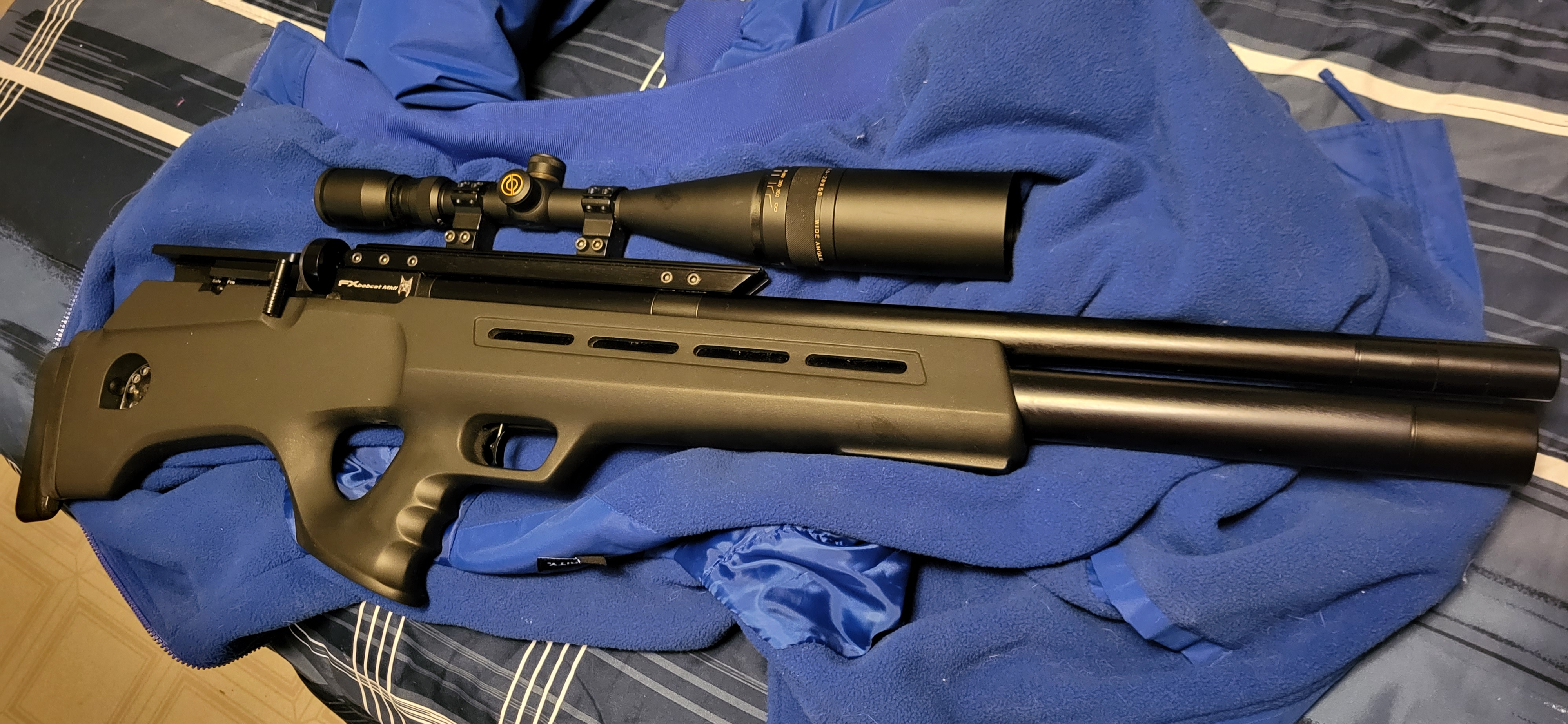

Get some JSB 33.95s, my Mk2 likes them best...I never adjusted my hammer spring much and mine shoots 33s at 775...and does fine at 100 yds...I shoot 25gr on low power mostly. I think 800 to 825 would be easy with the 33s with slight HS adjustment if necessary....I don't mess with mine...I would ignore the reg gauge and just shoot some 33s and see how they work and check your shot count think mine was around 90 out of the box on high. The Bobcat is an EXCELLENT airgun...good luck!
Yes buddy thanks i was also thinking
But can you plz tell me that what should be the maximum power setting of regulator in bobcat.25 cal
Get some JSB 33.95s, my Mk2 likes them best...I never adjusted my hammer spring much and mine shoots 33s at 775...and does fine at 100 yds...I shoot 25gr on low power mostly. I think 800 to 825 would be easy with the 33s with slight HS adjustment if necessary....I don't mess with mine...I would ignore the reg gauge and just shoot some 33s and see how they work and check your shot count think mine was around 90 out of the box on high. The Bobcat is an EXCELLENT airgun...good luck!View attachment 342465
Can i remove the air sylender while it is full of pressure on 200 or 180 bar
Or the OP is mixing up what reg is what reg
