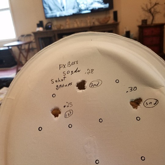

Thanks ! Once I'd got the scope set (Chairgun was a big help in going from 50 yard zero to 100) I just held on target. The variation is greater left-right than up down suggesting that wind may be a factor. Compared to my FT setup I did find 20x to be on the low side, and I guess that with a 30x or greater magnification scope, as well as a shooting rest instead of bags, the groups might get a bit tighter.
Scalf - my groups are much tighter at 50 yds; I never bothered to measure because this is what you expect for this rifle. I'd expect you get pretty decent groups at 75 yds as well?
Our range is limited to 100 yds, but you have access to longer distances. It would be great to see what you can do at 150, 200, or even 300. You would probably need adjustable rings like FX no limit, or Sports Match, because at these longer distances you are going to run out of hold over aim points on most scopes.
Scalf very nice groups. Mine are comparable at 50 yds.
