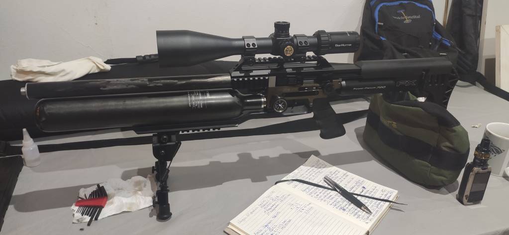

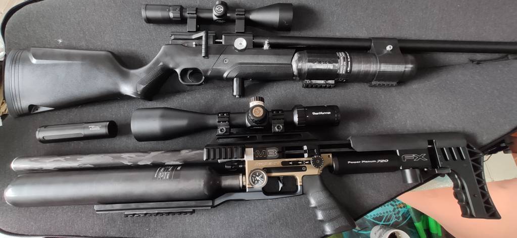

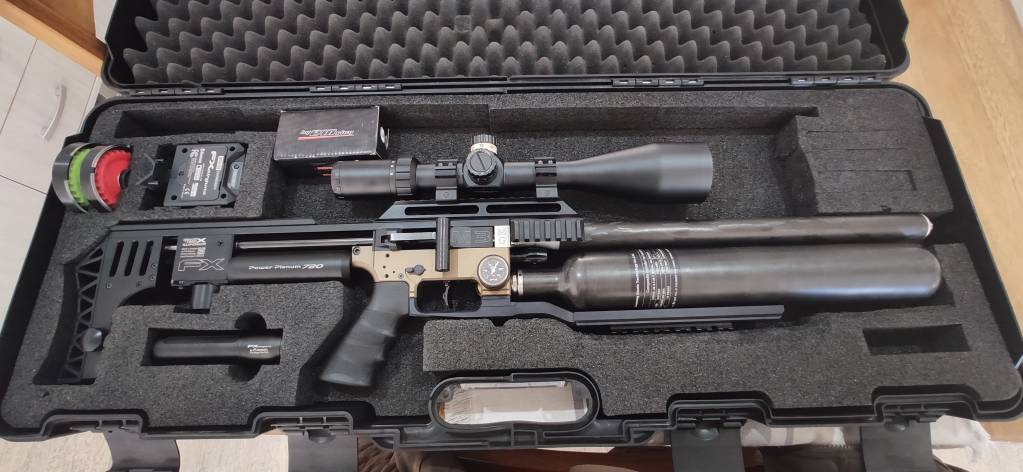

I dont know if this is exactly what you are after for, but its a way to stiffen all the barrel system. I have the FX Carbon Liner tube, a block that grab/tension the whole barrel system (way before Fx release it) and a carbon fiber shroud that is stiffened with the threaded shroud adapter. When you screw the adapter, it pushes the carbon fiber shroud into the bushing between the grab/tensioner system.
