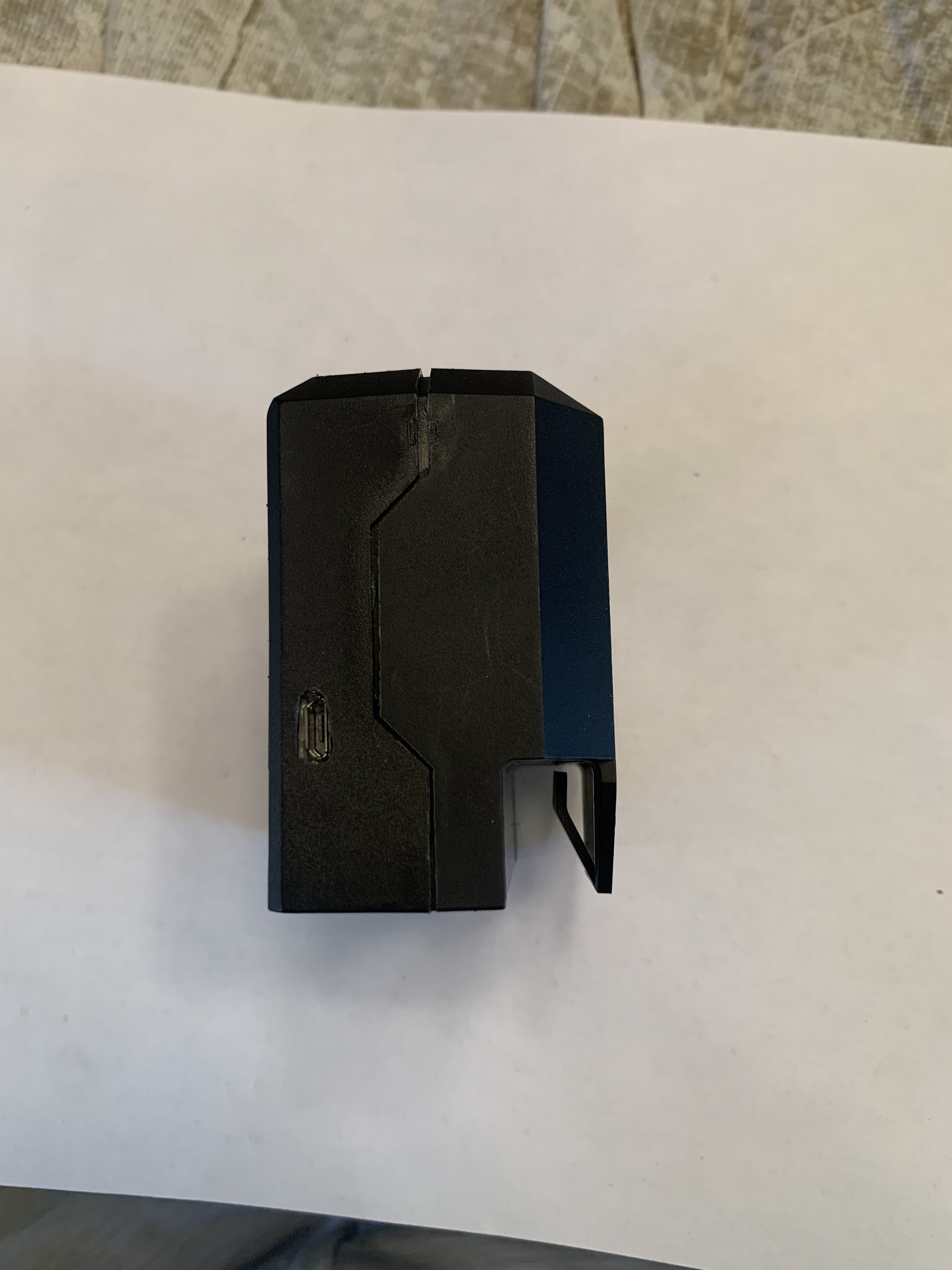

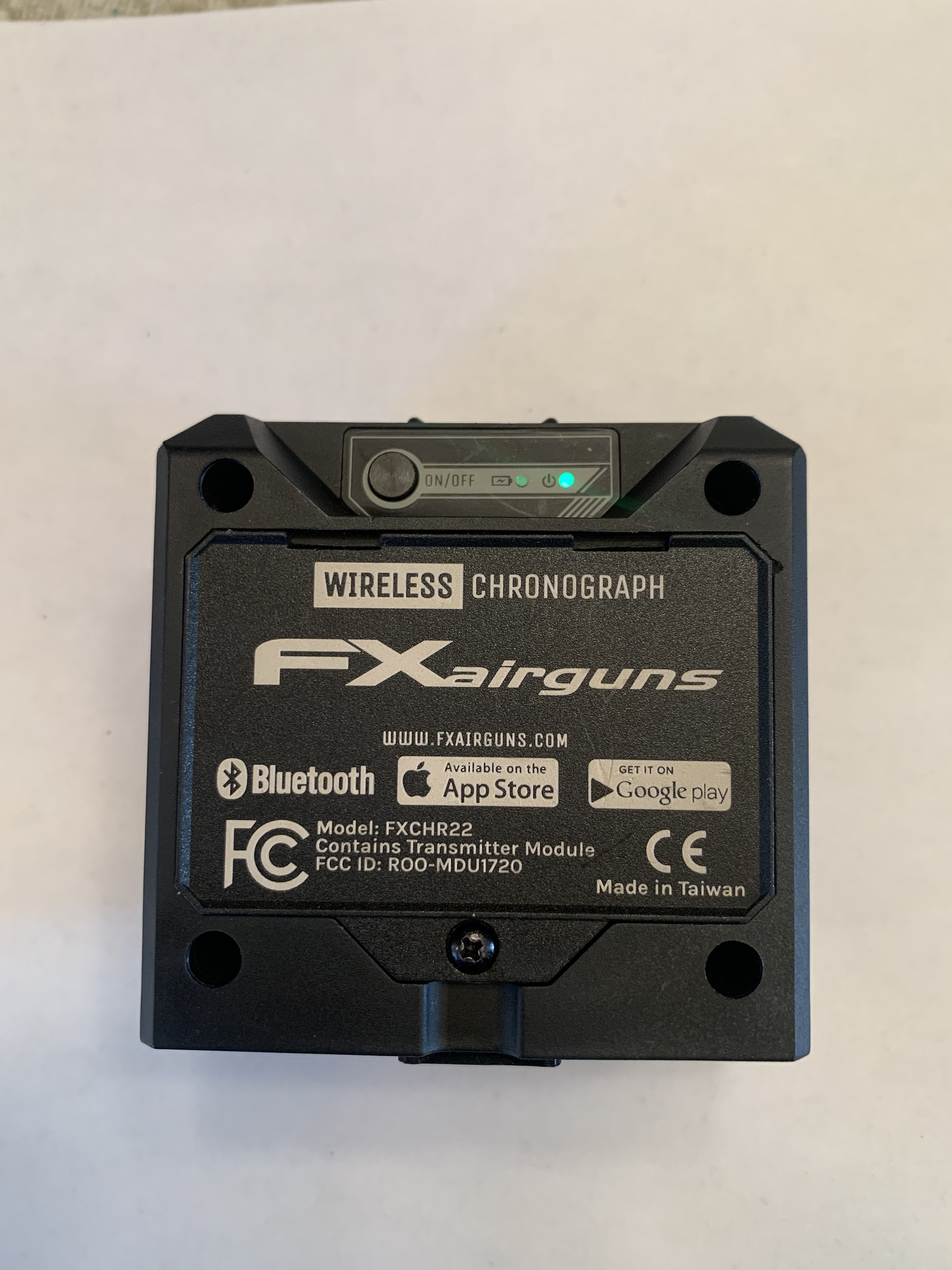

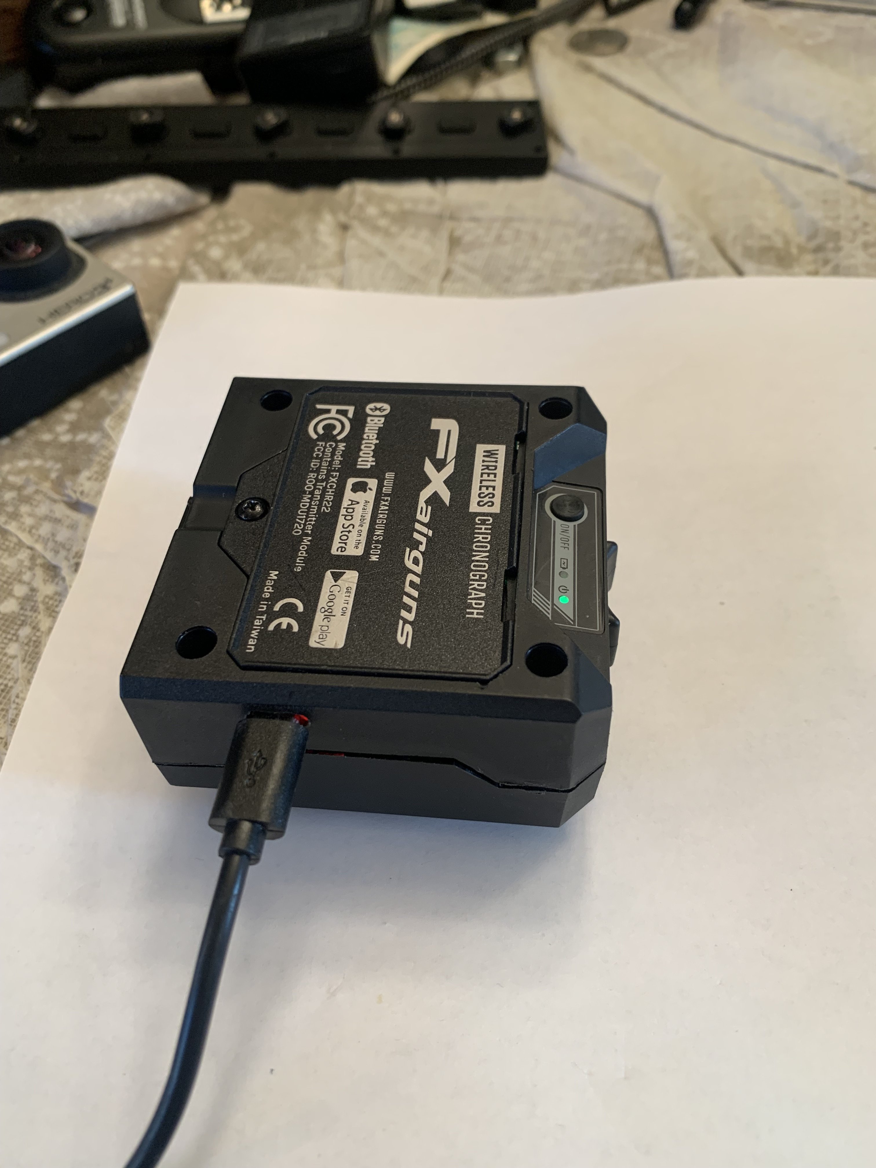

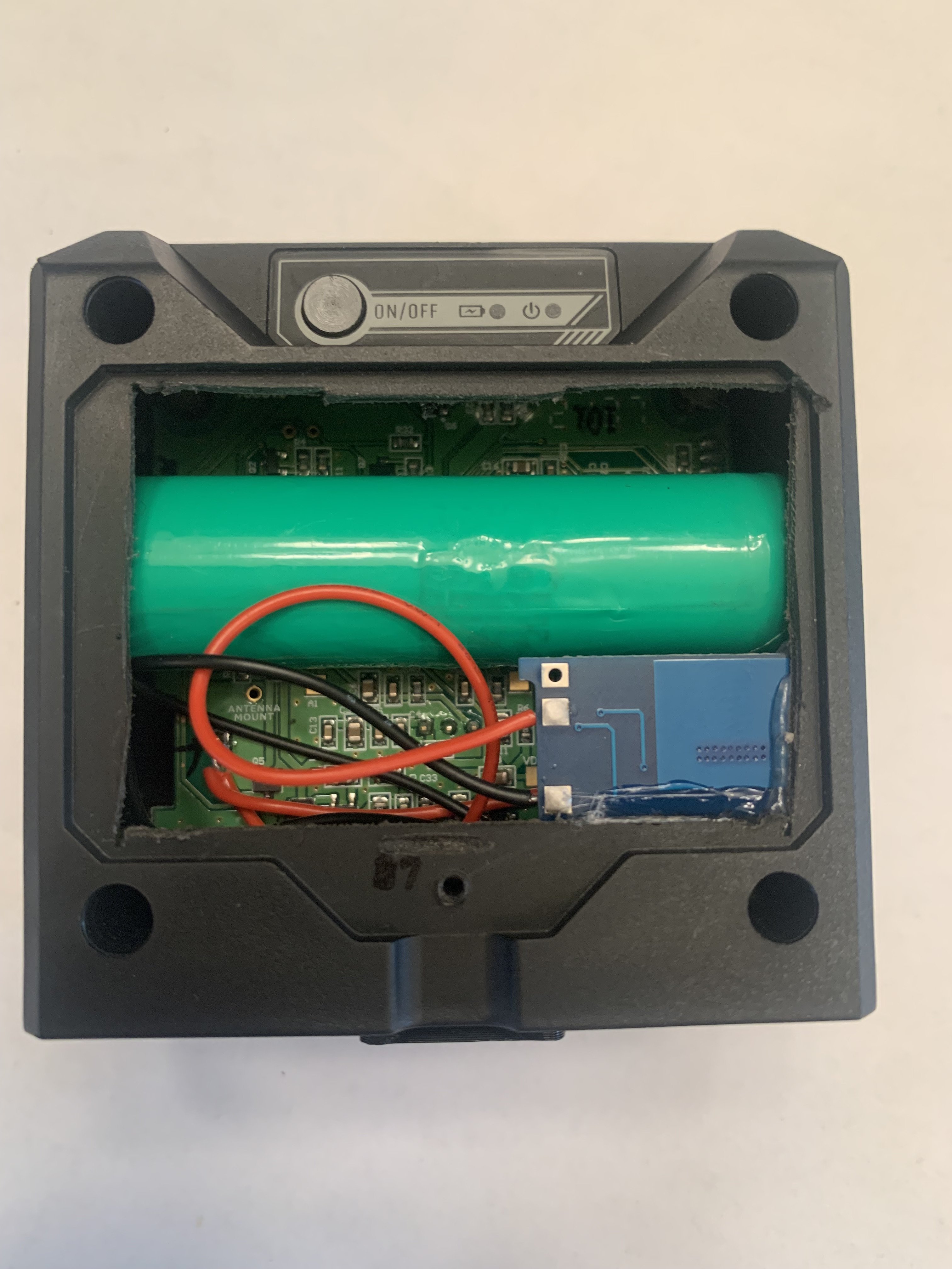

I got tired of forgetting batteries for my FX chronograph, so I made it Reachable. FX should have made it Rechargeable but I'm sure it would cost more . This FX Chronograph eats Duracells, I have to change the batteries after every use. I of course am forgetful and don't turn off the Chronograph, and use it for 2 hours straight. Some times I forget to carry extra batteries around and not to mention the cost of a 4 pack of AAA Duracells, So I made my Chronograph Rechargeable. I used a 18650 battery and added a charging port to the side. The run time is much longer now. About twice as long battery life and fast recharge. Also If I forget to charge it, I can just attach a Micro USB and it will work while its being charged. I can charge it from the car and I can't forget the Car.
Here are some pics of the end result. It was easy to make the changes, but it was time consuming. But now that I know how, it would only take 1 hour at the most.
SKILL LEVEL 3.
TIME 1 Hour
Tools needed.
Dremel and soldering skills.
Also need a Micro USB 4.2v battery Charger.
With the cover back on, you cant even tell anything was changed to the Chronograph. Other than the Micro USB port on the side for charging.
You have to know how to solder and have a Dremel.
If anyone wants to make your chronograph rechargeable Please let me know and I will make a short video on how to do it.

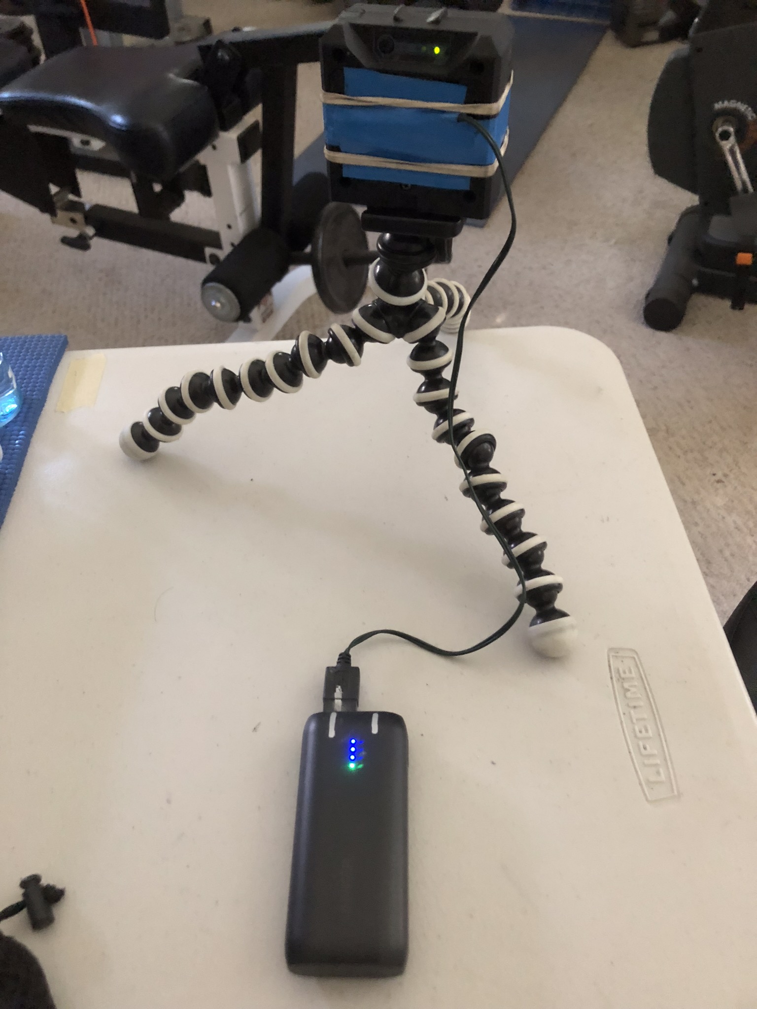

This is how I run my chrony. I bought that three battery wired in series from amazon, it comes with a male usb plug at the end. The cord is substantial, so after I looped the excess neatly and gave myself 6”(story of my life, lol), I taped off the excess to the side of the chrono. To me, it looks like a tool, in which it is.
Here is the batteries in series kit:
The remote battery packs that were designed for emergency cell phone charging is my power source. They last a very long time, easily for two or three range trips. After four hours of having it on it hasn’t used up half of its stored power, maybe only a quarter. Cool thing about this is I can easily go back to standard batteries or if I need to sell it it hasn’t been modified-
Link to cell phone rechargeable battery pack-
