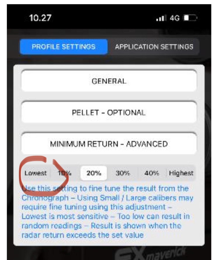

.177 is a small pellet to create a reliable radar echo return. For .177 cal pellets I have the 'Minimum Return' setting sensitivity set at Lowest to capture all the shots. The default 20% assumes an average shooter’s caliber choice which would be larger.
Screen shot from the manual.
I downloaded the app to check it before I purchase but I don't see Minimum return option. Are you sure it is not a screenshot for older Pocket chronograph and not a V2?

I know the .177 pellets much smaller, but a lot of miss-read could be avoided if you have no object around you that creating echo's. And yes, when the radar is powered up (connected to app) you have the option in android app to select the "return".
Reactions: Vlada1911
Oh, didn't know it need to be connected for the "return" option to show up. Thanks! I just downloaded the app to explore before purchase.
