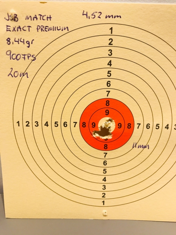

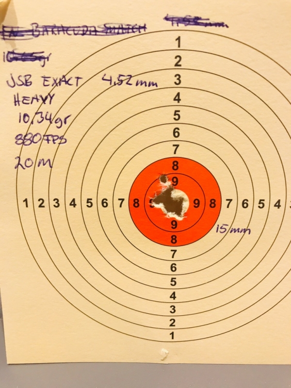

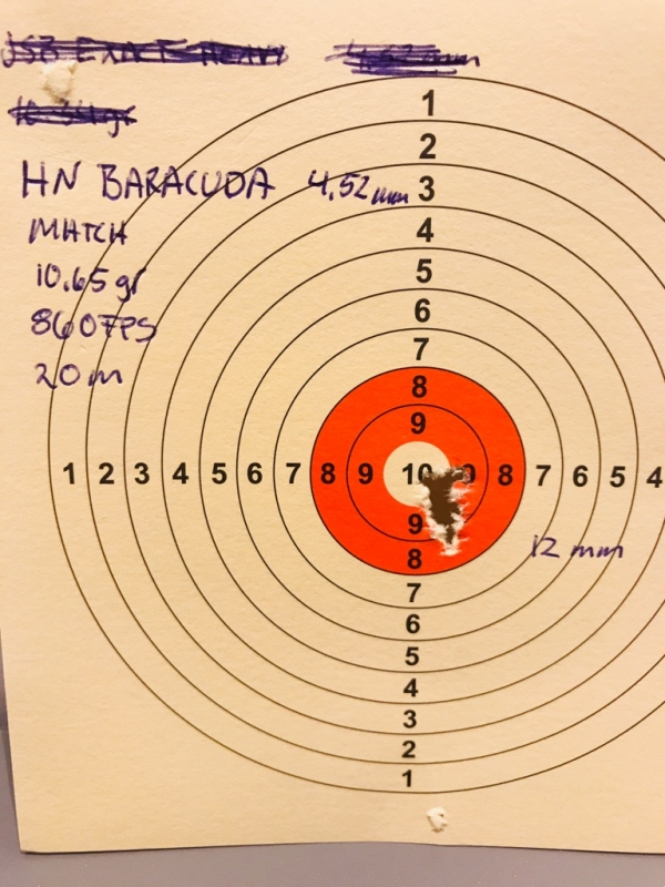

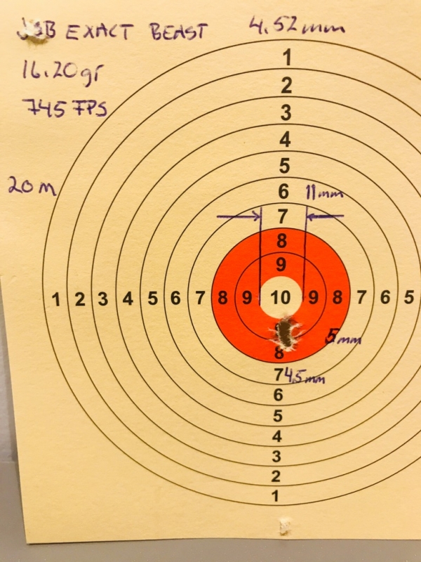

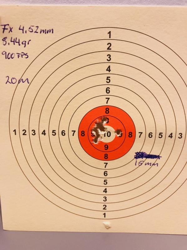

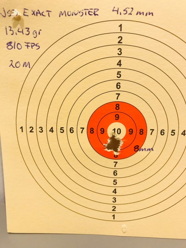

Did som testing with 6 different pellets at 20 and 50 meters. The fps is not optimal for the heavier pellets. But i did not bother to take of the make adjustment at this time. I used the same setting for each pellet on 20 and 50 meters. Center of the targets at 20 meters is 11mm diameter.
Reg. setting: 110 bar. HS: 19,5 mm. 10 shots in each target.
Target nr. 1: FX dome pellet 4,52mm. 8,44gr. 900fps. Poweradjuster (PW)at 3.
Target nr. 2. JSB Match Exact premium 4,52mm, 8,44g. 900fps. PW: 3
Target nr. 3. H&N Baracuda Match 4,52mm. 10,65gr. 860 fps. PW:Max
Target nr. 4. JSB Exact Heavy 4,52 mm. 10,34gr. 880 fps. PW:Max
Target nr. 5. JSB Exact Monster 4,52 mm. 13,43gr. 810 fps. PW: Max.
Target nr. 6. JSB Exact Beast 4,52mm. 16,20 gr. 745 fps. PW: Max
( This is the best this gun have ever shot. Also with these pellets. Have tried them earlier at higher fps but did not get grouping. So to my surprise, at 745 fps they almost group as well as my AA S510).

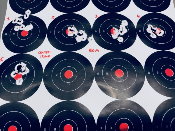

As you will see there is no target picture of these pellets at 50 meters. At this speed they hit all over the place
Same pellets (not the JSB Beast) at 50 meters with same settings on the gun.
Target 1: FX dome pellet 4,52mm. 8,44gr. 900fps. Poweradjuster (PW)at 3.
