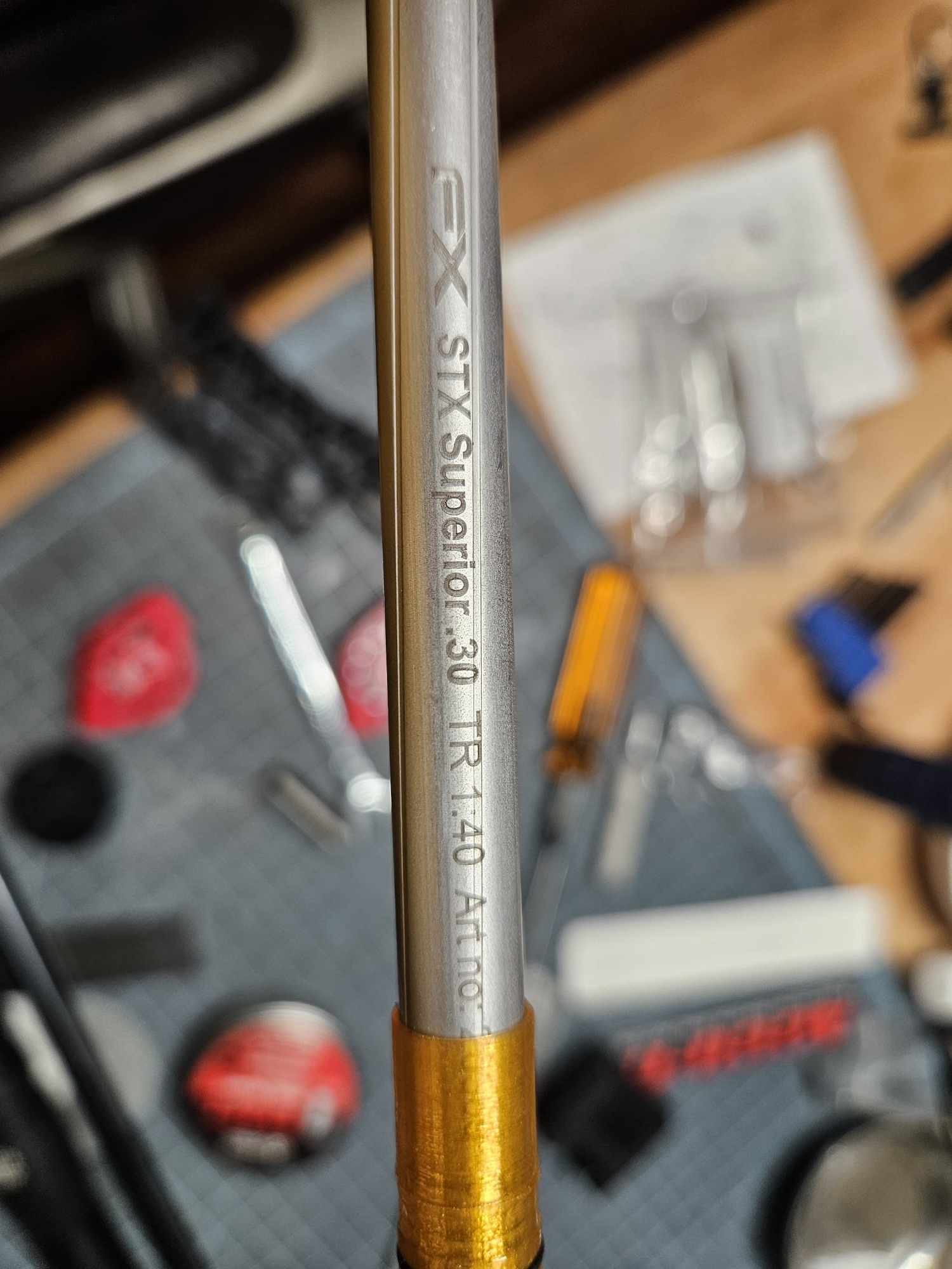

I never tried shooting slugs through my .30 STX superior liner. The twist rate is 1:40 and I'm not even going to bother making the attempt. My guess is your Crown has the same twist rate.

I would've suggested to go ahead and try the superior first too but as soon as I saw it was a 30 500mm with a 1:40 twist I knew he was doomed. It's just too slow of a twist to stabilize a slug.

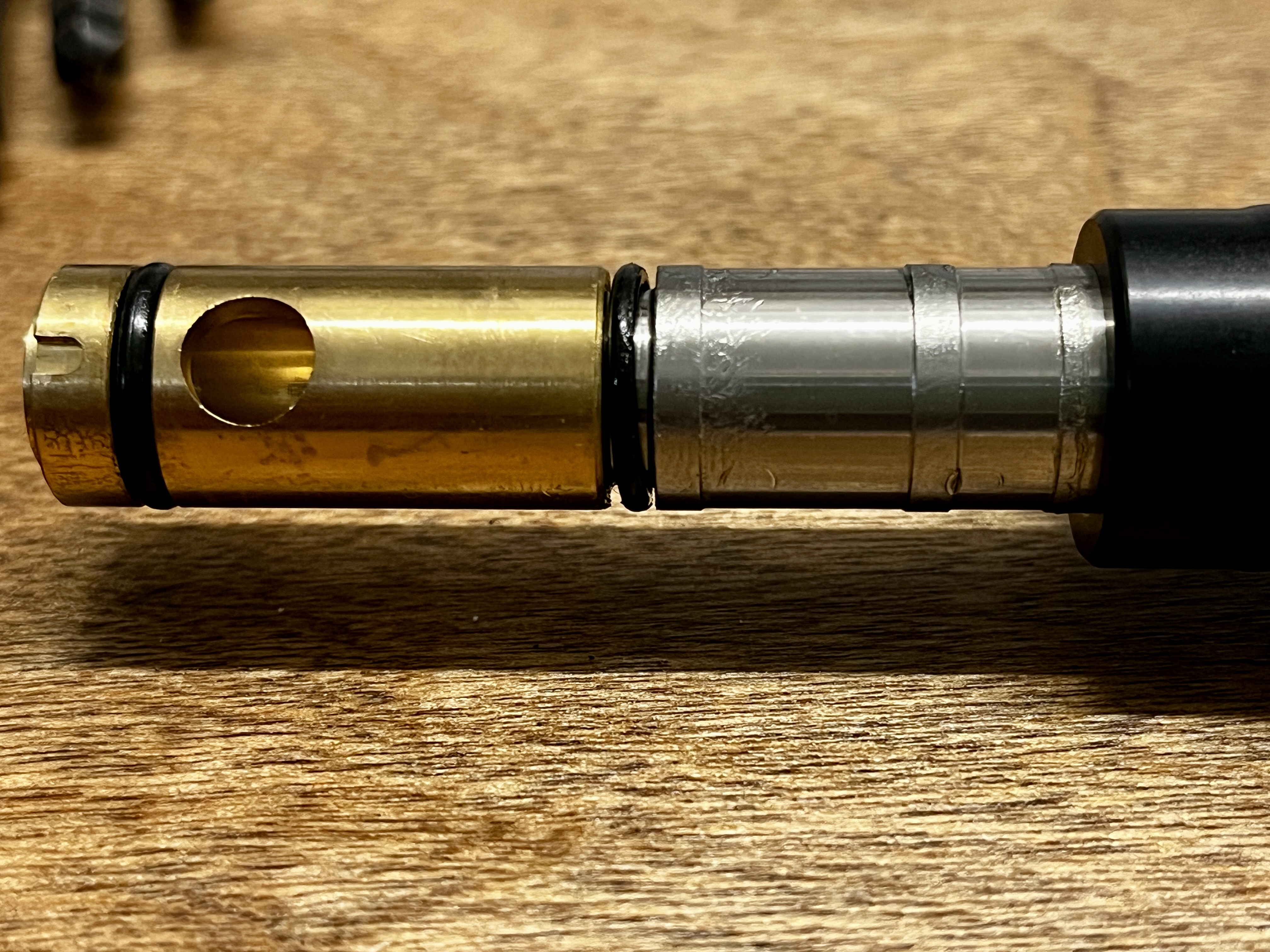

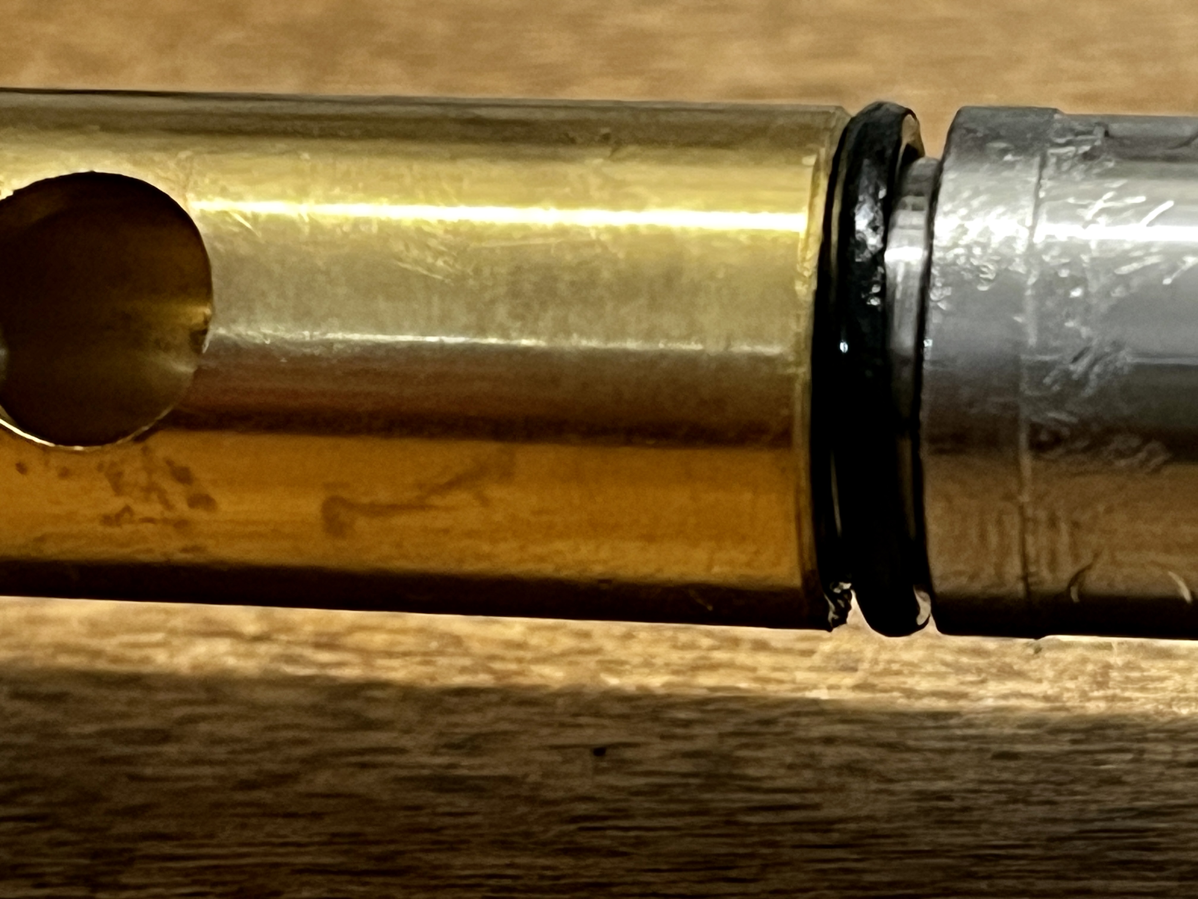

Took my liner out for cleaning, is this gap normal?
O-rings are fine, they are covered in silicone, but they are perfectly fine.
I tried tightening up and it was not going, so I took that brass part off and measured depth of the threads and what you see here is max I can screw it in, that is it, it bottoms out on inside.
I was looking at photos online and I don't see any space on the photos I see, this puzzles me
Thank you
On a 30 that gap is normal and one o ring(furthest from the transfer port) is a different size than the one closest to the TP. On other calibers, both o rings are the same in size. Just the FX 30 cal STX barrels the two o rings differ.

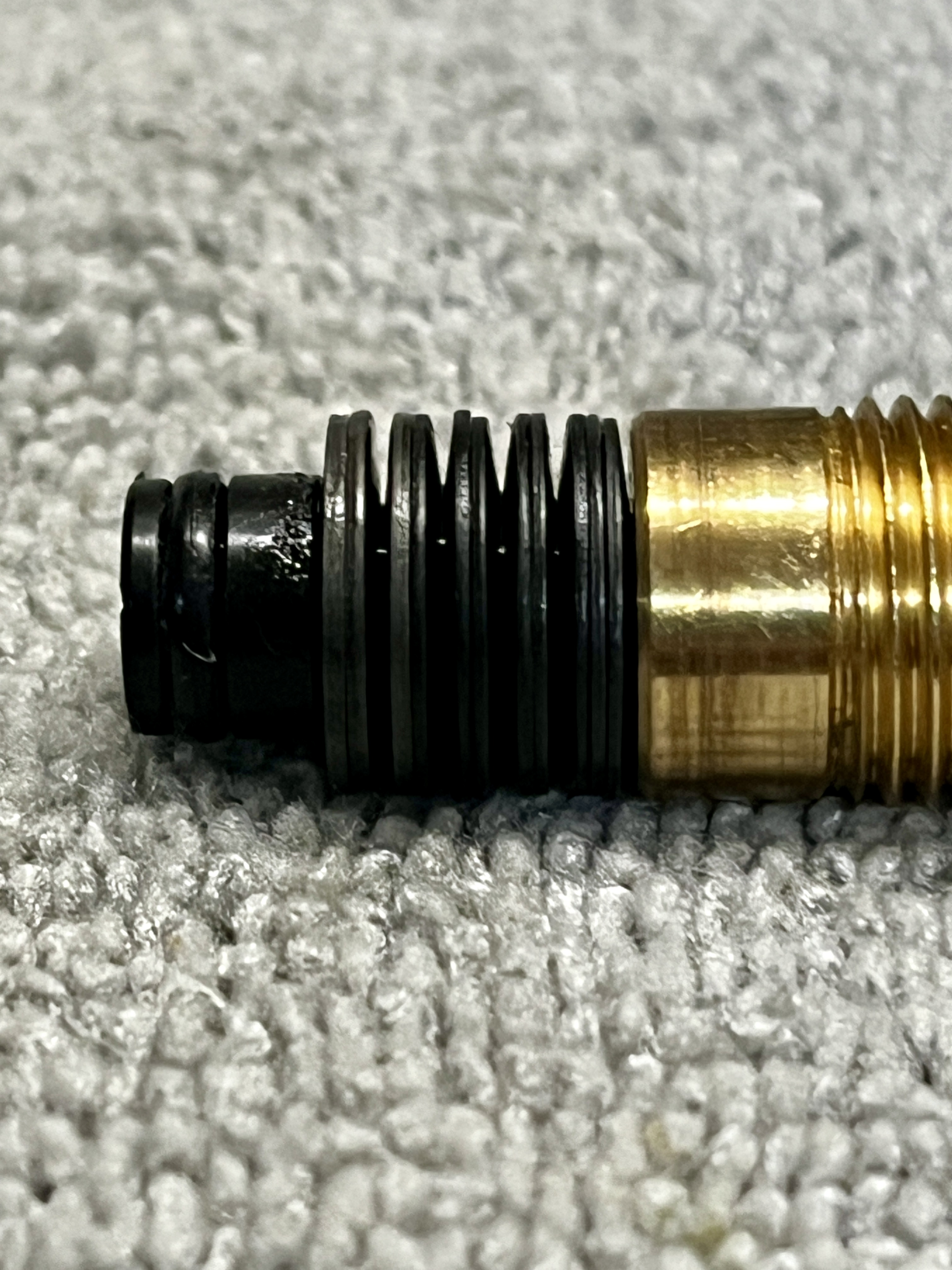

Took a part regulator.
I have about year old FX Crown MK2
Regulator has 11 washers, single paired, last stack towards the end is 3 washers two inward one opposite like this: ()()()()(()
Going to re-stack it, should I get rid of 11th washer and double stack 10 like this: (())(())() ???
or keep 11th and stack like this: (())(())(() ?
Not sure if 11th was a mistake and I need to get rid of it or keep it.
Please advise.

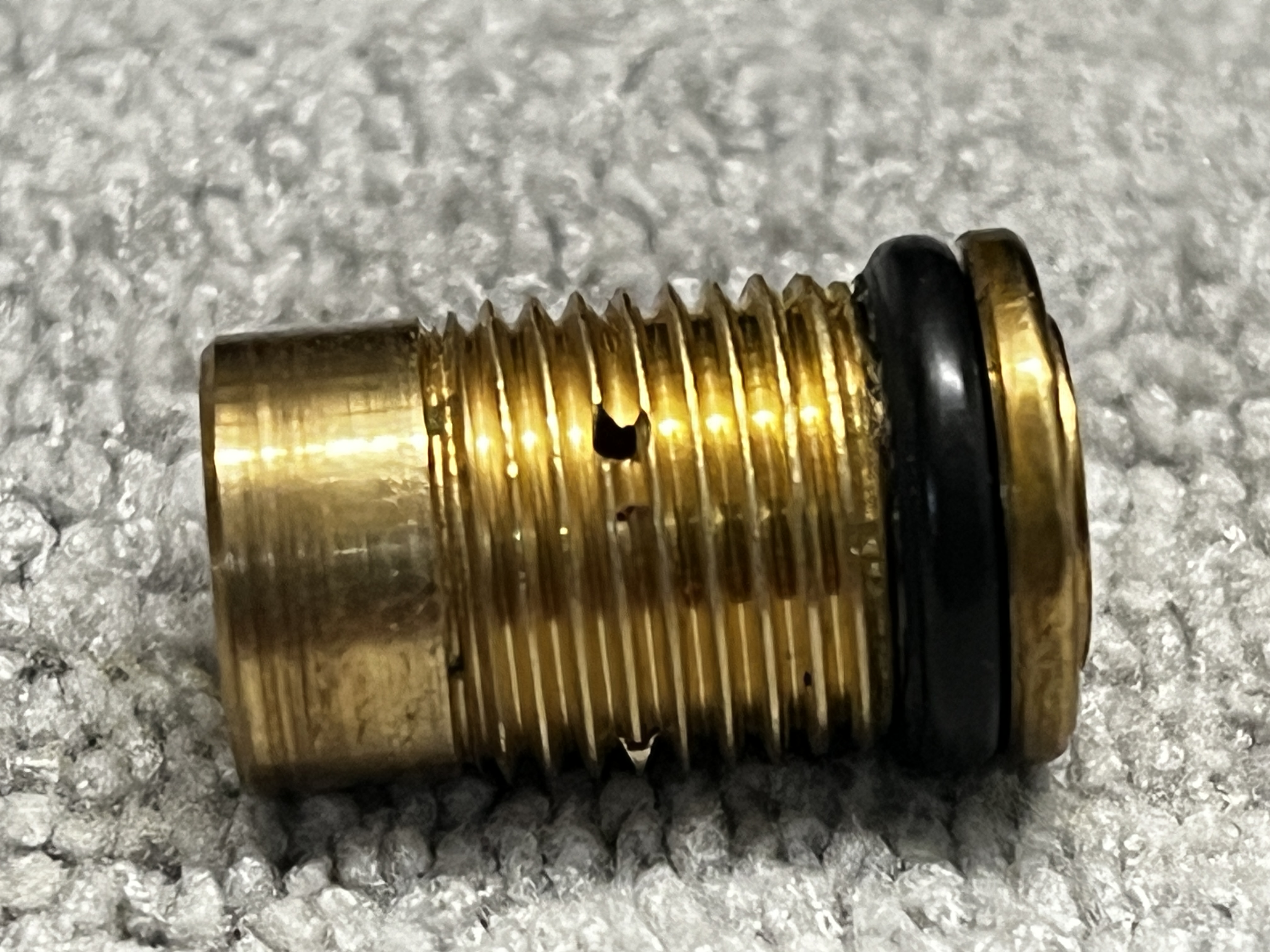

Also brack housing has 4 holes as you see in the threads, all 4 had some magor bur on them, almost half of the hole was blocked on all 4 of them, I cleaned them off and they are perfect now.
