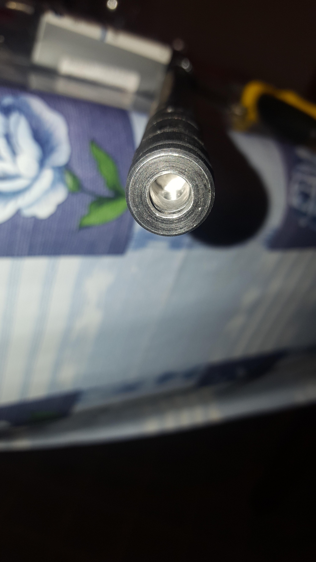

Here a image from my batrel before it full with bures and edges

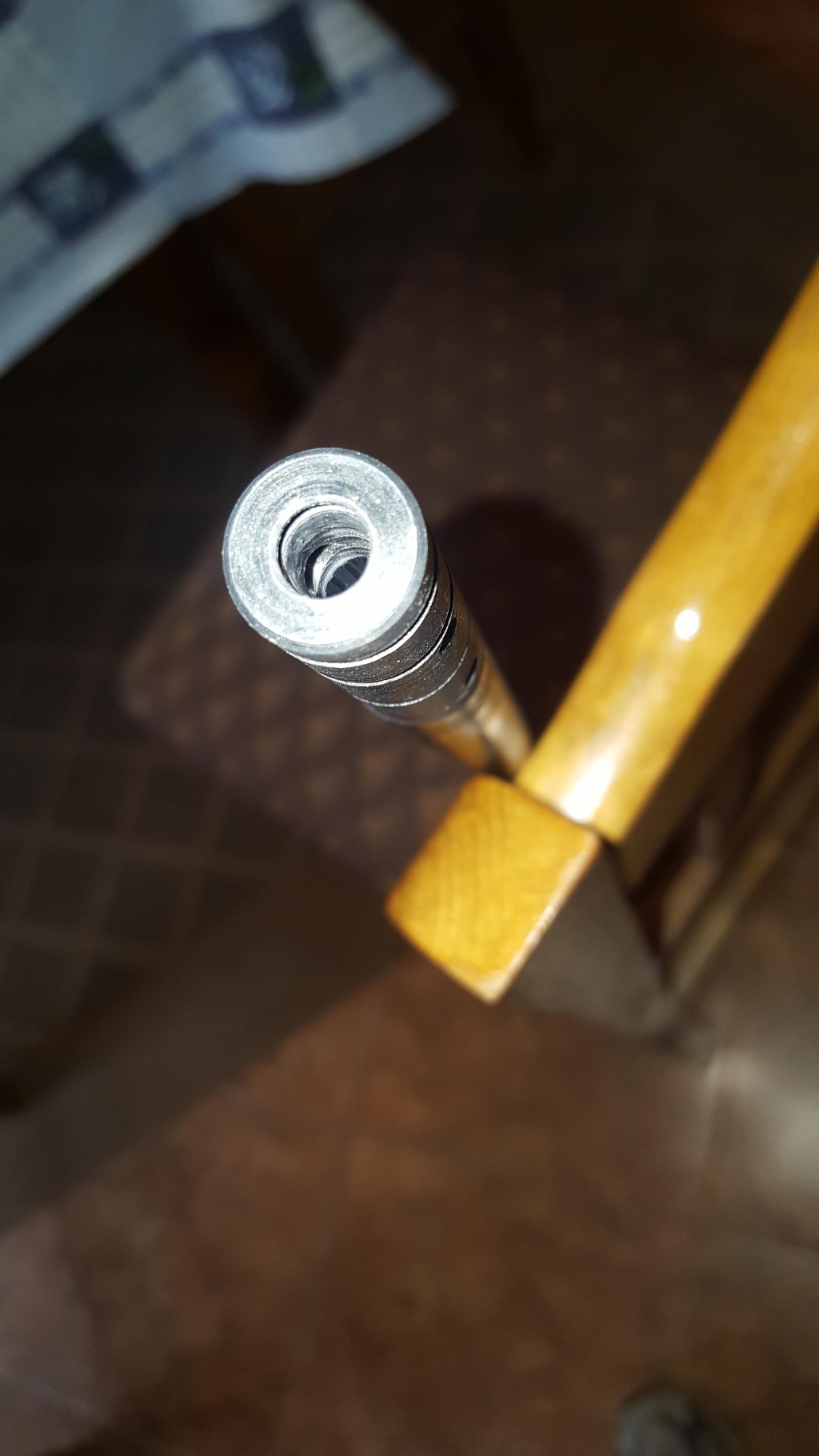

Here after work
Rifling is pluged to save it.
If you must do somthing like that dont use electrik tools
