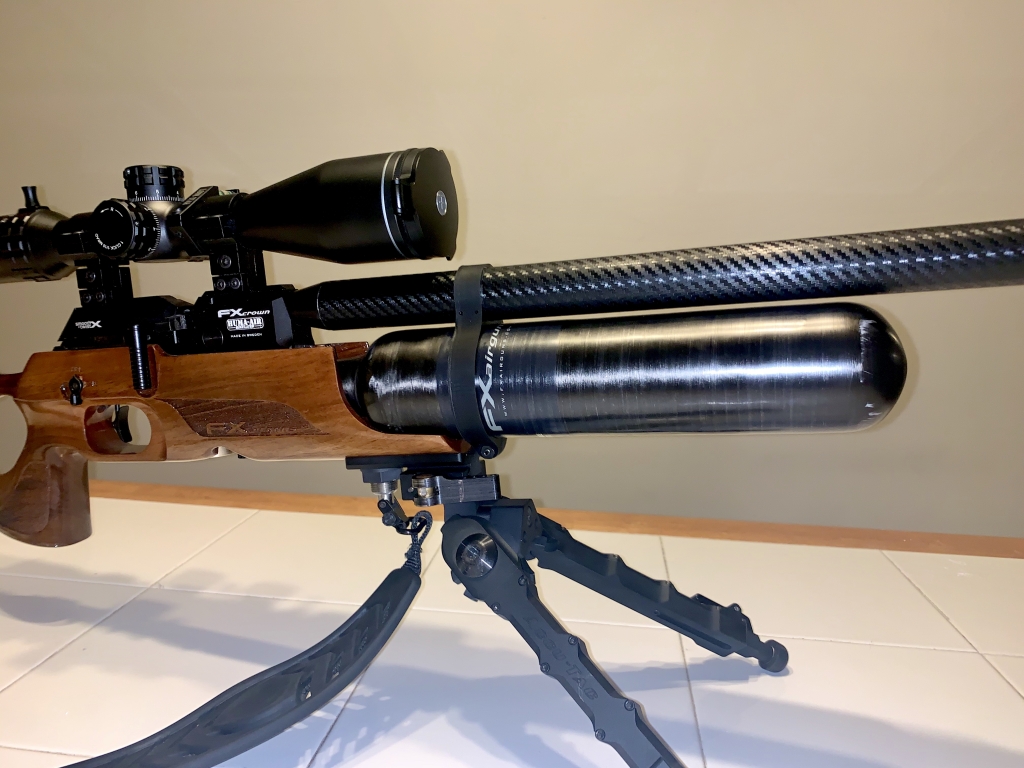

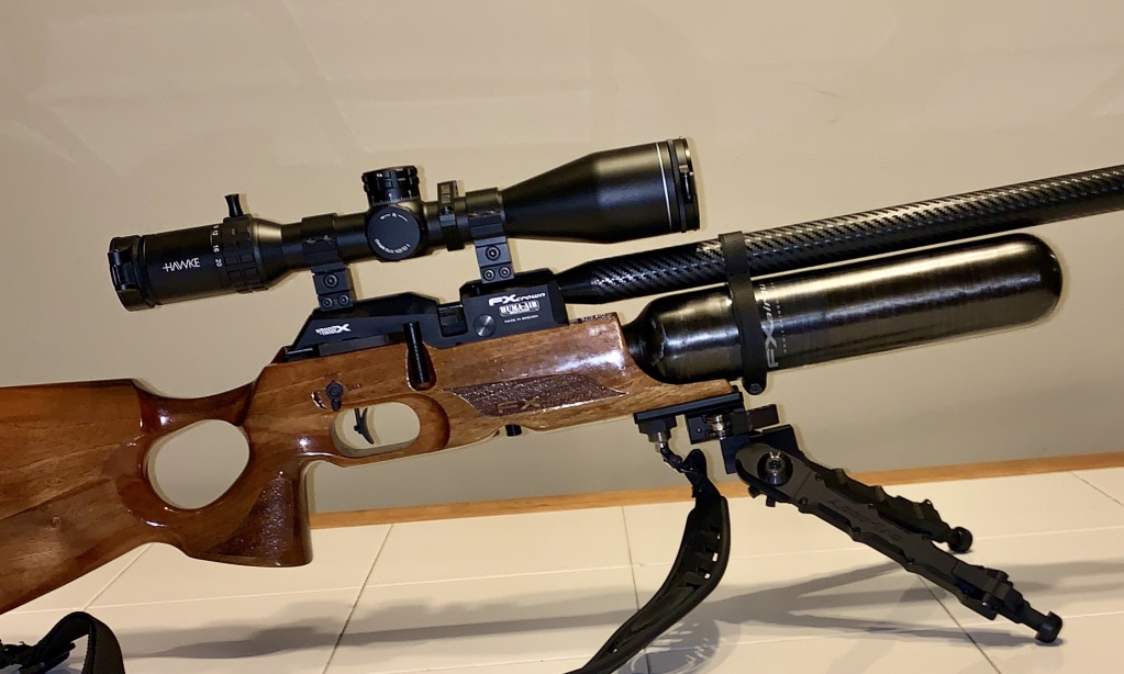

I wanted to add to the info provided above. I bought the same barrel band and fitted it on my .25 cal Crown. Fitment is perfect.
If you like to rest your gun on the bottle for bench shooting, understand that your POI will shift up since there is the slightest bit of flex in the neck of the bottle which is now directly affecting the barrel - they're both connected to one another.
I went ahead and zeroed my rifle by placing the bag on the end of the stock, not the bottle. I accidentally then rested the bottle of the gun on the bag and my POI shifted up as a result. Just something to be aware of.

I haven’t noticed that issue with my particular Crown, but I do see where that may be the case with Crowns and other carbon fiber bottle airguns. My bottle is snugged up pretty dang tight (not so tight preventing removal though). From the bench I tend to use my Accu-Tac bipod which is stock mounted (most of the time), and sand bags (partially). In the field its trigger sticks or some makeshift rest like a tree or post or whatever is available.

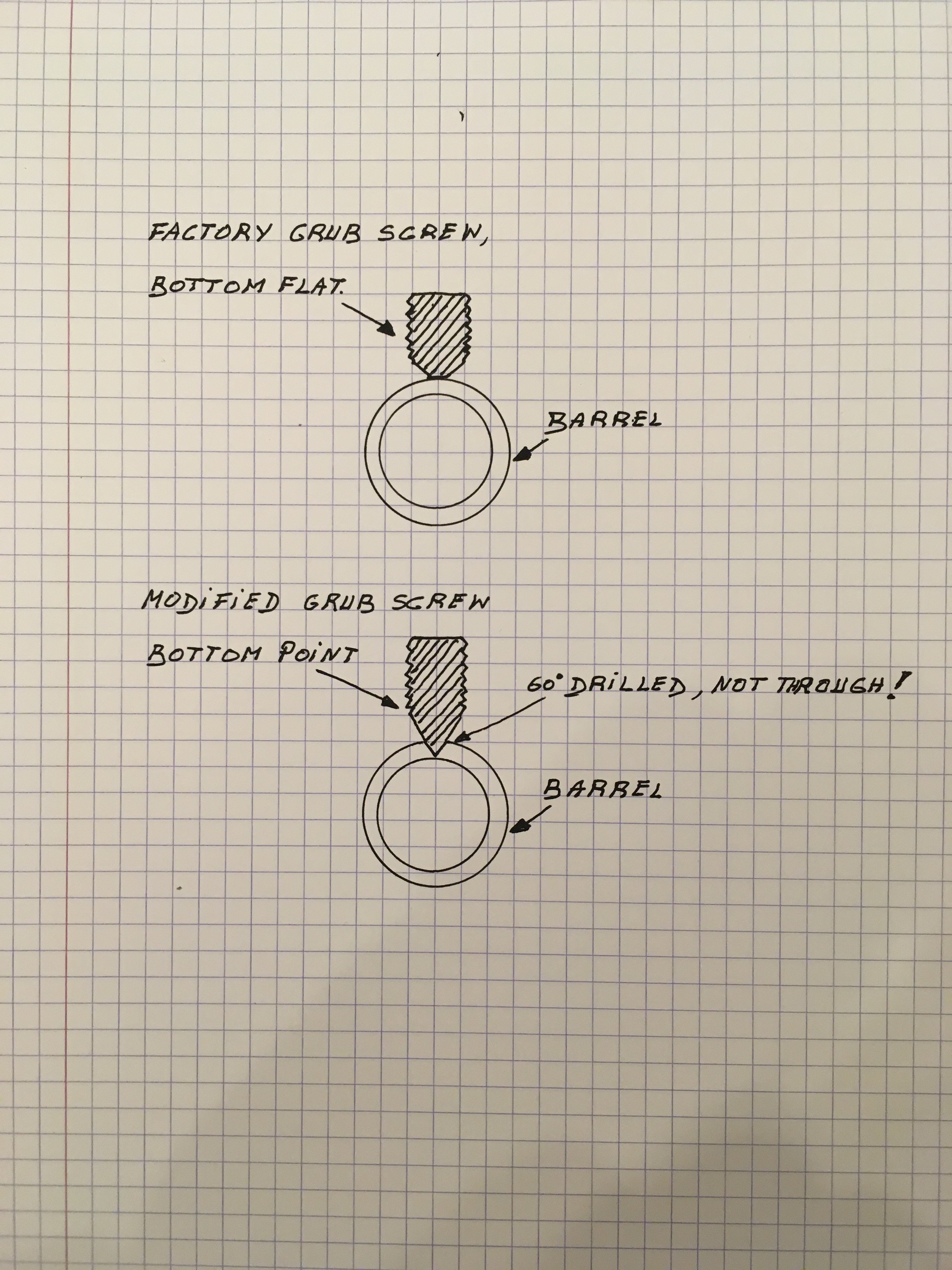

This is a little modification I made today on my Crown . I've never put a lot of trust in the way the FX Crown barrel assembly was kept in place in the action . The 2 grub screws have a rather flat bottom , and the contact surface with the round barrel is , in my opinion , not ideal . So I removed the screws , carefully pointed the center in the barrel and , using a 60° ,2,5mm drill , drilled 2 "dents" in the barrel , about 1mm deep . On my lathe I turned the grub screws to a 60° pointed bottom. In this way , it's impossible for the barrel to rotate or going back and forth. See drawing.
Frankly , I don't know if this modification can improve the gun in a way or another . I'm sure that the FX engineers know what they do , but it was something I wanted to change for a long time .
It's VERY windy today so I didn't shot the gun . I'm just curious to see if this little mod + a barrel band could decrease the POI problems I have with this gun.
Well, in theory, you'll have positive locating and I'm guess, less need for torquing it tightly, distorting the barrel.
