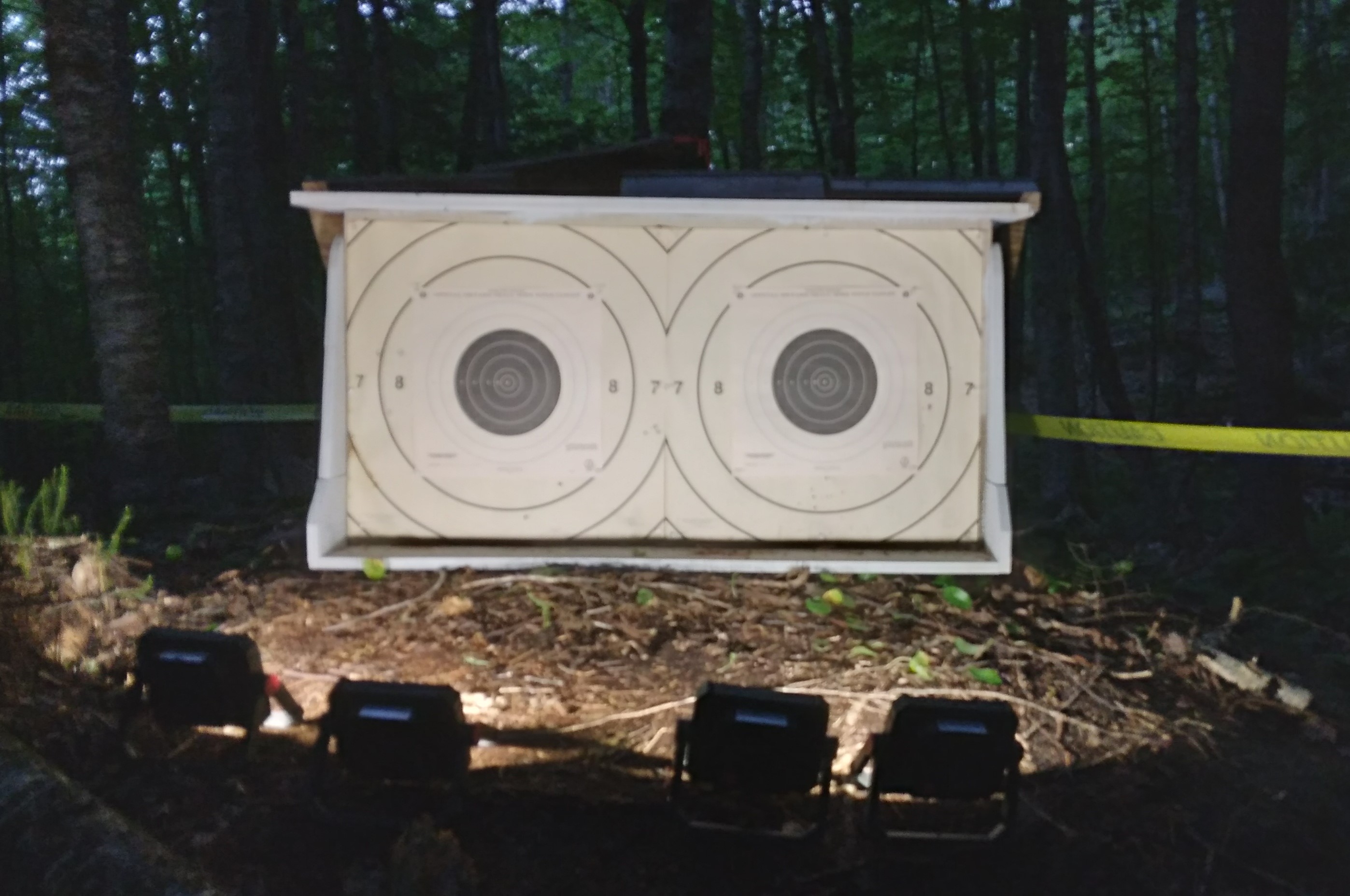

4 of these at medium setting, = 4 x 1000 lumens, 6 hour run time.

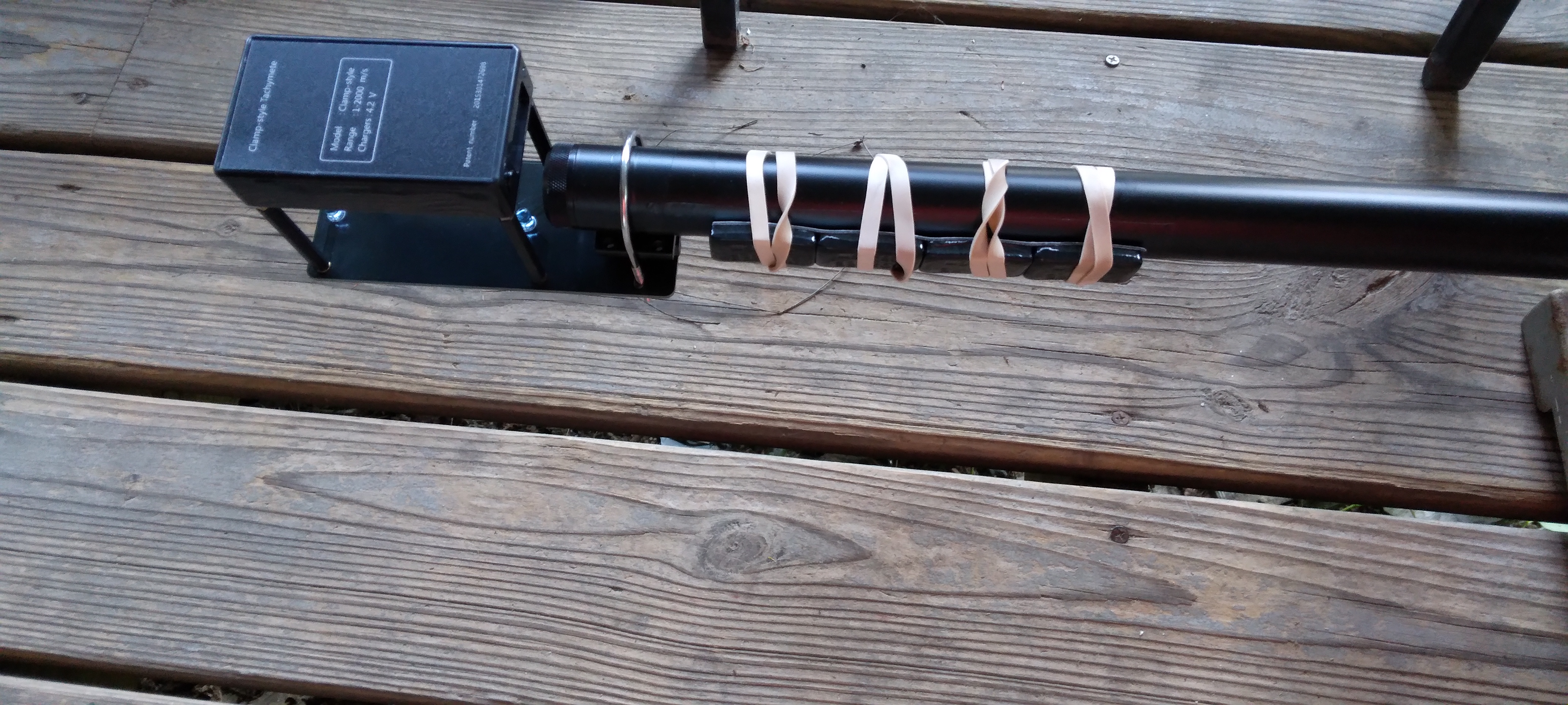

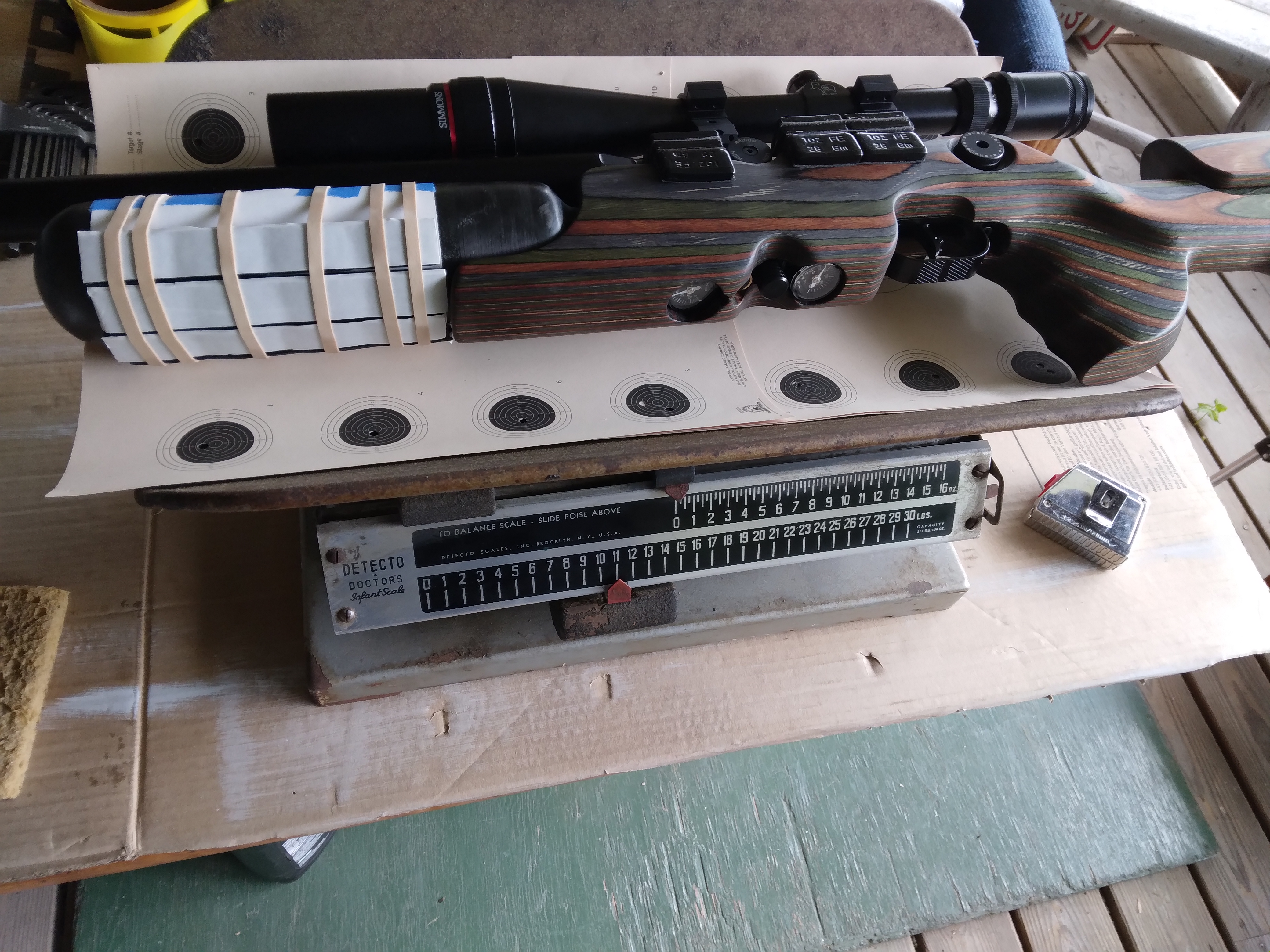

Will try to make this short. Benchrest is sighted in for direct hit, 10x ring. Things change when I shoot Standing, am using a 20x scope , so I occasionally see it all happen. When trigger is released, the muzzle goes up approx 1 to 2 o'clock, then drops back down to 7 or 8 o'clock. My actual shot grouping is at 7 to 8 o'clock. So I am concluding that the slug is in the barrel until the barrel is in the downward movement. Am trying to shoot as low velocity as possible to get this task done, thus keeping this muzzle movement to its minimum. And at the same time, weighting the rifle , to also limit this muzzle movement as much as possible. This last test proved of adding 1 pound to be a big game changer, the 2 tight 8 oclock shots near the ten were perfectly executed. I would like to add this weight up front in a better manner.View attachment 363274View attachment 363275
maybe temporary to play with the weight would be lead wire (plumber solder ,about a 1/4 inch dia. ) so you cam move weight closer or farther on the barrel ??

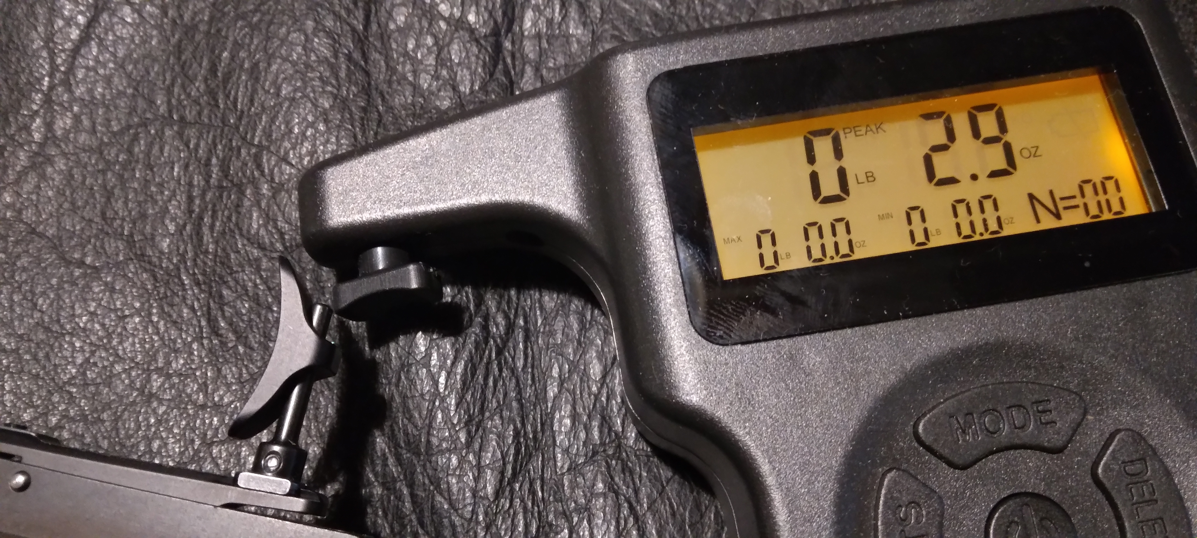

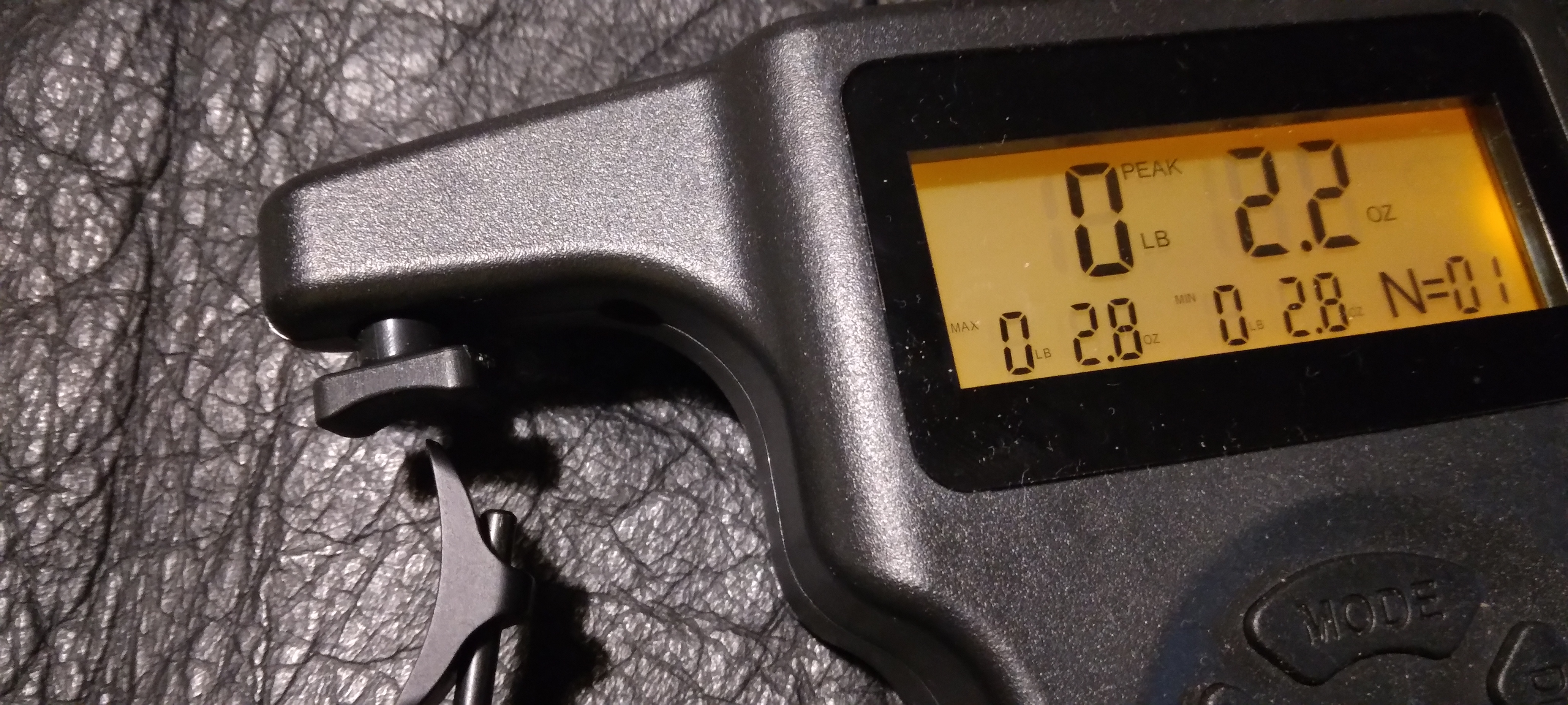

So do to this higher hammer spring setting for the higher pressures, my light stock trigger setting for 110 bar and 130 bar could not hold the sear. Perfect time for the Boss trigger kit install
and very pleased with the results. The Boss trigger is still light and holds well at higher bar pressure 140, and 150 bar.
Dremel work is fun!
