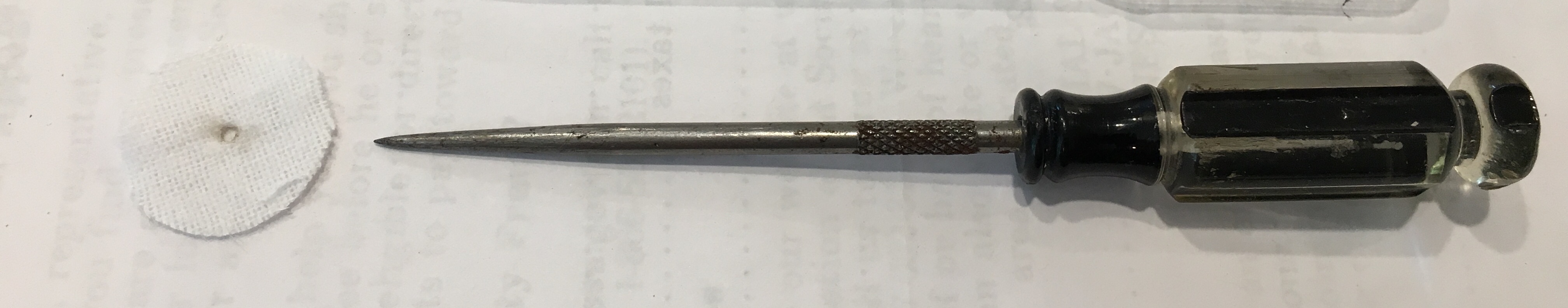

Definitely watch AEAC’s video before Patch Worming. He has some very good advice on not getting Ballistol where you don’t want it to go. You will most likely also need a McDonalds tubular coffee stir to stick in the muzzle to aid the Patch Worm in exiting the barrel. You’ll understand why the first time you thread the Patch Worm in the rifle. Make sure you remove the moderator first if you have one. Order extra Patch Worm patches too, you’ll eventually need more. And use a sharp scratch awl to make just a bit of a starter hole to get the pointy end of the Patch Worm started through it.
