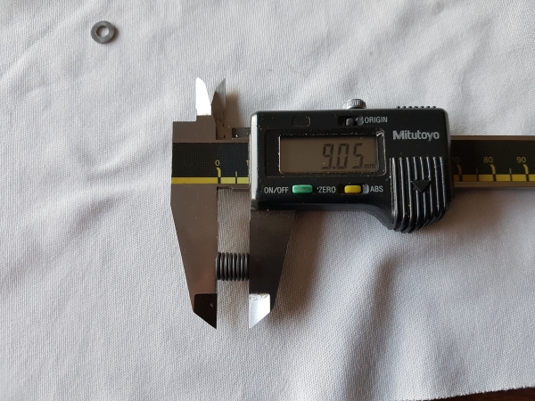

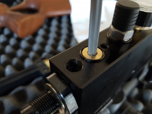

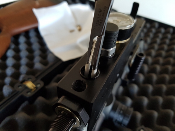

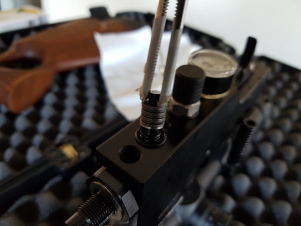

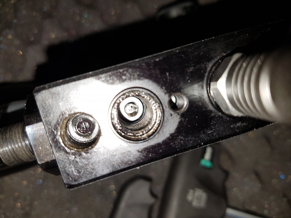

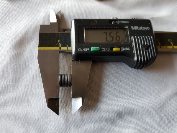

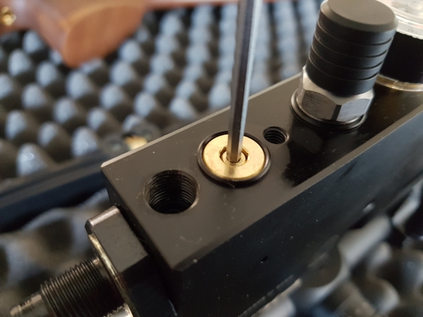

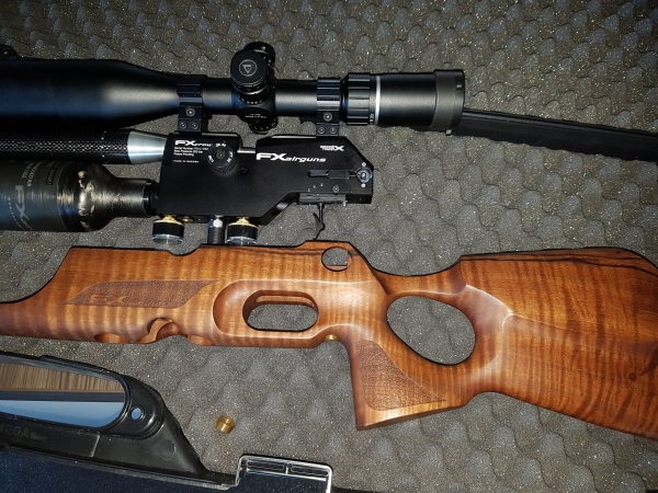

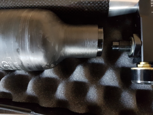

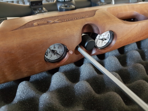

On my impact x 25 Cal there is only 11 bv washer. Is that correct or am I missing some. I'm guessing new impact has only 11? I'm sure I didn't drop any when I took it out.
You'll likely have the latest regulator, it is a bit different in size compared to the previous models. The newer regulators have thicker/bigger BV washers, and can handle a wider pressure range.
People who know me never would have thought, but my Impact X regulator is still stock
I just never felt the need to take it apart, it works flawless. (Just about all regulators will creep ever so slightly over time)
I bought my impact like a month ago. I believe it's the one with the amp reg. But even with the new reg it creeps overnight. I usually just dry fire 1-2 to get it back to normal. I give this mod a try, just use the 11 bv washers that was in it. Didnt have any flat washer, so just double stack the bv washes. Will see if it holds tomorrow.
Creeps how much?
