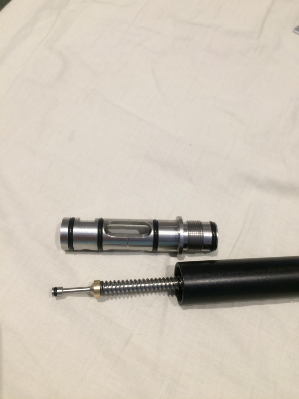

I tried this setup on my Impact x but there was no power at all above 60 bar. It wasn’t even firing the pellet out the barrel and I was getting a slight air noise at the back of the rifle near the magazine area. I’ve changed beck to to 16 Belleville washer setup and the same is happening with this setup now but at anything after 110 bar. Does anybody know what can be cause if this? It must be a problem with my rifle but I don’t know what’s not allowing it to work at higher pressures? Thanks James
Also isn’t there meant to be something between the brass part? If anyone has any pics of there impact x valve rod to compare that would be greatthanks
