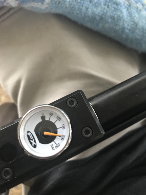

Well guys. I messed up :(. Max powahhh!!!! Well good news is I found out for you guys that max power for the impact .30 700mm in 44 g is 917-920 fps (85-90fpe with 55 gr.) At 165 bar regulator pressure. Any higher than that and the fps actually goes down due to the hammer spring not being strong enough to smack the valve open. Does anyone know how to mod the hammer spring? I think matt knows how to on southafrica airgunning. Also this was an accident. I don't know if I did damage to the gun or not but I will be chronological it tomorrow. Looks like nothing wrong though :).
