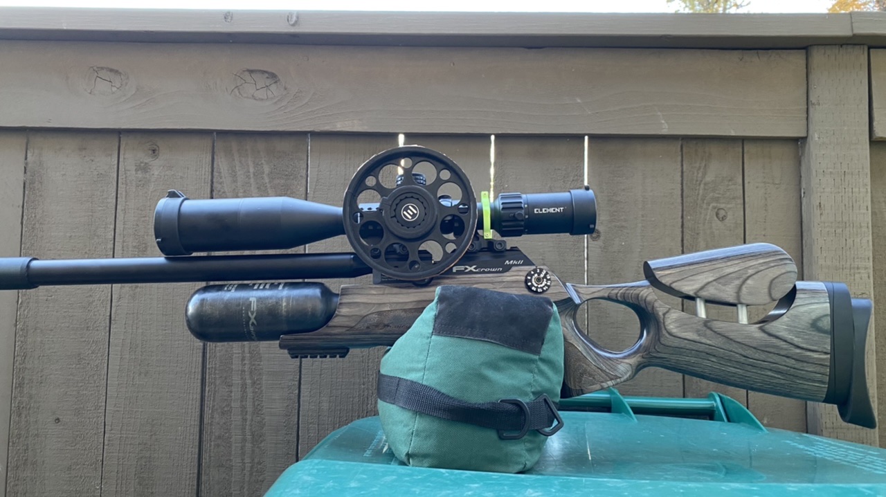

This is my crown with 380mm crown barrel, it’s much fatter and longer…….. at least that’s what she said….
nice rig you got
that black pepper stock looks good i got a new crown today synthetic its a few ounces lighter helps me with off hand shooting even though its only 6 ounces difference
