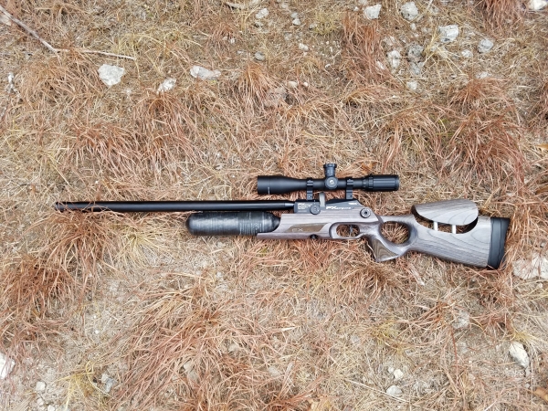

FX Crown in da house!

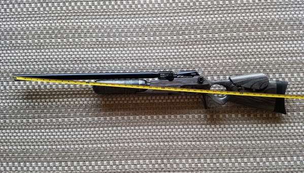

"Menttaliist"Niiice!! Overall lenght?

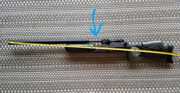

The OAL with the shroud reduced is 43"
Notice I said "reduced" because to my surprise the Crown actually has an extendable shroud! But it's very different from an Impact. The shroud actually extends from the breech & then with a quick turn it locks into place. It increases the OAL to 46.5" & decreases the report quite a bit.

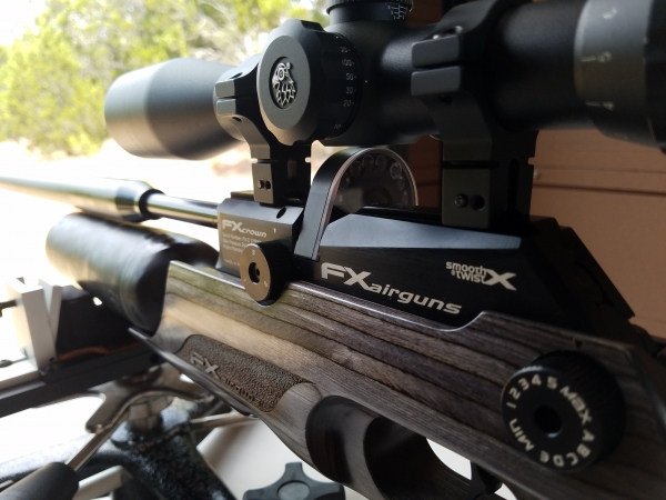

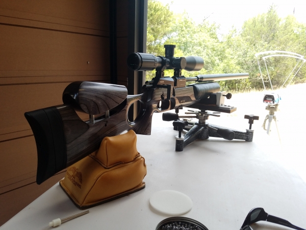

Finally got to shoot the Crown a bit today. But it was HOT. I mean 112 heat index hot! I had sweat dripping from every pore of my body but I was determined to put some lead downrange.

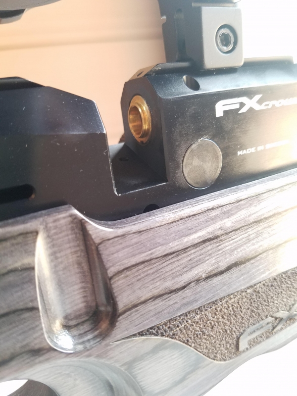

I slapped on an SWFA scope with BLK high rings and the scope only cleared the mag by 1/8". Which could be why the magazine ramp is sloped.

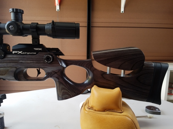

The adjustable cheek riser worked really well.
The action feels very different compared to the Royale series; not quite as smooth, but really solid.

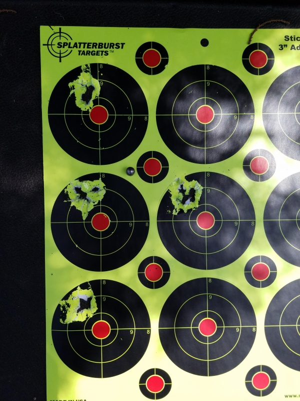

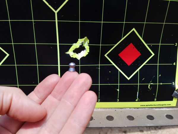

Each group here is a full magazine (16 shots) @ 50 yards. Not bad for our first date.
This was the best 16 shot group
I was shooting .25 kings at 880fps. Which was transfer port 3, power wheel 5. I didn't try any other settings.
