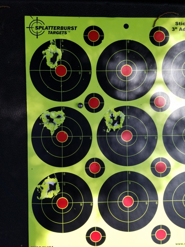

Thanks, I guess the size of the actual hole is subject to speculation. I'd like to make that "hole" a bit smaller."DrippinLead"Wow! To me consistently shooting 16 in one hole at 50 yards is spectacular and about the best I have ever seen. Do some of you guy's out there have guns that perform equally? Way to go Michael!
My Daystate Renegade will do that all day long - it gets a bit worse at 100 yards though."DrippinLead"Wow! To me consistently shooting 16 in one hole at 50 yards is spectacular and about the best I have ever seen. Do some of you guy's out there have guns that perform equally? Way to go Michael!

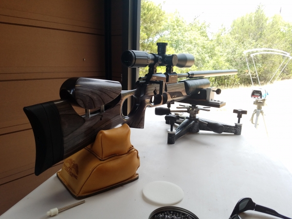

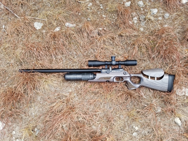

"Michael"Finally got to shoot the Crown a bit today. But it was HOT. I mean 112 heat index hot! I had sweat dripping from every pore of my body but I was determined to put some lead downrange.

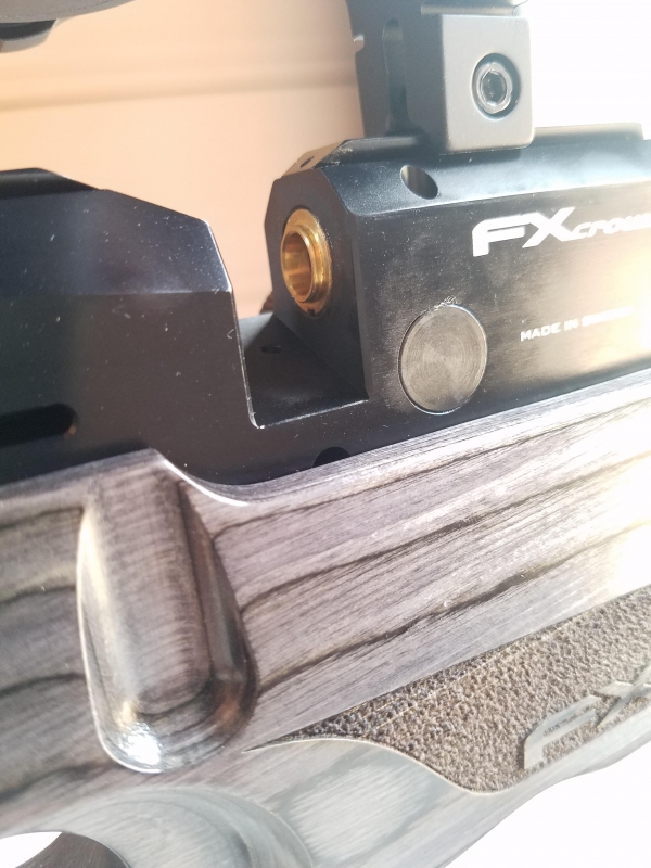

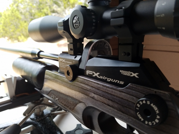

I slapped on an SWFA scope with BLK high rings and the scope only cleared the mag by 1/8". Which could be why the magazine ramp is sloped.

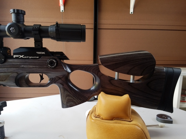

The adjustable cheek riser worked really well.
The action feels very different compared to the Royale series; not quite as smooth, but really solid.

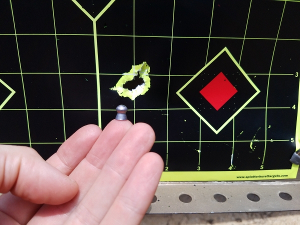

Each group here is a full magazine (16 shots) @ 50 yards. Not bad for our first date.
This was the best 16 shot group
I was shooting .25 kings at 880fps. Which was transfer port 3, power wheel 5. I didn't try any other settings.
Michael, what is the barrel/scope center to center? How hard was it to see through the scope without raising the cheek rest?
