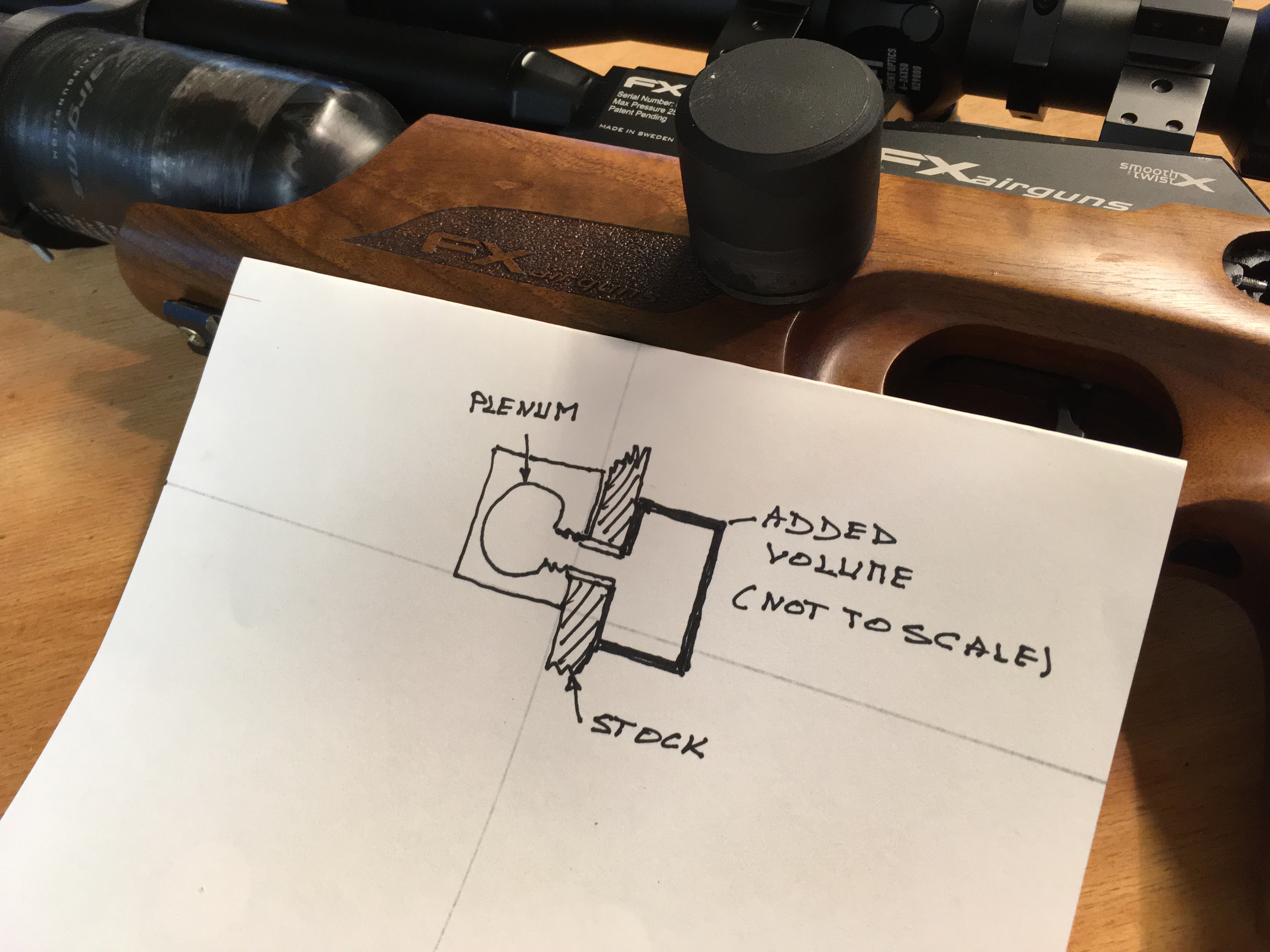

That's great ; I've a shop very well equiped and I think that , with careful measurements and patience , i'll do it.You can replace the plug with an expanded chamber/plug which will increase the plenum size and do have affect on the power, not huge but there is a bump in power especially with MK1. BUT you will have to drill out that section of the stock as it blocks the area for the plug/plenum, if you are handy and have the right tools it's easy.

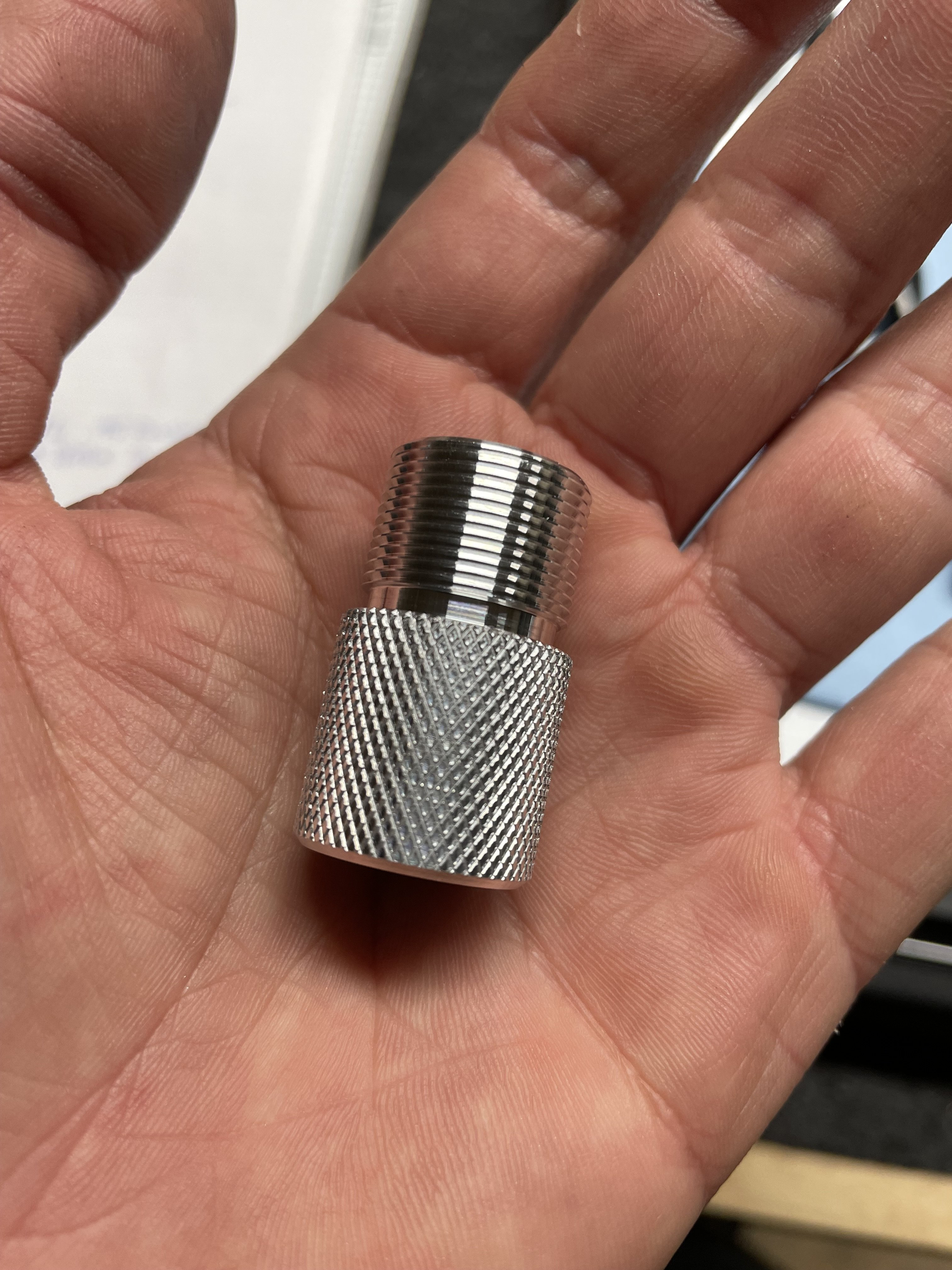

AGN member @cfs916 makes a beautiful plenum for the crown, I just don't have the gusts to drill my stock! If you are willing to drill/modify your stock then reach out to @cfs916.

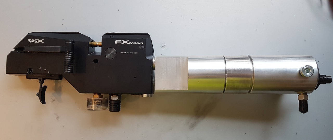

I clicked the link and saw the Crown MK2 main block, but no explanation was given as to this being a swap out for the MK1 block. I'm guessing this won't fit a MK1 rifle?This should work,
Main block Crown Picatinny
<p>You can order the main block with your rifle's serial number engraved on it upon request. This personalized service costs 30€, payable via gift cards.</p>europeairguns.com
