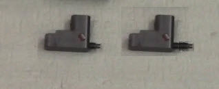

2 turns clockwise as shown in the picture above at a time to increase hammer spring tension right?
But after doing this 2 turns at a time, steady increasing velocities it stops, I increase regulator pressure.
Ensure speed goes up.
But at 110 bar, velocities at 705fps, I can not increase hammer spring tension any more. I am maxed out.
The adjuster screw is all the way out. Example picture. On the left is my zero, and to the right is where I end up.

In your pictures above, both adjusters are screwed out more than “factory”. I’d say screw it back in until just the dome (no threads) are showing. Then screw in 2 to 3 turns out - that’s about factory.
Set your reg back to 135-140 bar. That is the factory delivered setting for a FAC Crown .22.
Hammer spring adjuster wheel about mid-way (13).
Transfer port on medium. (Don’t need high for .22 - High may actually slightly decrease velocity).
