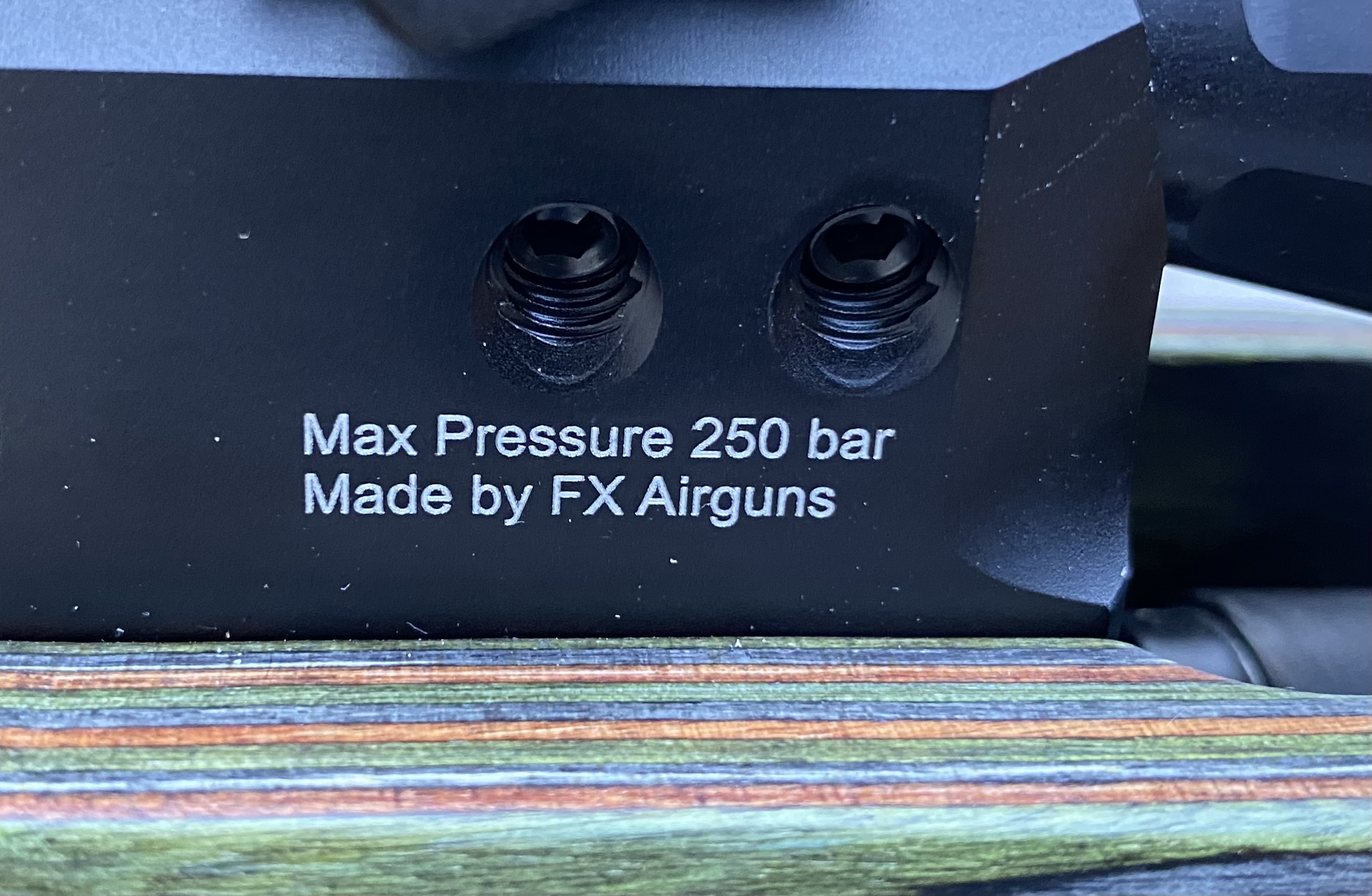

What’s the max pressure on FX Crown MK2 (grs if that matters) ?
Seems pretty simple, fill to 250 Bar max, that is what the gun wants. Don't care if the bottle is capable of a billion Bar, don't care if the gauge goes up to 2 billion Bar, the gun is marked by the manufacturer to be filled to a Max of 250 bar. Fill to 250 Bar max.

I RTFM, show me the line with 250 pls
I know, I was surprised I could not find it in the owner's manual either. I think that is a mistake on FX's part, it should give that specific info in the manual. But the receiver of the gun is clearly marked so that is what you should reference in my opinion.

Will increasing the bottle rated capacity change what the gun is designed for? No, That's your answer. It's literally etched on the gun.

I guess the manuals vary. The manual for my Impact M3, for example, very clearly states on page 9 that the “Maximum overall pressure in System: 300 Bar”. It also states “Max air reservoir pressure: See markings on air reservoir.” However, like others have noted above, the manual for the Crown MK II does not mention fill pressures anywhere. In fact the only mention of a specific pressure i could find anywhere was the warning not to set the regulator above 160 Bar.
