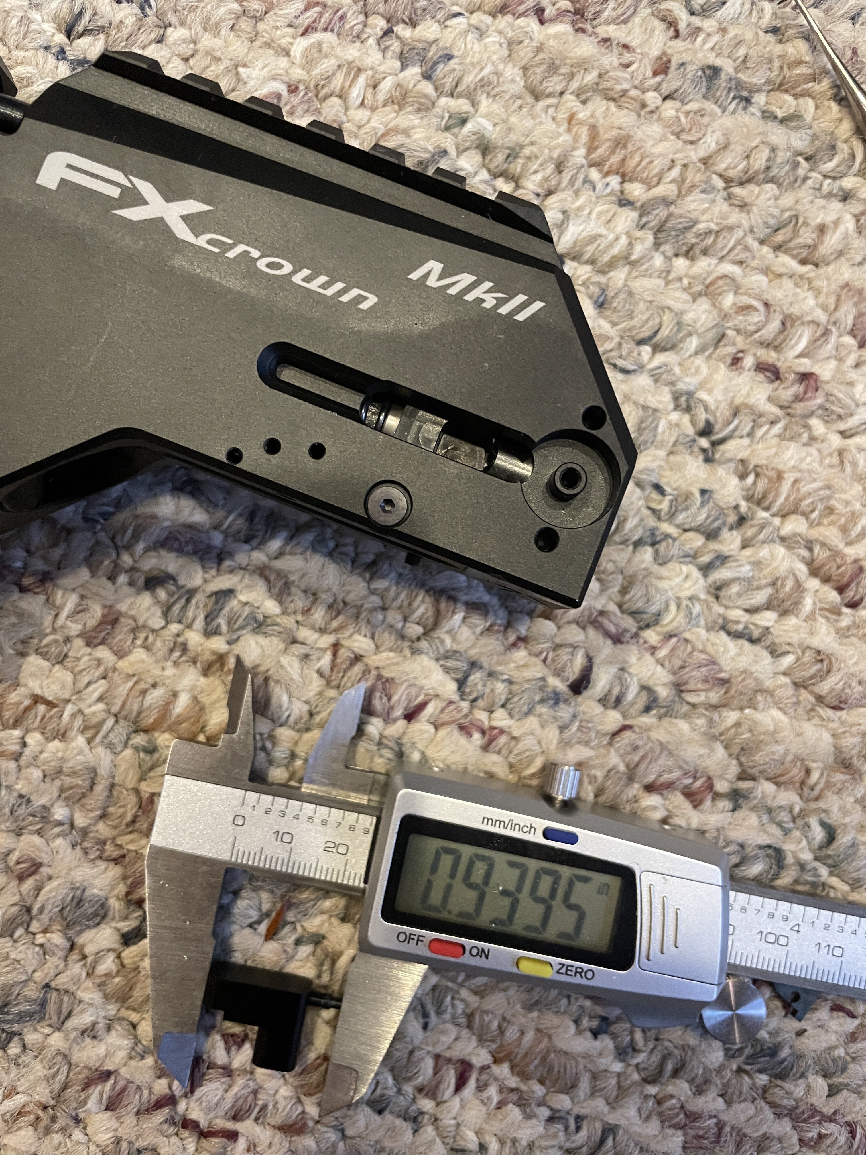

I have your EXACT setup: FX Crown Mk2 .25 with 600mm superlight barrel. Here is some EXACT baseline data that may help you set up your Crowns:
Reg pressure: 140 bar on gauge
Hammer Adjuster total length: 0.9395 inches
Power Wheel on 9
Transfer Port Adjuster on Medium
Gives 878fps with 43F temperature using 25.4g
I set up the rifle (internal adjuster) so that I was getting 880fps at a lower setting on the power wheel with 25.4g so that I had “headroom” on the wheel to shoot 30 and 34g pellets. (I LOVE the 25.4g .25 pellet for accuracy).
So now you have details on the hammer adjustment to 1/10,000 of an inch for your EXACT rifle… so get out your Allen keys, take the rifle apart and GET TO IT, lol.
Hope this helps and Good luck,
-Ed

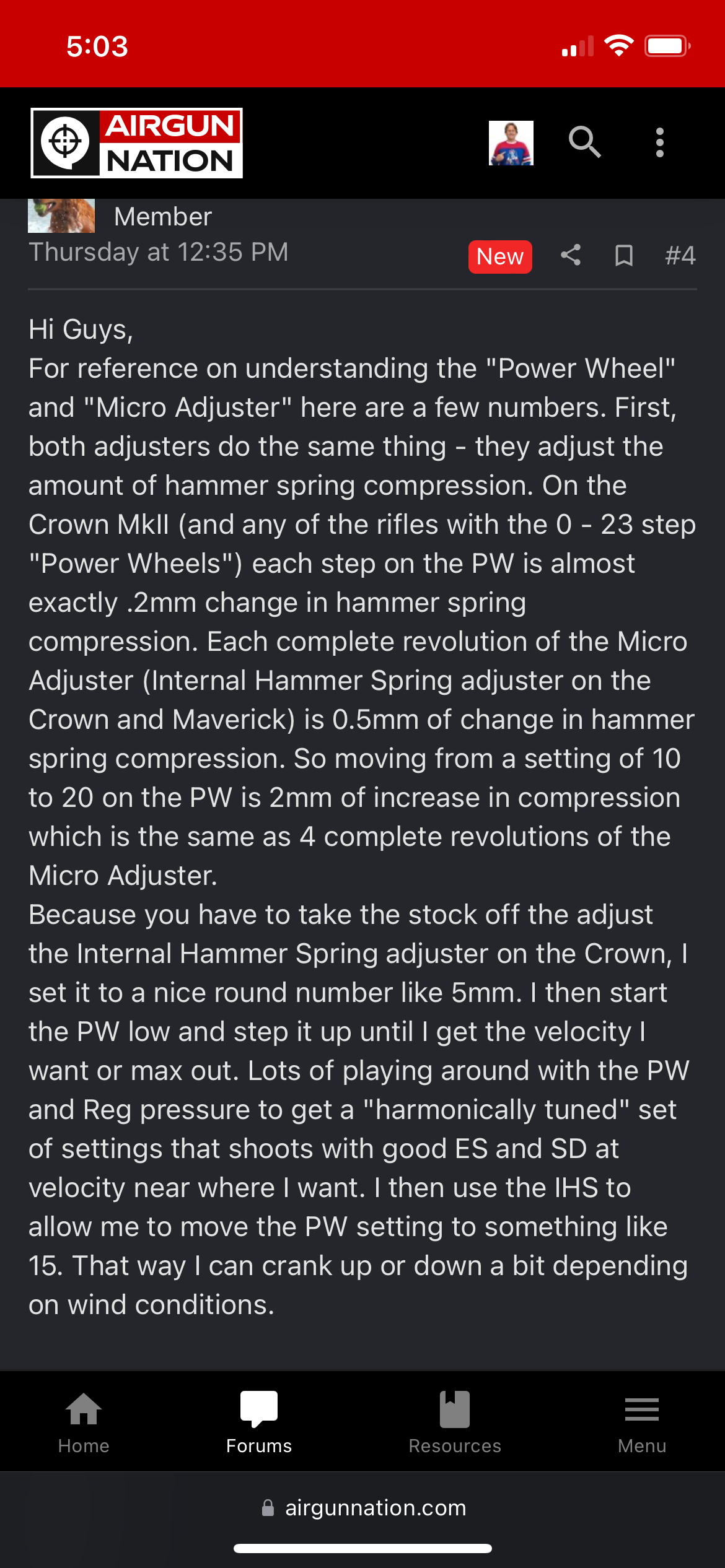

An extra bit of info applicable to both the Crown and Maverick hammer spring adjusters - courtesy of NAProf (Greg) who is our “super tech engineer” in the 30 & 40 yard shooting Challenges here on AGN.
Summary of Greg’s findings:
Each full turn of the INTERNAL adjuster results in .5mm compression of the hammer spring.
Each click of the power wheel (23 numbers power wheel) results in .2mm hammer spring compression.
So you can see that the internal adjuster needs to be set to accommodate the pellet weight/velocity you desire… and the power wheel can then be used to fine tune velocity.
Hope this helps you understanding of how hammer spring preload can be effects managed on the FX Crown Mk2.

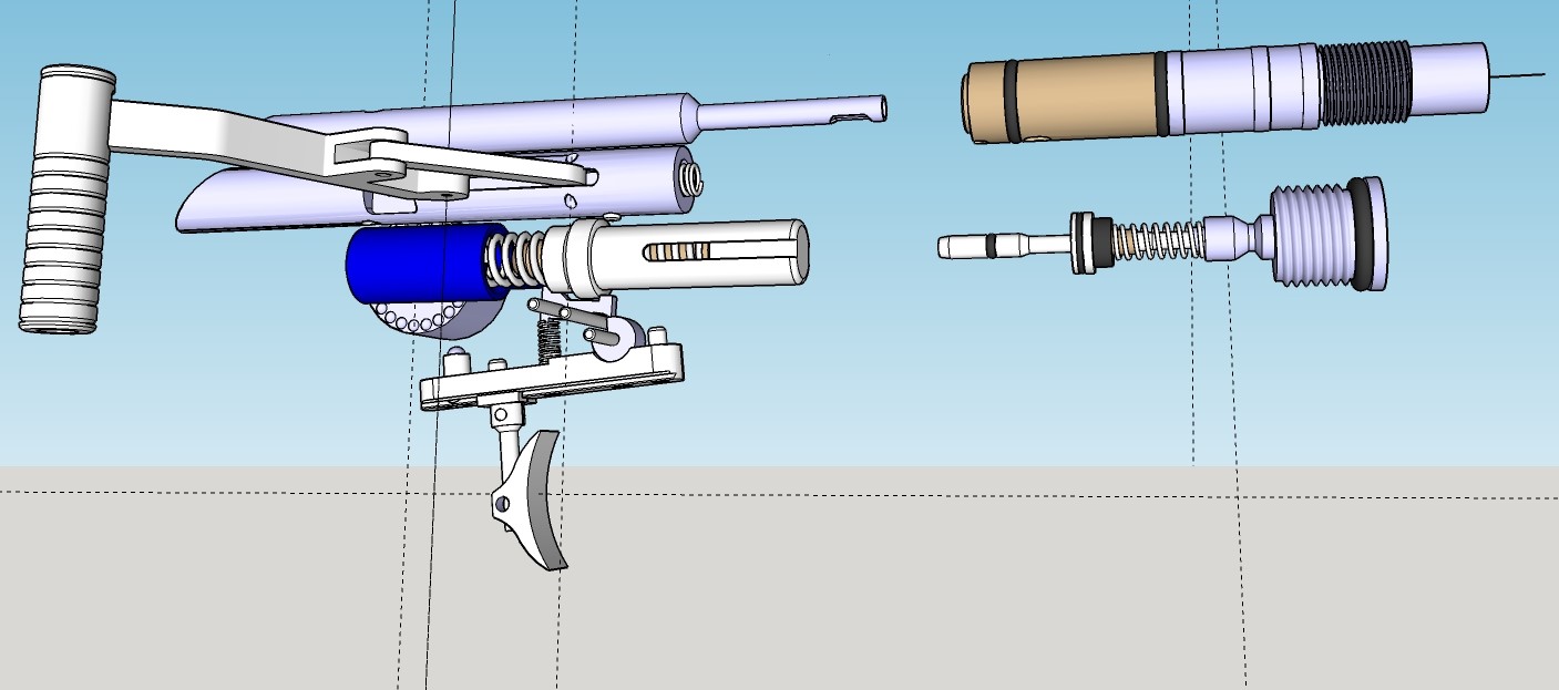

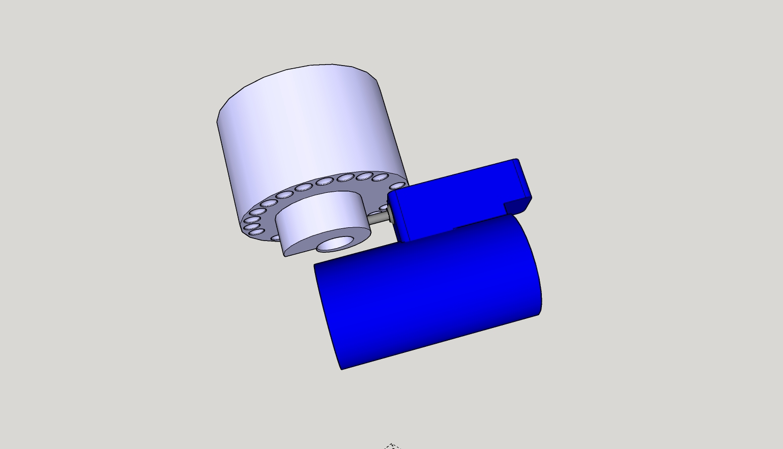

The only point that Ed makes that may need clarification is the measurement of the "Hammer Adjuster" length. Perhaps I can provide a couple of views from my Sketchup CAD model of the crown action to help you see what Ed is measuring.
Below are two images taken from my 3D model. The first shows the mechanical parts of the Crown Mk II action from the right side. The piece in blue is the Spring Carrier. Inside that is the Hammer Spring and inside that is the Additional Hammer Weight. The spring and the weight slide into the actual hammer. The image shows how the trigger sear holds the hammer when the rifle is cocked. The image is of the rifle cocked with the breech open. This image gives you an idea of the positions of all the components inside the block.

This next image has all of the components stripped away except for the Spring Carrier (blue cylinder), the Hammer Adjuster (blue piece attached to the Spring carrier), the Internal Hammer Adjuster (IHS) screw (short gray piece sticking out of the hammer adjuster), and the Power Wheel.
My interpretation of what Ed is measuring (correct me if I am mistaken Ed) is the length of the Hammer Adjuster plus the amount of the IHS that is sticking out of the Hammer Adjuster. You can change that length using a 1.5mm hex from the barrel end of the Hammer Adjuster. one turn of the IHS moves the tip of the IHS 0.5mm. That is effectively how much you are changing the length of the compressed hammer spring. Of note is that each click of the Power Wheel changes the length of the compressed spring almost exactly 0.2mm.

I hope you have found my pictures and explaination useful. I love shooting my Crowns and believe that are terrific, beautiful rifles that can also be amazingly accurate.
Cheers,
Greg
